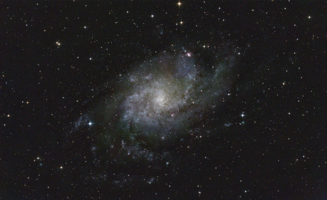

Especially since the introduction of SPCC colour calibration into PixInsight I have given up using colour noise reduction tools to remove green pixels from images -- because it ought to be unnecessary and will only alter the colour balance. However I observe from a suburban site with considerable light pollution from LED streetlamps and house lights etc so there are always gradients to remove first. The gradient correction tool and DBE etc appear to do a pretty good job and any remaining problem areas around the periphery can be cropped away. In side by side comparisons starting from the same data - otherwise processed the same way - SPCC appears to do a better job than the old Colour calibration tool - or at least I can see a difference where I assume that the SPCC result is nearer 'the truth'. However what is colour rendition truth and how would you know it if you saw it ? Below is my SPCC calibrated image of M33 ( PDS200 scope, ASI294 MC OSC, 100 x 66s subs at unity gain) - data collected from > 50 deg elevation on a moonless night from a ~ B6 suburban sky. Now to my eyes parts of the galaxy appear to have quite a green tint. In the old days I would have SCNR'd that tint away -- but now I am hesitant to do so because actually perhaps this rendition of the colour of M33 is correct? So I wonder if the green is an artifact arising perhaps from my inability to really properly remove background gradients or if it is simply reality and that it is simply wrong to think that there should be no green tints ? Would the final colour balance have looked different using data from a dark sky site for example? Grateful for any comments on this ..  |

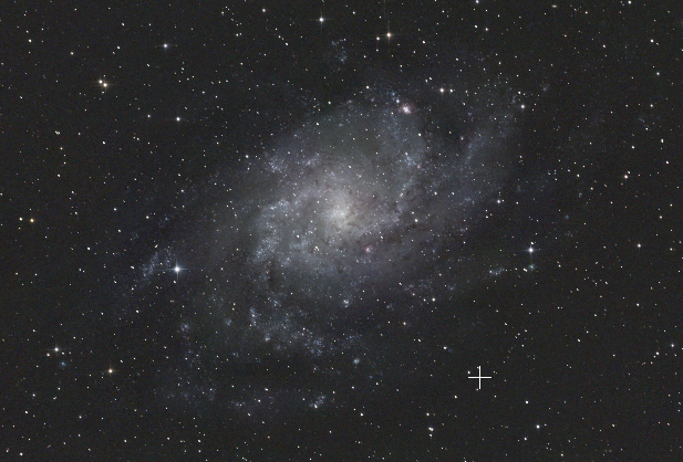

It is most definitely due to processing, most likely flat fielding after calibration. You can check out my example from similar skies (possibly a tad worse) and similar equipment (camera, scope).
andrea tasselli: It is most definitely due to processing, most likely flat fielding after calibration. You can check out my example from similar skies (possibly a tad worse) and similar equipment (camera, scope). Hi Andrea. What is flat fielding.? Just for info - Following calibration the steps were cosmetic calibration (using the master dark), VNG debayer, registration, integration and finally a 1X drizzle integration. The debayered and 1X CFA integrations looked very similar to each other before and after background removal and colour calibration. . Following integration the steps were simply gradient correction (2x simplified model) and dynamic background extraction before colour calibration with SPCC . After that the colours didn't shift at all (for example after BXT sharpening and histogram transformation) . My picture shows it after stretching (obviously). But the colours - and the greenish caste of parts of the galaxy - looked basically the same whatever the stretch. There are lots of pictures of M33 on astrobin that don't show any greenish hue --and a few that do. The question really is how can anyone know which is objectively correct? PS I have just twigged what you meant Andrea --- yes I had assumed that my flat was good -- but maybe it wasn't for some reason? Yes that could be right -- Flatfields Mar11.indd |
andrea tasselli: It is most definitely due to processing, most likely flat fielding after calibration. You can check out my example from similar skies (possibly a tad worse) and similar equipment (camera, scope). Hi Andrea again, As I think about it more your answer may have unearthed something that I have been doing that is fundamentally wrong? I have been using a single greyscale master flat which is applied to all 3 colour OSC channels during calibration and using sky (which can be biased to blue) flats diffused using a flat white cloth. So maybe it is time to use separate flats for R, G and B during calibration? Anyway I will experiment varying the flat to see what effect it has on the colour cast - thanks for stimulating this notion Tim

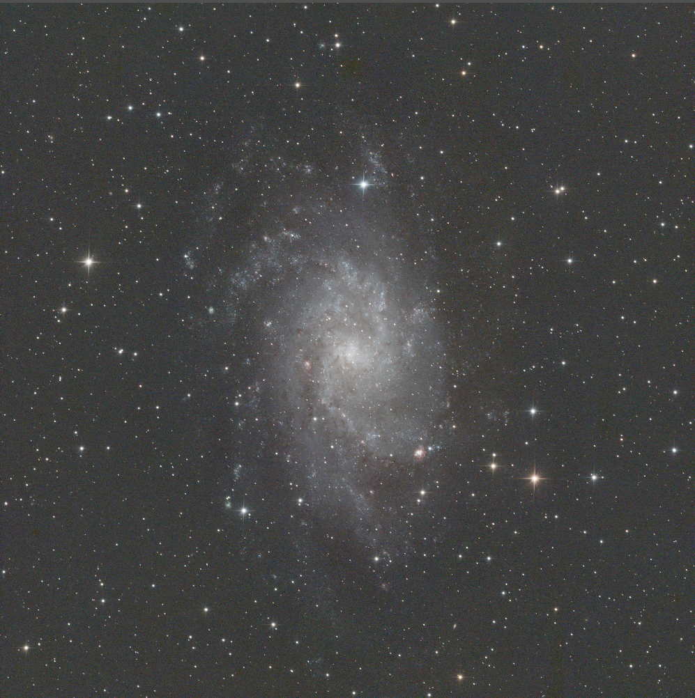

Once you select "separate CFA color scaling factors" in the calibration menu you are all set. This doesn't however say anything about how the application of the flat field and the resultant residual color gradient are removed with DBE, which is quite tricky to get with subject like M33. So, probably the best way to assess the issue is to look at the calibrated but otherwise unprocessed master light.
Here is a stretched and flat-fielded (DBE applied) and SPCC calibrated image:  |

Of course there is, it is in the CFA array. As long as you use the gray-scale (un-debayered) master flat everything is fine, with the provision mentioned in my previous message about using the different scaling factors for the flat division operation. Hi Andrea, your suggestion made a significant difference so thanks very much for providing the right answer!  It is a lot better separating out the separate colour flats. The sky was rather blue when I made this particular master flat rather than white/ grey cloud aand so maybe the colour distorting effect of 'doing it wrong' more obvious than usual. Anyway I have learned something and have a better image - in fact quite good - so thanks again Andrea

Alex Nicholas: Depending on the software you use, if you're using a colour camera, the master flat frame will not be debayered, and as such, it will be applied to your light frame prior to debayering, thus, 0 effect on colour balance Thanks Alex. You are right. The whole thread was an error in fact because the green cast in my original image turned out in the end to be because I had just made a mistake somewhere in preprocessing. It was just coincidence that the cast improved following Andreas suggestion since further experiments revealed that splitting out the flat channels made no difference in the end to the final image colour obtained post colour calibration. Which is what you would expect. However it was useful that Andrea pointed out the possibility of separating out the master flat into channels - an option that is actually the default in Pix Insight because it pointed me in the right direction to learn more about the topic ...and find the relvant discussions on Cloudy nights and on the PixInsight forum cf PixInsight's Flat field correction with data of OSC cameras | PixInsight ForumTim
