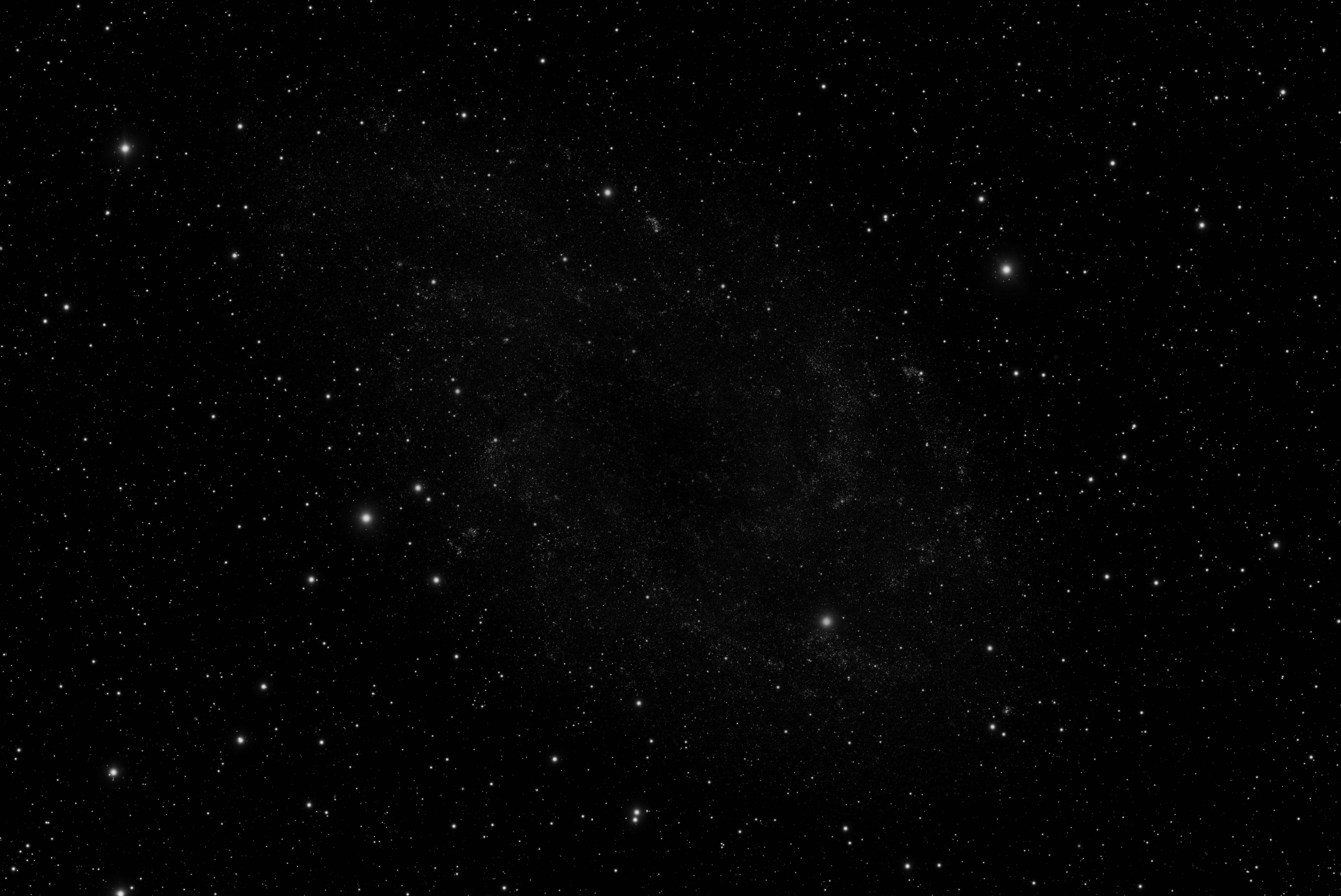

Hello, I am starting acquisition on M33 and my goal is to obtain Ha, O and LRGB data to combine. It will be important to remove the stars, however StarXterminator removes many important features of the galaxy. Has anyone had luck removing stars while processing M33? Also BXT seems to be pretty heavy handed on the galaxy details.
For example here is the stars generated by StarXterminator: masterLight_BIN_1_6248x4176_EXPOSURE_120_00s_FILTER_L_mono_3__integration_stars.jpg
frankz 4.07
M33 is a real challenge for star-removing NN, because we can actually see individual bright stars in the galaxy. But I did have good results by importing in Photoshop the stars and starless (stretched) versions, setting up the layers to show me the differences between the two, and painting a third layer to cover the portions that I believed were features of the galaxy and not foreground stars. Then I imported this layer in PI, converted it to grayscale, and used it as a mask to prevent SXT from removing those features.
Of course it’s highly subjective. And boring, and tedious. But it works. See my M33 at https://www.astrobin.com/0hpqzd/O/
jwillson 3.66
Yeah, with this galaxy I have noticed a few things:
  • StarXTerminator is not as useful as with most subjects. There are simply too many "stars" that are right on the edge of being stars, or being small bits of detail in the galaxy. I would recommend not actually using SXT and just stretch and process the stars and nebulosity together. Note, this does not necessarily apply to H-alpha and OIII data--depends on how you do continuum subtraction before blending back into the LRGB data
  • BlurXTerminator is a disaster on M33 in terms of "worm" creation if you use it for both star correction and enhancing non-stellar detail. I find I need to drop the amount to 0.1 or so on non-stellar details or BXT will try to link up what are probably moderately bright stars right on the edge of being resolved, and this results in an oatmeal like background to the galaxy.
  • BXT does better (introduces fewer artifacts) if you are just a tiny bit heavy handed with NoiseXTerminator when you are still in the linear state. I would normally apply NXT at perhaps 0.3 while still linear in order to avoid artifacts with BXT afterwards, but I find I need a value more like 0.5 on NXT to keep the artifacts from appearing in the BXT step.
