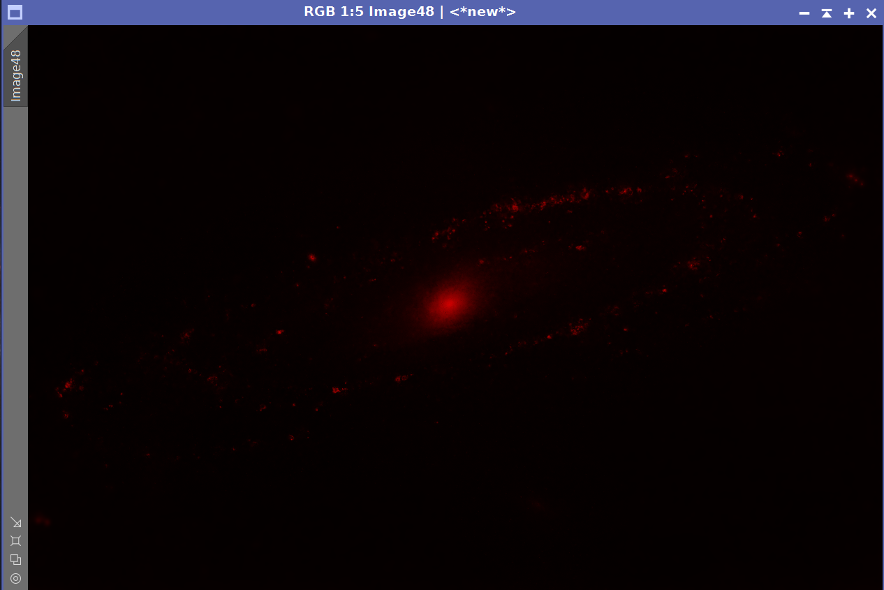

ThisIsntRealWakeUp 8.35
I personally use the ImageBlend script (repository link: https://www.cosmicphotons.com/pi-scripts/imageblend/). It has some tweaking available with a live preview, instead of flying blind in pure PixelMath. Basic steps are:
  1. Make your Ha image red using whatever method you're familiar with. (I personally use pixelmath... which I know we're trying to avoid. But this is just assigning R = Ha, so not too crazy).
  2. Use curves to make the background of the Ha black, with the only bright spots being where you want the Ha to shine through
  3. Use ImageBlend
    1. Set your stretched LRGB image to the Base Image
    2. Set your red Ha image to the Blend Image
    3. Play around with the "Blend Mode" to find one that is close to what you're looking for. I can't remember which one I like but I think it might be Overlay? Or soft/hard light. Not sure.
    4. Play around with the Adjustment Parameters of the Blend Image to dial it in
Editing to add: This is what my Ha image looked like after Step 2 for this image, to give you a sense for what you should be looking for:

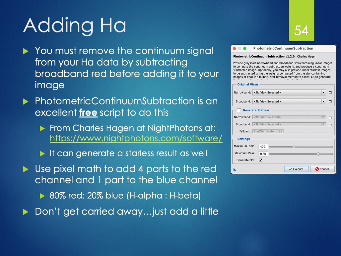

Just to be clear.  Pure Ha signal (i.e.continuum subtracted) should not be added only to the red channel.  Remember that the two srongest spectral lines of hydrogen contribute 80% in the red (Ha-alpha) and 20% in the blue (H-beta).  That's why hydrogen emission region appear to be magenta in RGB images.

Fortunately Vicent Peris and Martin Pugh have developed a nice way to handle this issue. The basic concept is to first subtract a scaled amount of the R channel from the Ha channel in order to remove the broadband contribution. You know it works because with the proper scaling factors, unsaturated stars in the Ha data will be removed from the data. Then a fraction of the Pure_Ha data can be added to the R channel and 20% of that can be added to the blue channel in the LRGB result. You can read a nice write up about this technique by Martin Pugh here:  http://www.arciereceleste.it/tutorial-pixinsight/cat-tutorial-eng/85-enhance-galaxy-ha-eng.  Don't forget that when you combine the Pure_Ha data with LRGB, it's necessary to multiply it by the Lum signal as well to make sure that the scaling is correct. Once you get the scaling factors plugged in, the result nicely shows the pure Ha regions.
Here's a slide from my NEIAC presentation about how to more easily remove the continuum.  Remember that you must CloneStamp out any residual stars to avoid screwing up the star field.
- John
- John
Shouldn't Blue be 25% of what you added to the Red channel rather than 20%?  (80% red + 80%/4 blue = 100%)
jhayes_tucson 26.84
Rick Krejci:
80%/4 blue
Hmm...  80%/4 = 20%.  You can do this in one of two ways.
1) You can add 80% of the Ha signal to the Red channel + 20% of the Ha signal to the Blue channel.
2) You can add 100% of the Ha signal to the Red channel + 25% of the Ha signal to the Blue channel.
Either approach give the correct ratio of 4:1 of the Ha signal going to the red and blue channels respectively (as I said in the slide above.)

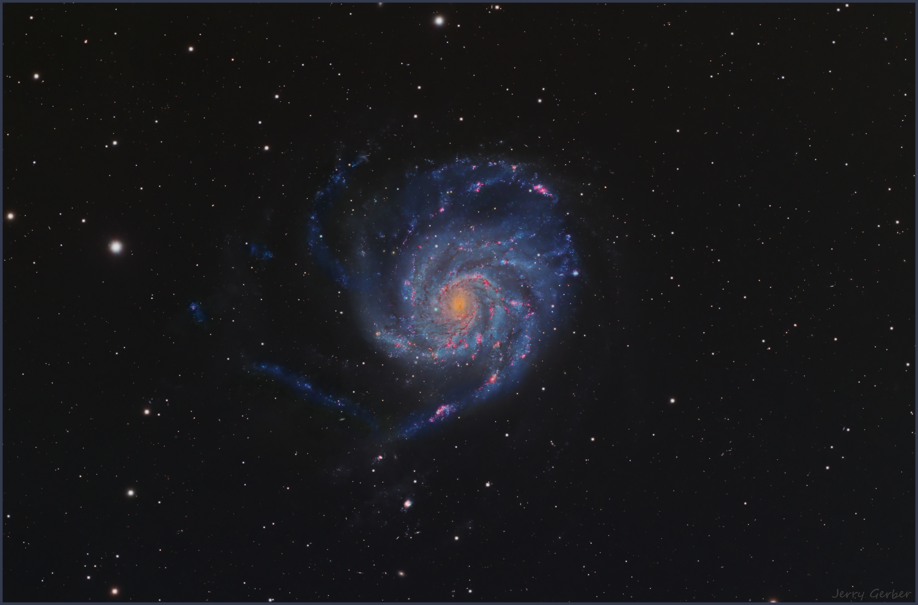

From reading all the comments here,  I can only conclude that each person has their own method to the madness.  With modern, sophisticated software, there are a multiple of ways to accomplish the same thing.   If Ha is 80% red and 20% blue, that comes out to magenta, yes?
Here's my first attempt at RGBHa.  I tried LRGBHa but I think the trade-off with luminance is a bit more detail but not as much color, or perhaps I should say I had to work harder to bring out the color.    Don't laugh, it's my first attempt.   Actually go ahead and laugh, it's my first attempt!
De gustibus non disputandum est
