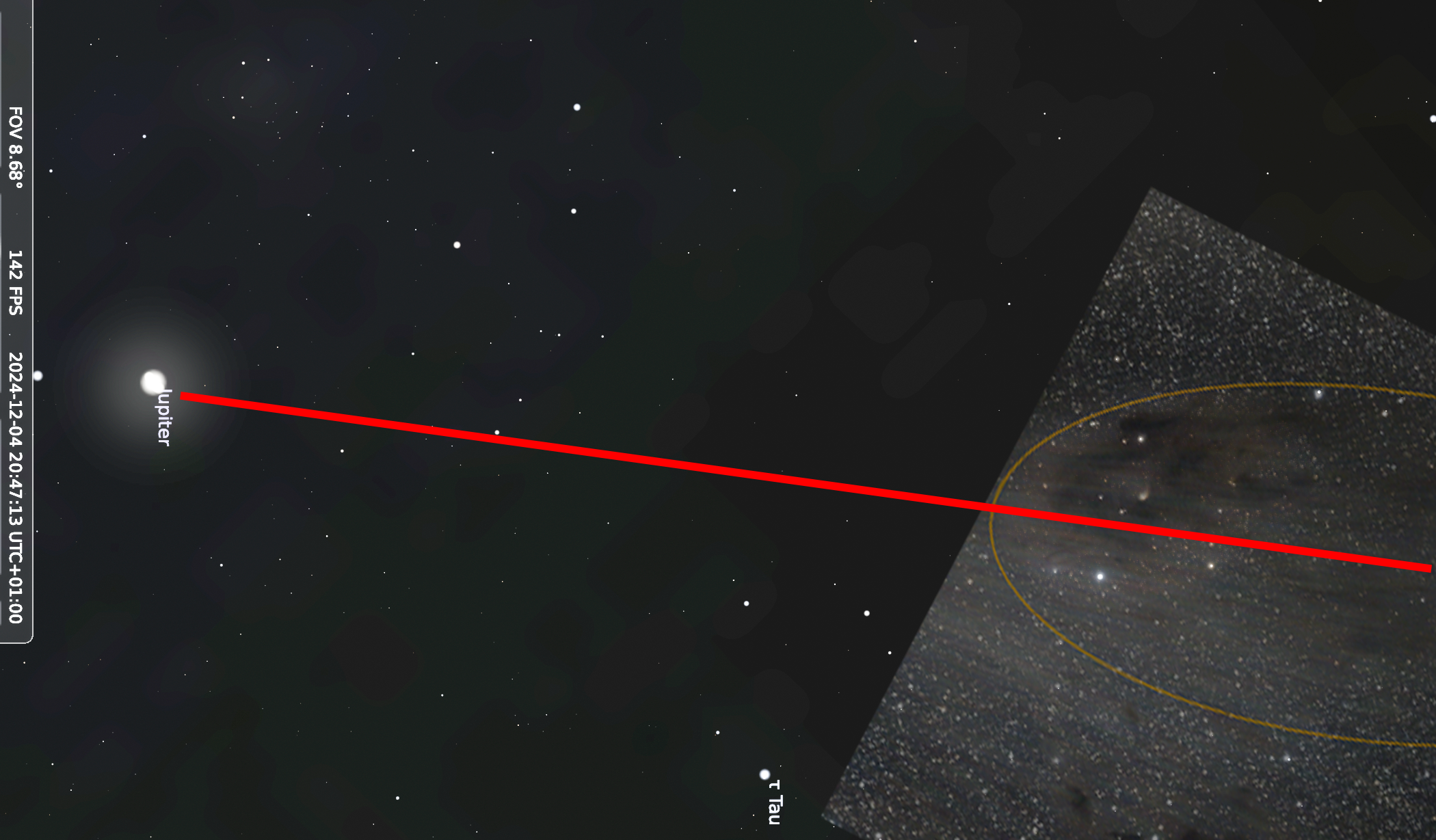

Got 109 images x120" exposure..When stacked, and in the upper left part you can see that the nebula is trail while stars are good !! means its not guiding issue !
I tried the following:
Stacked three groups of images, 36 each to isolate the affected ones >> all gives the same bad result.Tried both APP and DSS >> same result.Tried to stack the lights only w/o any calibration frames>> same result.I checked every single frame >> they are good and stars are round (except a small amount of sensor tilt) which I accepted.Revised PHD2 reports>> all good
NB: Due to the target is a Dark nebula, Its too hard to see any nebula in a single 120" image even with strong stretching , all you can see are round stars and a very faint dark nebula which you can't decide if its trail or not.

This is the first time I faced this kind of problem, ONLY one part of the image is affected !!
Any suggestions?

I don't think that's related to trailing, that would be pretty weird considering your stars are perfect. It's something else, like a light leak/flare etc. which is simply only visible in the places with nebulosity. And it doesn't look like Amp glow to me.
When and where did you take this?
My guess: It's a flare/reflection of Jupiter, as that would be aligned with the direction:
Johannes
Yeah, Jupiter…

Oh my God !
Jupiter was there yes, as I took images in 02/12/2024 , But it was about 6 degrees away from my target..
Didn't expect that at all..
In addition, no any indication of flare/reflection in the frames when observing the imaging session.
So, it leads to a question:
If this can't be noticed in single frame, what is the safety distance between planets and the targets? 10 degrees, 20 or more?
OR
what is the best way to avoid that? is it to go away from the whole area around planets?
2 fields away should be just right. From the edge of the frame, obvs.
