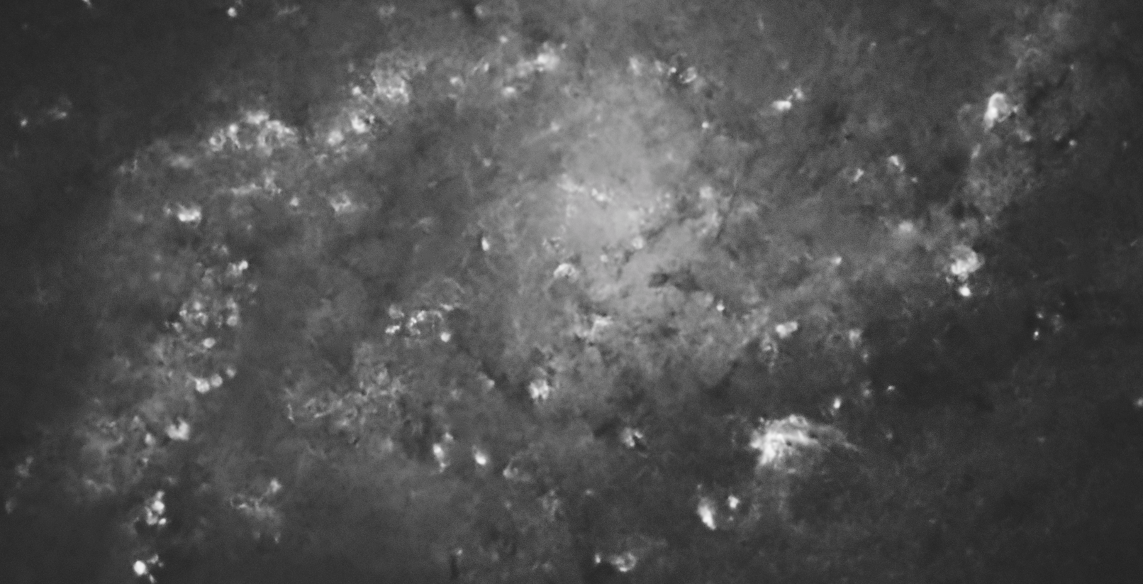

So here's what I came up with using your data using Pixinsight.
For processing I opened them all. Flipped the L and the Ha 180 degrees to match the R,G,B images. Then used DynamicAlignment to register the L and Ha images. Combined RGB. Ran GraXpert on L, RGB, and Ha images. SPCC on the RGB image. Then I used DynamicCrop to crop all the images the same. BlurX, NoiseX, and StarX on all. I only kept the stars from the RGB image.
After that I used GHS to stretch the RGB and the L images. Then histogram transformation to tweak the L image a bit. LRGB combination to add the L to the RGB image. I used unsharp mask to sharpen the LRGB image a bit. Then I stretched the stars in HistogramTransformation until I liked it. Added the stars back in.
Next I stretched the Ha image a bit. Used NBRGBCombination script to add the Ha. From there I used curves to tweak things a bit. Then I used ColorSaturation and dropped the saturation of the reds because they were overpowering, and I added saturation to the blues and yellows. Then used SCNR to take out all the green.
I think that's about it. There's more tweaking in curves I could probably do. I'm really not all that good at galaxy images (hope to improve this winter), and I usually struggle pretty badly adding Ha in to images, but I liked the way it came out with your data. With how much clouds, and then tweaking with a new set up I have it was fun having some data to play around with!m33.jpg

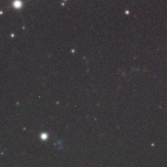

Are the master files calibrated? I found there was a lot of weird pixels in there:
Edit: Also some vignetting in the corners.
jakicevichap 0.90
Had some issues with the RGB calibration but fixed it manually later during processing. Woops D:

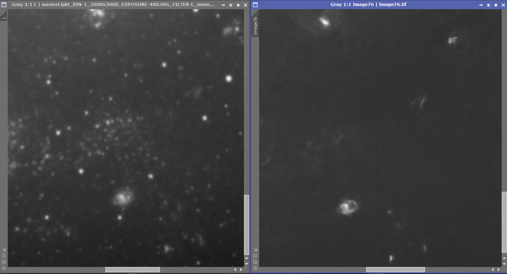

I'm trying to work a bit on the LUM channel, but it is quite blurry. I think I'm getting close to my end result though:

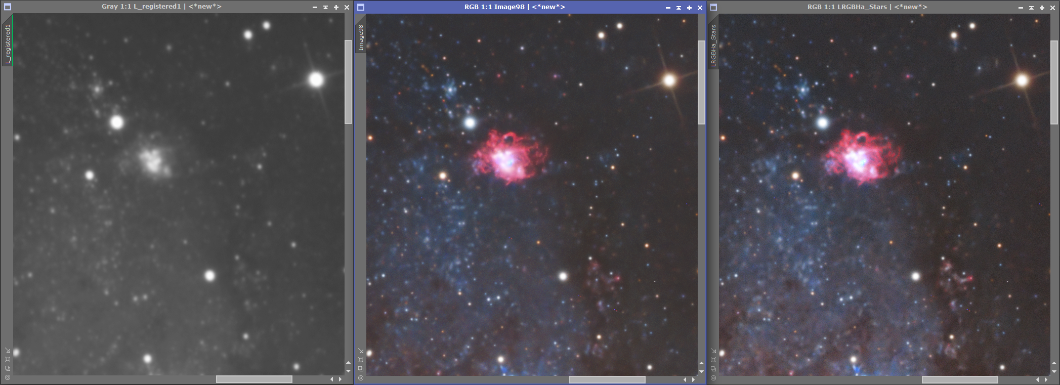

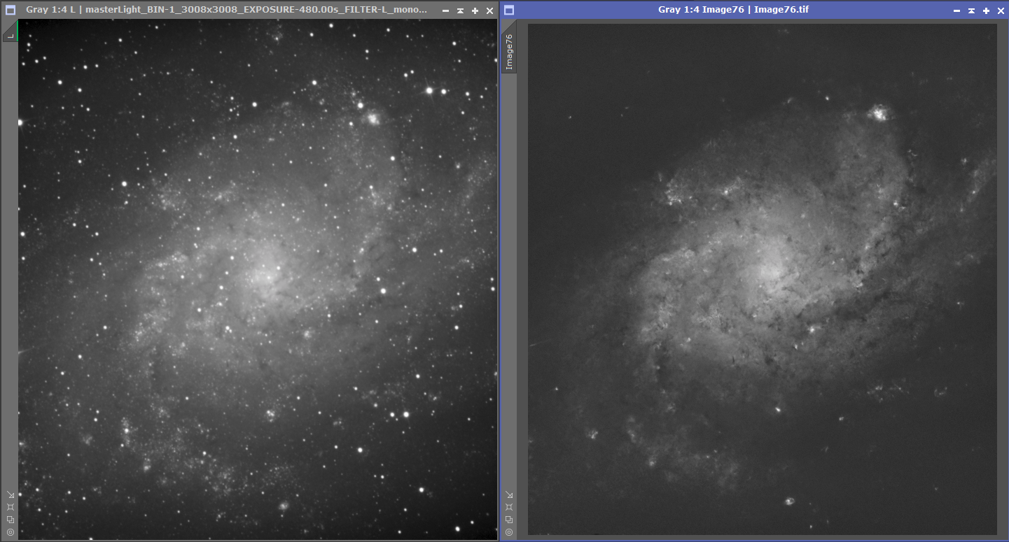

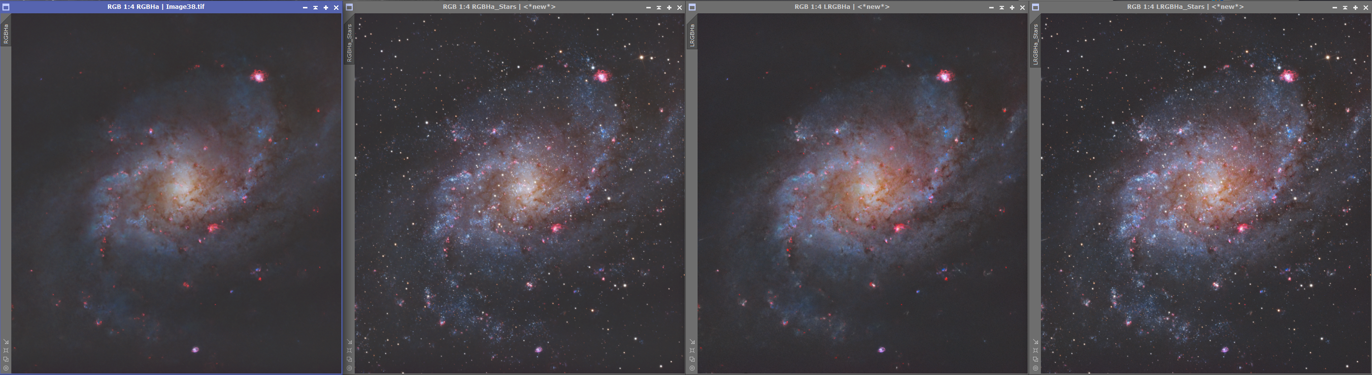

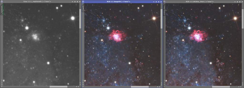

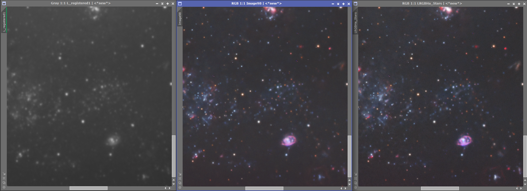

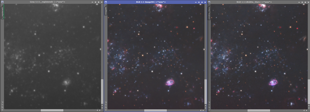

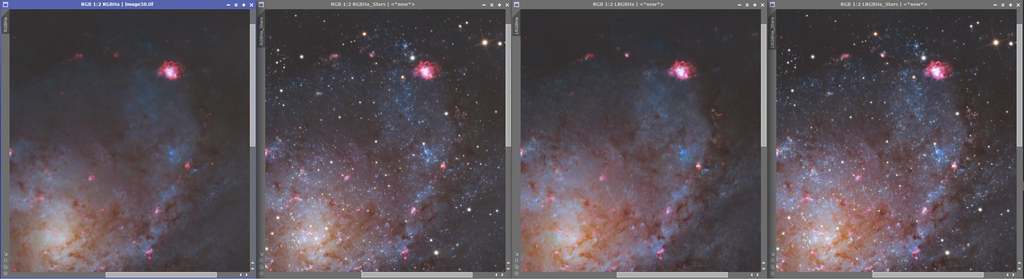

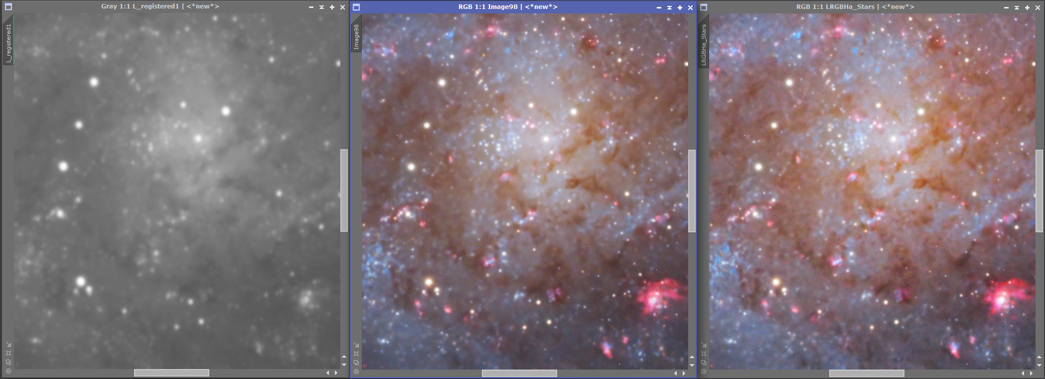

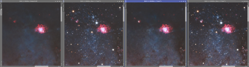

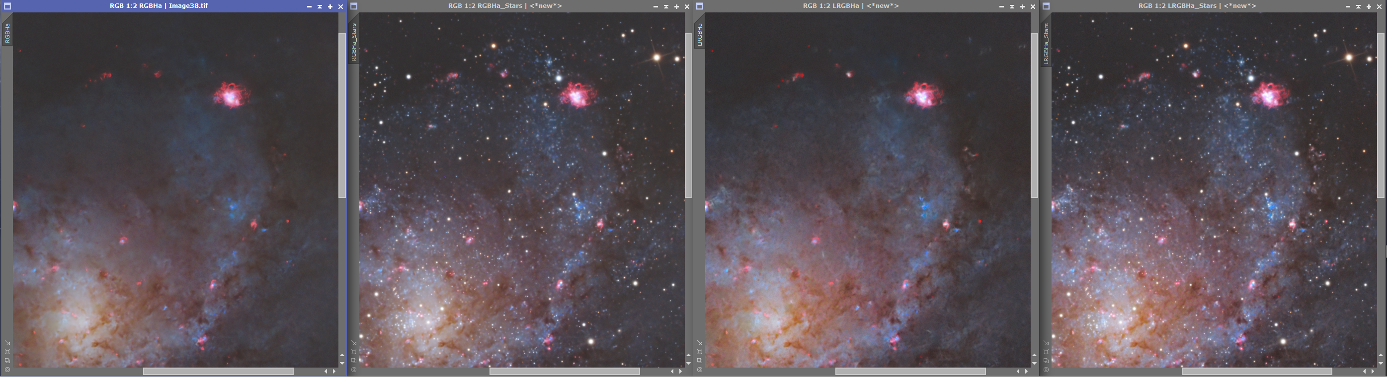

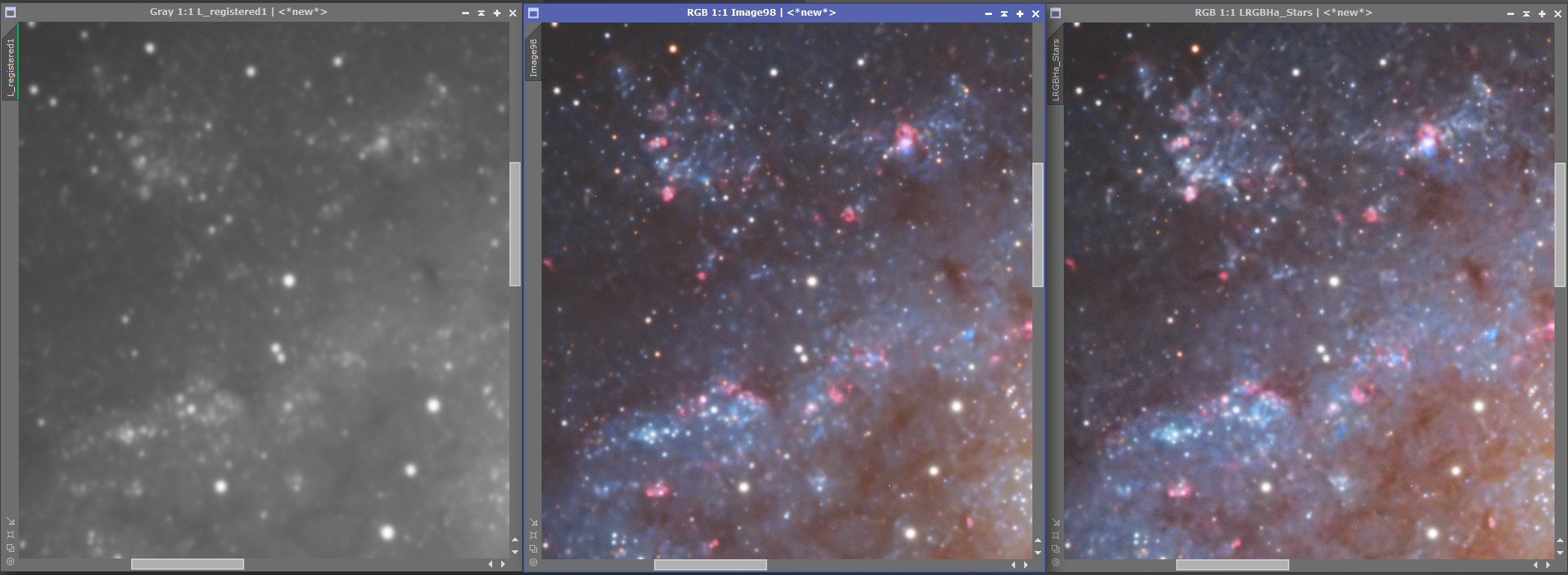

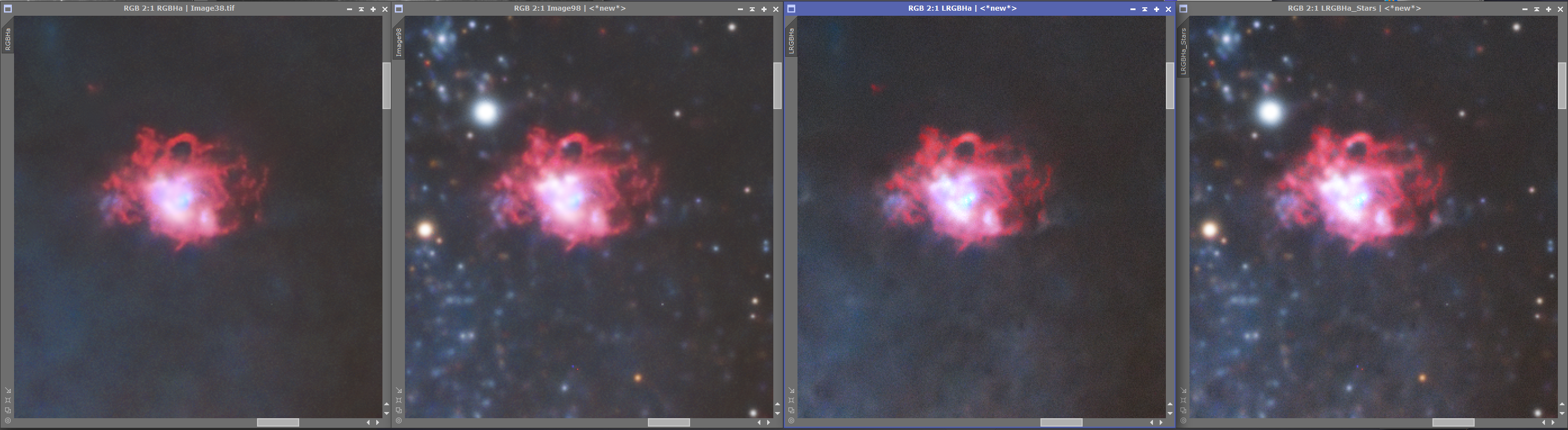

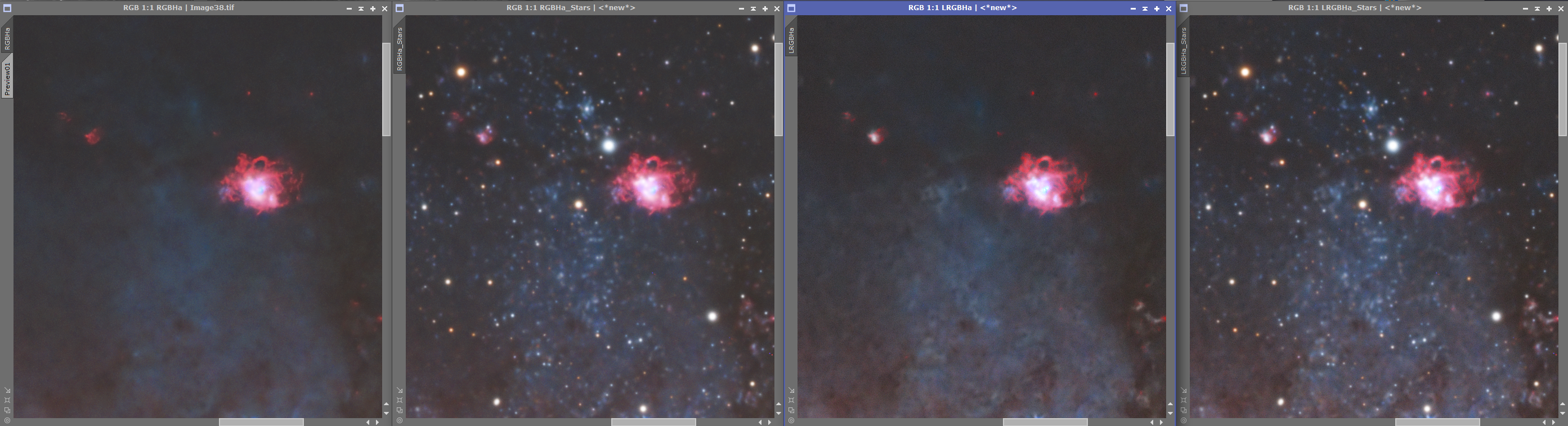

I don't know, maybe I need a pair of rested eyes on this. I find it a bit challenging to remedy the blurriness. I did some testing though, but not sure this is what you're looking for. I didn't do any hot pixel removal nor any fine cropping etc. Comparing to yours I probably did hold back a lot more while stretching as well while trying not to blow out the cores in different nebulas. I'm not sure how much can be done given the starting point.
First a comparison between the original L and processed L
Then RGBHa vs LRGBHa. Subtle details come with the L channel, also some stuff seem to be removed along with the stars from RGB but not from L:
Personally I found it looked a bit better 1:2 than 1:1 though, so if it were me I would probably resample it:
It seems I might have left a bit more grain/had a touch less denoise on the L images as can be seen in 2:1

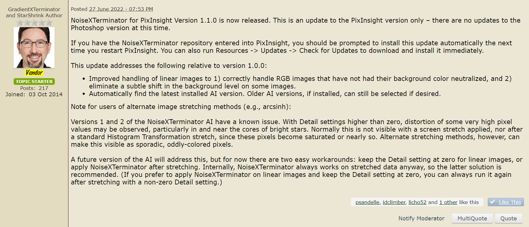

*** Attention!!
processing the image without the stars is convenient but be careful that star x terminator also eliminates structures similar to stars (therefore parts of the galaxy such as hydrogen zones or similar).
an alternative is to apply a well-designed mask so as not to remove these parts otherwise I think it is preferable not to remove the stars when processing galaxies.
I have seen images online that had these defects, so you need to use this tool but with moderation ***

*** Attention!!

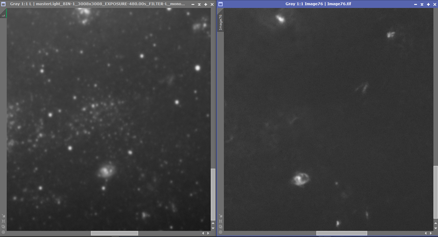

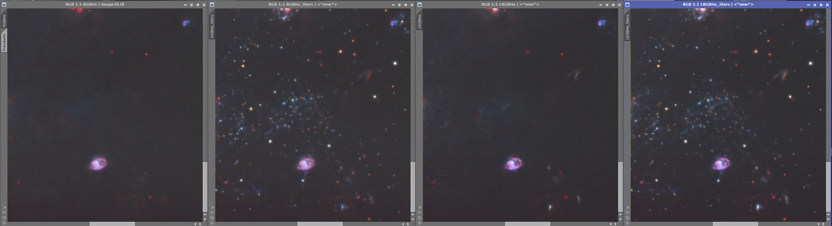

Attention?
I don't mean to come off as rude, but I tried pointing this out in the post above:
Which is why you can see that the screenshot from the initial L channel is very different from the one actually used. I prefer to work with duplicates to test various solutions to solve a problem (if there is one), before I land on a workflow. Initially I was working on a sort of superlum idea, which I then scrapped. Ideally you should work with a good mask as you say, but I think the point of the post was mostly regarding if it's possible to get a decent level of sharpness.
The reason certain details come with the L filter but not with RGB could have a simple explanation, the L filter has a broader spectrum than the RGB filters combined. For example (This is just to illustrate. the actual filters used might be different):
So it is very plausible that certain subtle details only lies within the L filter in such cases. Usually Luminance will have more detail, and as I read OP's comments the L channel also has 4-5 times the integration which is another reason.
Just a quick comparison between the original L channel (unprocessed) vs the processed HaLRGB and LRGBHa:
Maybe I'm missing something obvious, but I don't see where there is any loss of information? If you mean that these images have obvious defects due to excessive use of star removal it would be more helpful if you pointed out where.
I didn't include a detailed description of the workflow, but I can if OP finds it useful and see something that he can work on further.

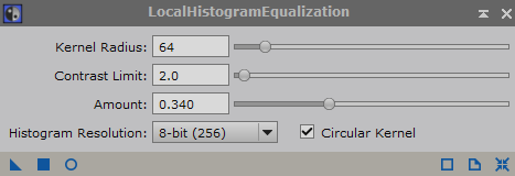

I applied LocalHistogramEqualization to the sharpened lum (using the same mask as above, clipped black point):
This can be very powerful, so it's a matter of holding back in order to not make the image pretty weird.

AstroReghe 1.20
Hi Jan Erik,
there are no right or wrong things, in my opinion it always depends on the type of object being processed.
For the known problem with the old version of noise x terminator, I don't consider it a problem because in my opinion it is good practice to run it with a mask that protects the areas with high signal.
In fact, the defects were created on saturated pixels.
however, as you do it is still correct!, I also sometimes apply noise x terminator both linearly and non-linearly
