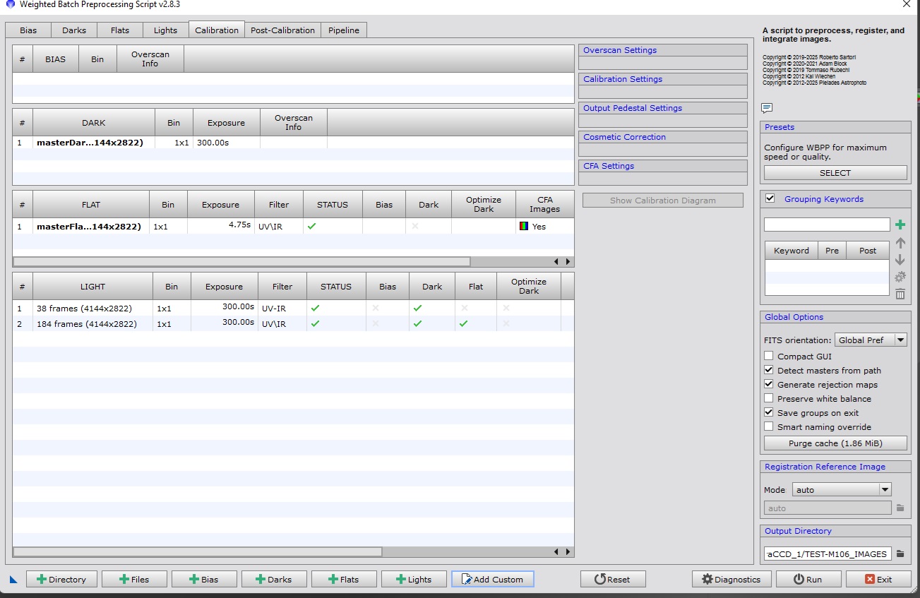

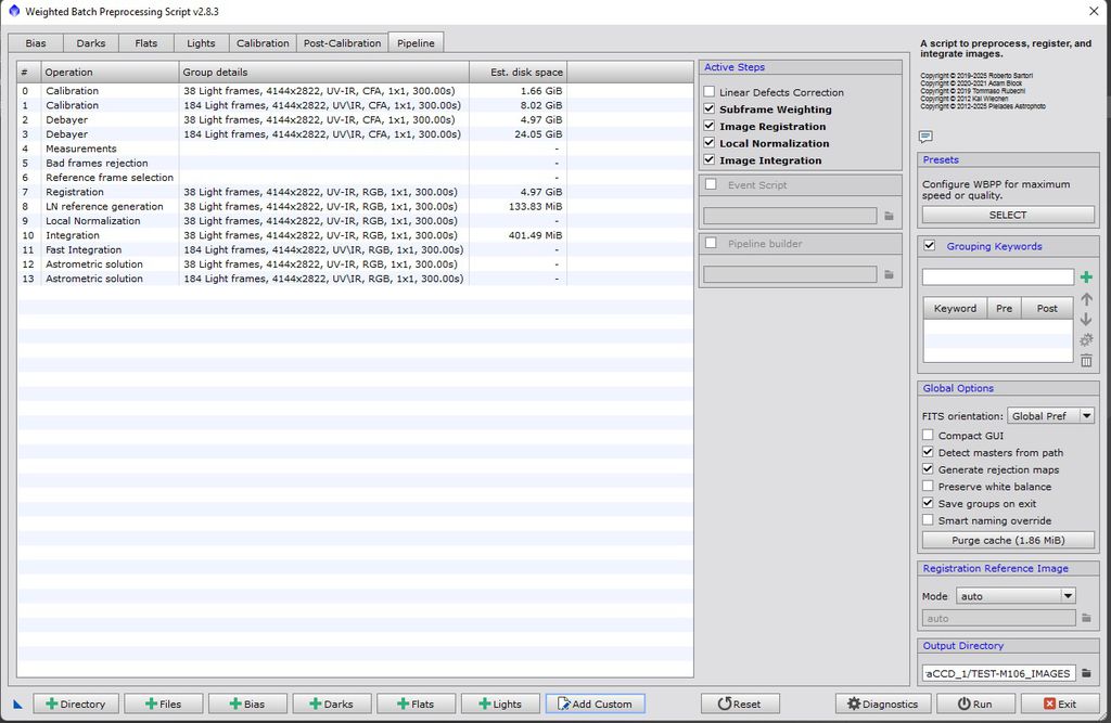

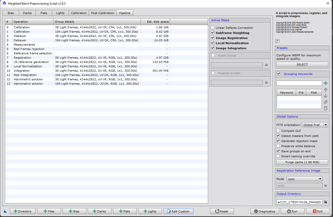

Hey Mike. I stack different filters together and have not had this problem. Any chance you can send a screenshot of your WBPP for the lights page as well as the post calibration and the pipeline pages. It should be a simple fix.

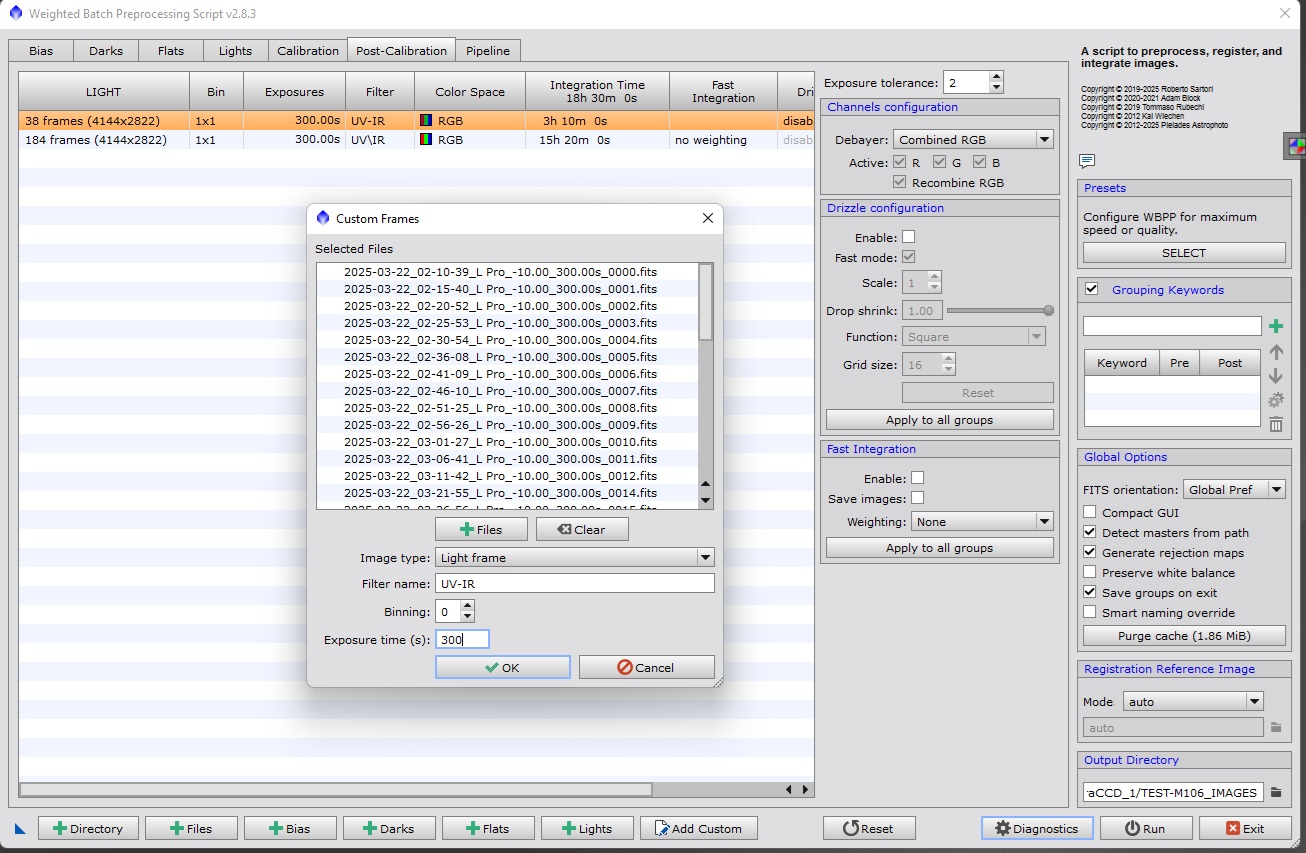

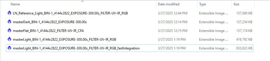

This is what I did in WBPP. It still looks like it processed them separately. Or, am I wrong about the two bottom files. Also, I didn't know about which filter to list in the custom add button, the L Pro or the UV-IR.

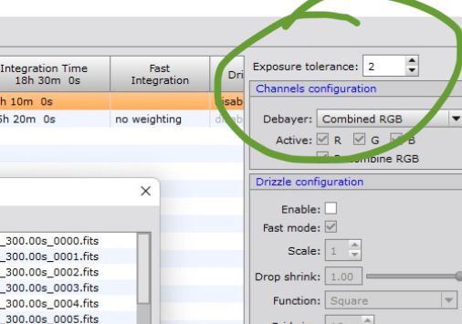

Oh and another thing I’m just noticed - which actually may be even easier!!
ont he post calibration tab there’s an exposure tolerance. Increase that to 300 - which is what your exposures are. See if thatIMG_0310.jpeg gives you one output image

The filter name does not match exactly.
It needs to match exactly.
Changing the exposure tolerance wont help here, because the subs all have the same exposure. The reason why they are not processed together is only the different filter name.
Brian_Fowler 1.20
The filter names are written in the fits header.  You can edit this one at a time or use the batchFITSkKeywordEdit script. Then it will stack them all together.
