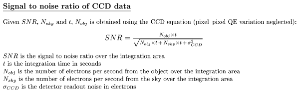

Karl *Unfortunately no, 1200x1 sec does not equal 1x1200 sec. The exposure time per sub and total can be computed given a whole range of parameters. If you Google CCD exposure time equation you will find examples. I wrote my own python scripts, but in general for amateur work you can do close approximations. Why? Because amateurs don't use photometric filters
Watch R.Glover presentation on YouTube regarding exposure time per sub.
SharpCap Smart Histogram is a good tool to use to find the optimum exposure time. For my last image, the program showed that 3.4 seconds would allow 5% noise and 60 seconds for 1% noise with my sky brightness and camera profile. I choose 4 seconds as it would allow me to capture shorter subs while not introducing more noise. Yes I could have took 60 second subs but for this "experiment" 4 seconds was optimal and any less would have required more subs. Again, this was an experiment and not trying to prove anything. Just testing a hypothesis and sharing my results. CS, Dave
*Actually, it is pretty strightforward:  Which goes to show that the difference is in the sigma-squared factor i.e., the RON^2/t and the SNR is proportional to the square root of the integrated time which is independent on the number of integrations.
On close inspection yes but if you want to compute it's not so easy ... What is your sky background magnitude in different astrodon filters? Did you measure? if so how did you calibrate (what is the zero point in the image) the magnitude since astrodon filters are not used by professionals .... but sloan or bvri etc Get my point? Not quite. I'm only in the business of establishing relationships not actually calculating a specific SNR. Why Astrodon, btw?
This is why I just paid the $20 for SharpCap Pro as it does a pretty accurate sensor analysis, then right before I image a subject, I run the smart histogram which measures the sky background using the camera and filter I choose, then calculates against the e/ADUs and gain of the camera against the same formula you have shown to display the optimum exposure, gain, and offset to maximize the exposure time with options of how much signal noise you want to allow. I used to use the script with Pixinsight and it wasn't very accurate. Dr. Robin Glover made an easy way to calculate the proper exposures without all the guesswork. This is also very useful for narrowband filters especially the photometric (SLOAN/SDSS or UVBRI) as it takes your camera quantum efficiency for that wavelength into account. Worked great for my IMX 585 camera with the SLOAN z-s filter as near infrared can be tricky.
