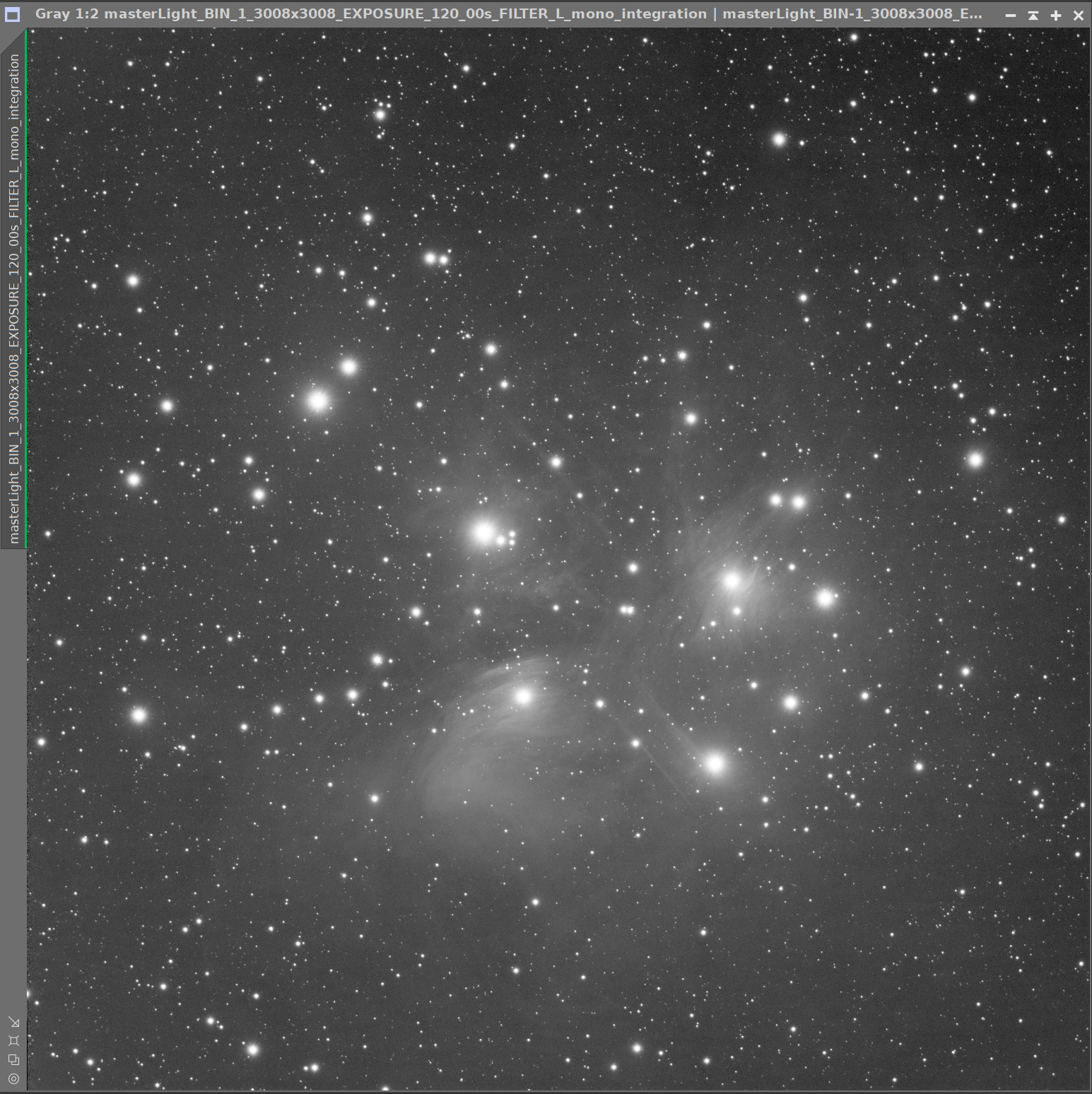

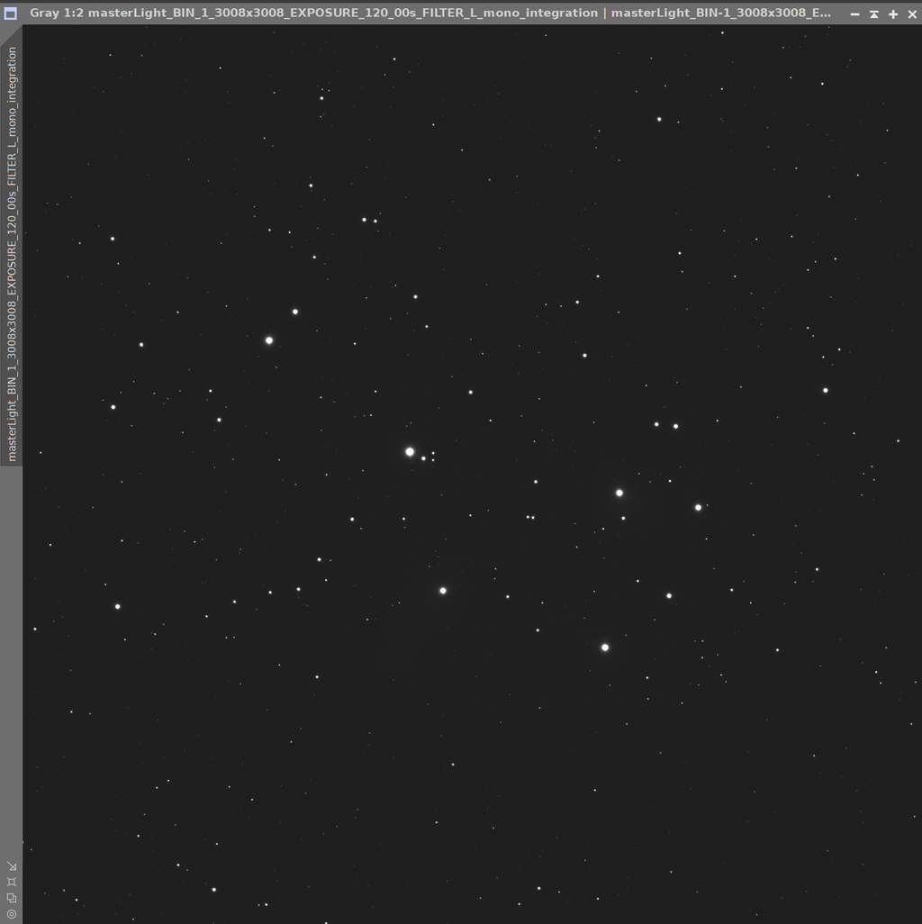

I need some help with my luminance data. It's my first time imaging with luminance on a mono camera so I'm unsure if the following is normal or something is amiss.
I recently took around 1hr of data on M45, with 120s exposures using an ASI533MC Pro, WO GT71 MKII and Optolong Lum filter. I stacked the image as normal via WBPP but when opening the file I noticed the background (without any stretch or STF) was quite bright compared to my other data, which is solid black.
I understand the 120s exps may have some effect on this, but this doesn't occur using an OSC with a broadband filter taking 300s shots from the same location.
I can perform an STF fine (image below), but when it comes to actually stretching the data, it takes a lot of effort to bring the detail out, by which point some of the data is lost.
Can anyone shed any light on this?
I have attached the single light frame, and here is a link to the staked file - https://drive.google.com/file/d/1bXMasd2jL8U6E3X4o-mtNioRaneUBJKc/view?usp=sharing. This is the LIGHTS ONLY - no darks or flats (as I thought maybe these could have affected it).
Below are also some screenshots of the image in Pixinsight with no stretch, and STF and HT.
Thank you.
No stretch
STF

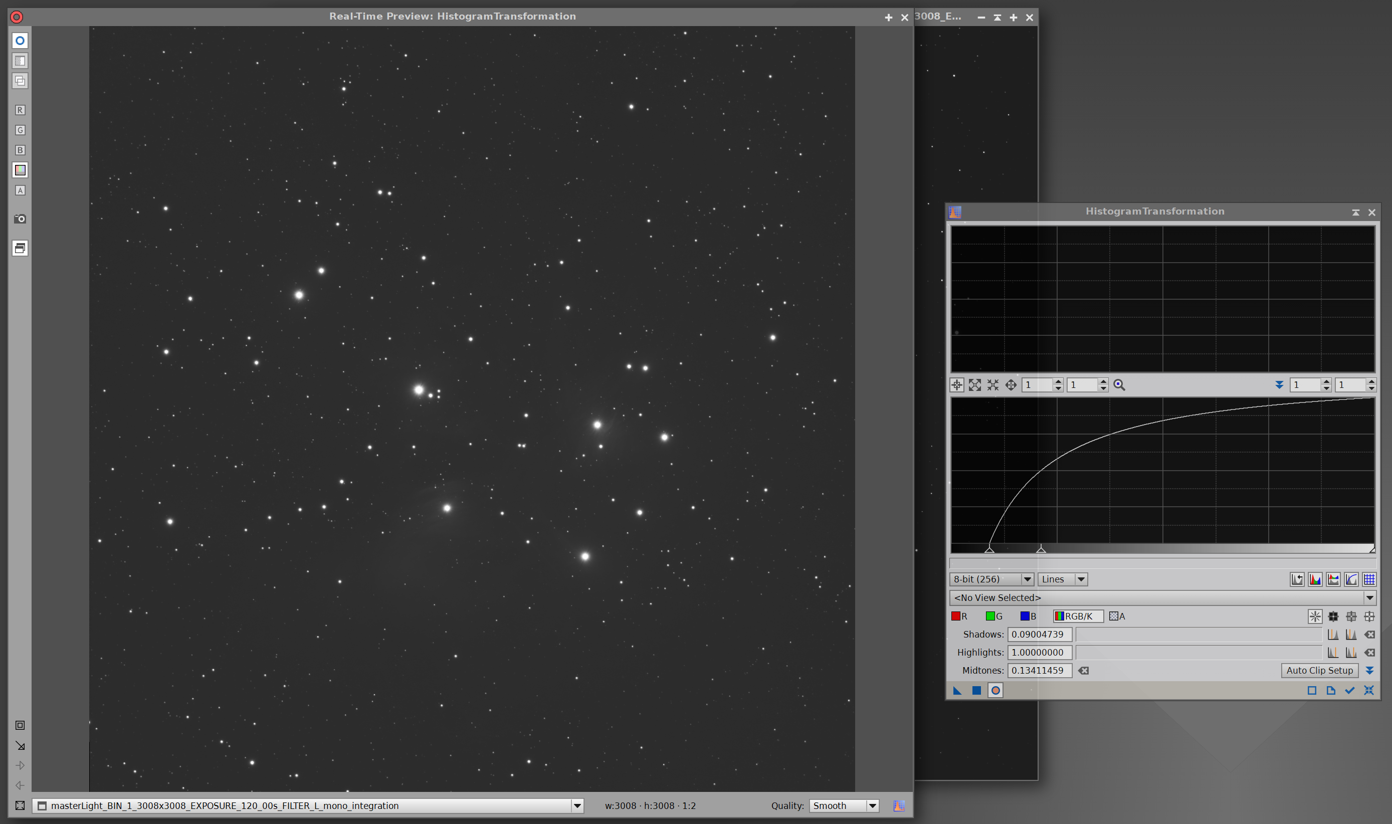

HT after three passes.
afd33 9.38
It looks normal to me. I don't know what three passes of HT means, especially when you don't have the view selected to see what the histogram is actually doing.

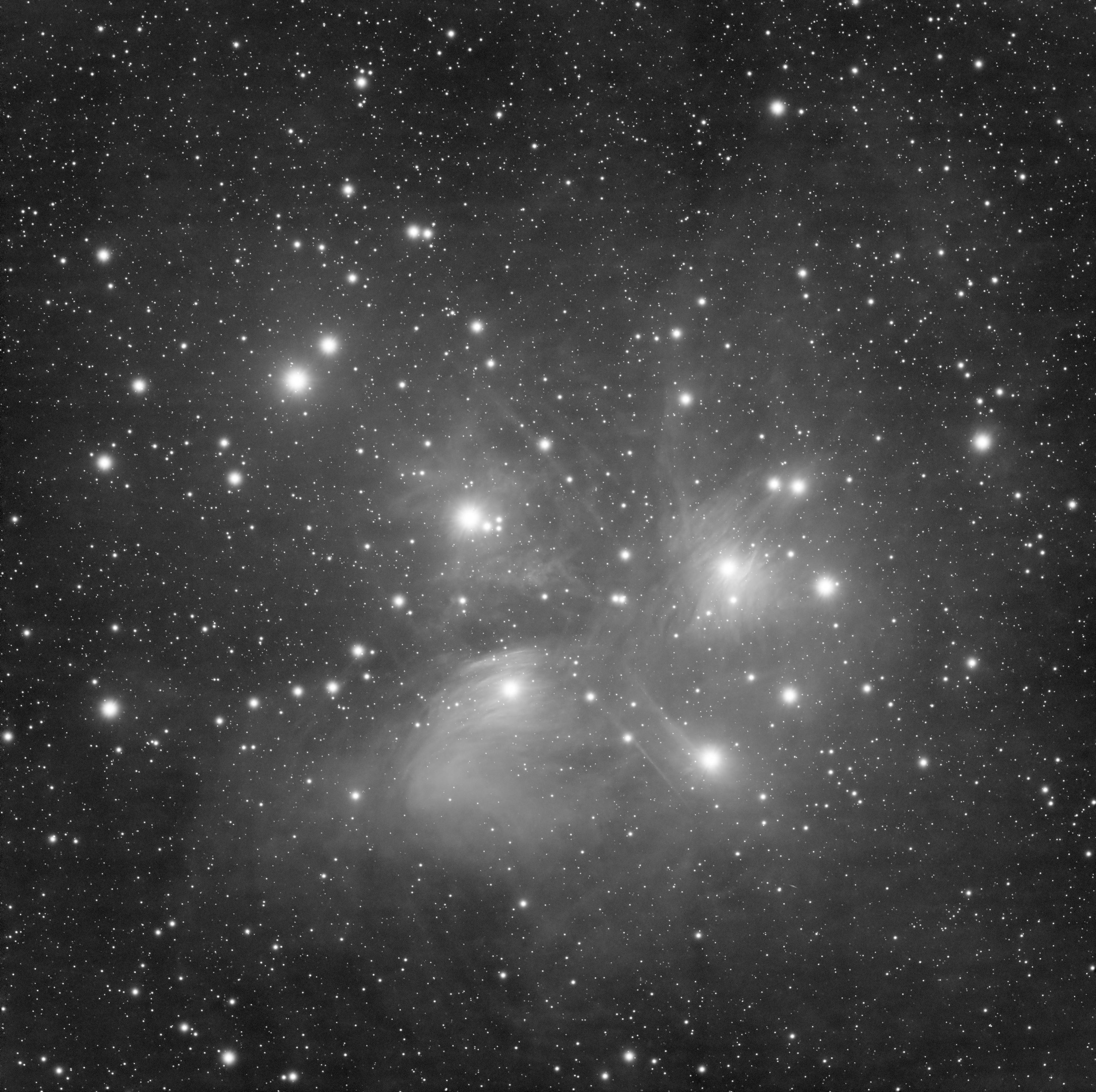

Here's a very quick modest processing of the luminance image you linked:
DBE → BlurXTerminator → NoiseXTerminator → STF into HT
Everything seems normal

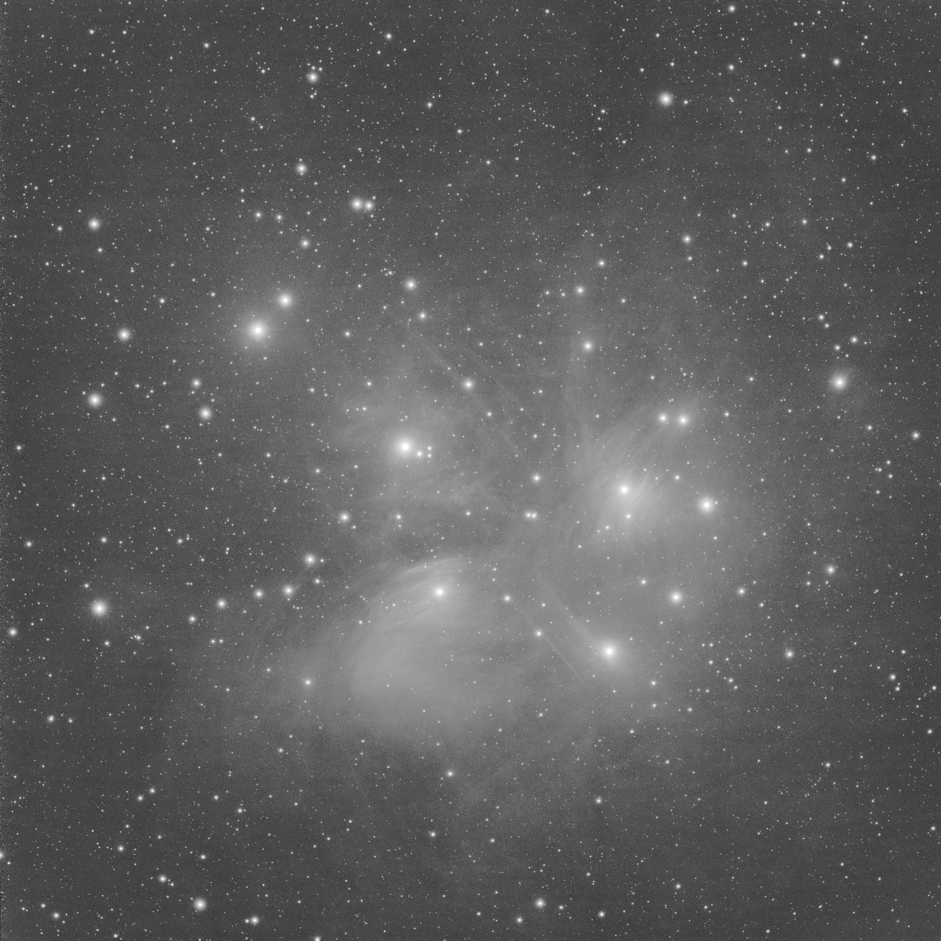

I did a DBE, followed by Blurxterminator (of course lol), careful stretching with GHS (look up Adam Blocks tutorial on this, its long and boring but its so worth using. Lets me stretch the data without blowing out the stars) then Noisexterminator
Process the RGB stuff first and create an RGB image. Add this as lum.
I cannot stress the importance of careful stretching with GHS, its very important. More integration time would also help.
I probably wouldnt stretch THIS much before adding as lum to RGB image
