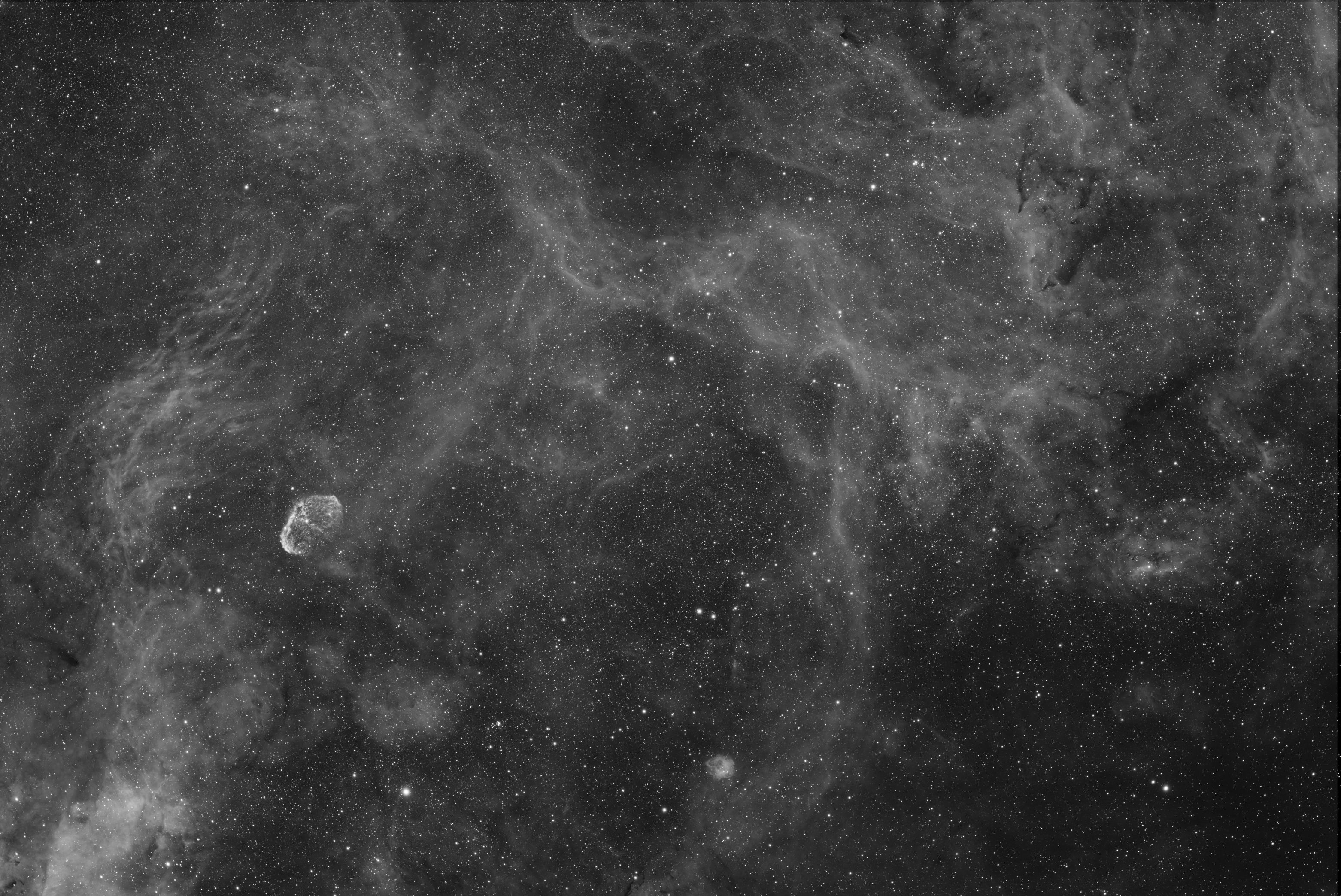

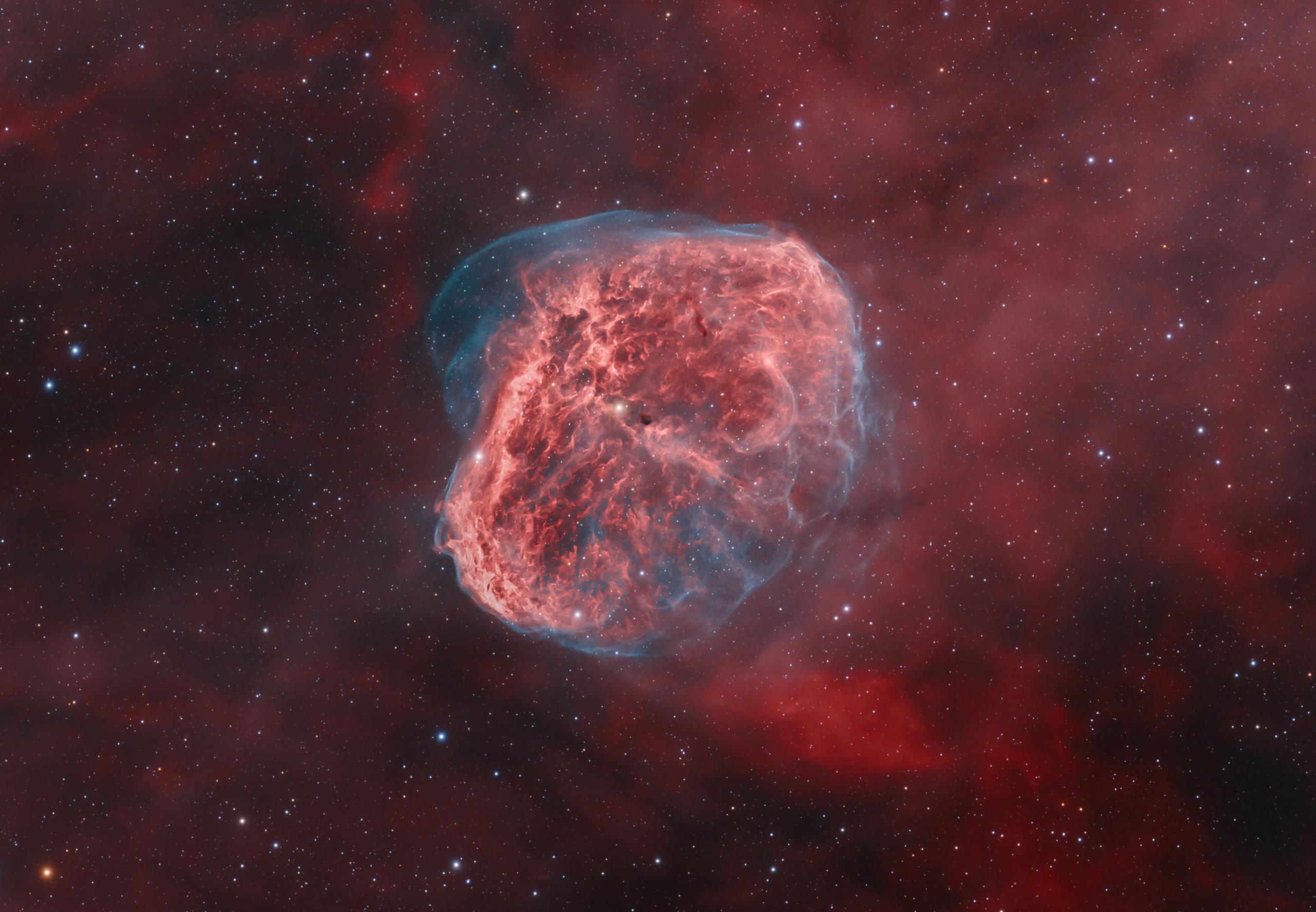

People quite often ask me how I get such results with Redcat 51, what is my secret. The thing is there is no secret. Understanding what Drizzling does is the key.
I have a significant undersampling with Redcat 51 and 2600MM. For example, this is the full image I get:
But when I apply x3 drizzling to this image, I'm able to get this image:
This result is pretty close to what one (on average) gets with much higher focal lengths (compared to 250mm). This is the power of drizzling in undersampled cases. But if you ask around, many will say 2x drizzling is unnecessary. Let alone 3x... Well, the result is right here.
People with different setups that don't benefit from drizzling much try and see no difference and blame the drizzling. Understanding what the process does is quite important to avoid such confusions.

Can you present both images at the same image scale? I think that would show better the point you're trying to make.

Not wanting to put words in Kay's mouth, but I suspect it's something along the lines of:
You will be left with two sets of masters. For the full FOV image just use the basic master but the drizzle master will allow you to crop an item of interest in the full FOV (the Crescent in this case) and have a very good high resolution image of a fractional part of the overall FOV. Two presentations from a single imaging session. Or maybe I'm completely off base since I'm not all that up on drizzling.

Now that makes perfect sense to me. Thank you.
If I measured it right, the average FWHM of the image is under 1" which is well below the resolution limit of a 51mm aperture (2.28") Apparently it can be a very powerful technique indeed.

Yes, pretty much what I wanted to say. It's nice because I can shoot multiple targets at the same time, saving me a lot of time. But even if I use the full FOV, I still drizzle. I can easily notice the difference. I tested to see the difference between 2x and 3x cropped images on Crescent (and Horsehead) and there was a minimal but noticeable difference. Some of those filament structures inside the crescent are a few pixels wide and adding a few more helps with how we perceive it-- at least. Which is what we are interested in whatsoever, it doesn't matter if it isn't really recovering something. To make sure I'm not crazy I sent the comparison to couple of friends without telling them which is 2x which is 3x and they were all able to tell.
Sorry that I did not keep this comparison data-- maybe I'll do it again and share the results one day. But I always recommend testing things out yourselves to see what fits best for your setup and workflow.
