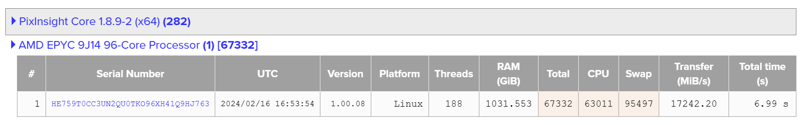

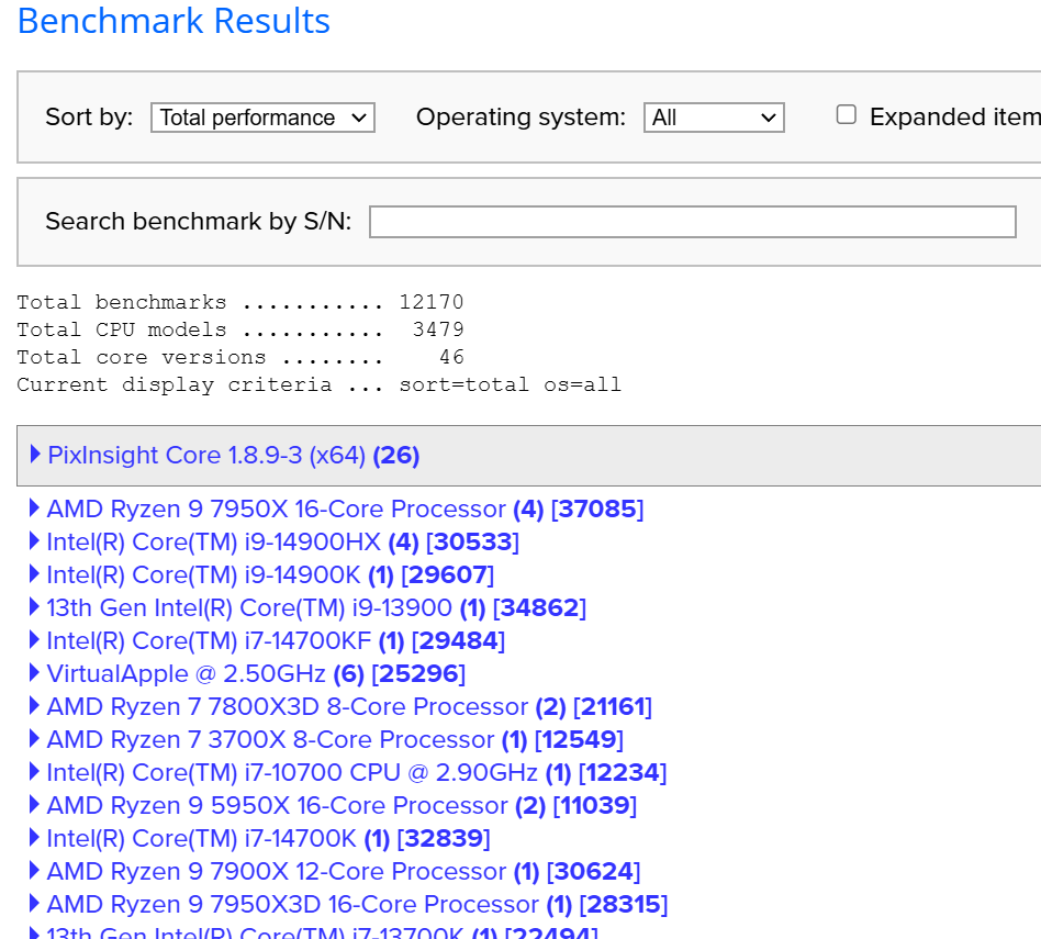

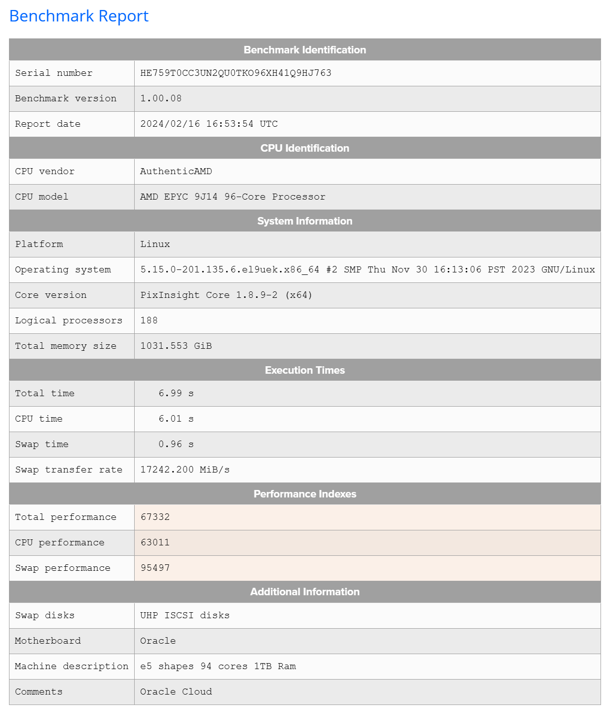

Then click on the hyperlinked serial number and it will give you more details of the build:
 The swap performance on that one is off the charts. I don't know how they achieved over 17GB/s swap performance, but that's a big reason why it scored so high. Something about the EPYCs, they seem to score really high on swap throughput (and I assume, in general, overall disk throughput.) The raw CPU performance matters, and having 192 threads is a big deal, but this system's I/O rates are so high that data transfer times there basically don't matter. Most of the highest scoring (well, lowest total time) benchmarks have high I/O throughput. More normal swap transfer rates are 3-6GB/s, with a pretty darn good "average" system scoring 8GB/s or so. It takes a lot of money to hit 7 seconds on the benchmark, and in all honesty, unless you are processing MASSIVE amounts of data, its utterly unnecessary.
Andrew Burwell: Unless you’re ok doing preprocessing/calibration in Astro Pixel Processor which does use the GPU. Processing the same stack in Pix vs APP can go from 30 minutes to 6 minutes. It’s at least worth downloading the free trial so you can do your own benchmarks and compare on your current computer systems the difference in speed.
I would still do all my post processing in PixInsight. Seems like the writing is on the wall regarding adopting GPU for preprocessing.
Jon Rista: The swap performance on that one is off the charts. I don't know how they achieved over 17GB/s swap performance, but that's a big reason why it scored so high. Something about the EPYCs, they seem to score really high on swap throughput (and I assume, in general, overall disk throughput.) The raw CPU performance matters, and having 192 threads is a big deal, but this system's I/O rates are so high that data transfer times there basically don't matter. Most of the highest scoring (well, lowest total time) benchmarks have high I/O throughput.
More normal swap transfer rates are 3-6GB/s, with a pretty darn good "average" system scoring 8GB/s or so. It takes a lot of money to hit 7 seconds on the benchmark, and in all honesty, unless you are processing MASSIVE amounts of data, its utterly unnecessary. I don't really know how cloud computing works so can't really say anything definitive and informed, but what is reported here by the user who reported it, they may not completely know what the swap disks really are. What I do see is the ratio between CPU time and Swap time for the one I posted above is similar to that I get with my computer.  You pretty much nailed the swap performance for my system. And this seems to be consistent for those who have set up their swap disk folders well, per PI suggestions. I can't remember how it worked for me when I set up my swap folders on two RAM disks. I don't think it was that different, even though, on my computer, the access time and transfer rate to the RAM disks blew away even my NVMe drive. But the difference was between a fast blink and a blink in time... I may be wrong, but I think this ratio between CPU time and Swap time could be a good diagnostic for what one should target when they are playing with their Swap configuration. Clearly some who reported benchmarks should fix their swap configurations. I often think about when or if I should consider building a new computer for this processing stuff, now that I am getting on to 5 years post build. But I have to say that I cannot complain. Mine is no super computer, but with sufficient RAM, though just DDR4, 3200 and a PCIe 3.0 motherboard. And no where near the latest processor with the 9th gen i9 and 16 logical processors, its still reasonably competitive in its class. On the other hand, the good news for those building today is that any new stuff in the mid-range, should easily outperform my computer assuming they don't get saddled with a dog of a motherboard, or whatever. But everyone should be aware what that performance means in the real world, within the context of what software they are using. Paying $5-10x to get a time to completion that takes you from 20 seconds to 15 seconds does not seem to make much sense even if the computing community sees such gains as phenomenal!
Alan Brunelle:

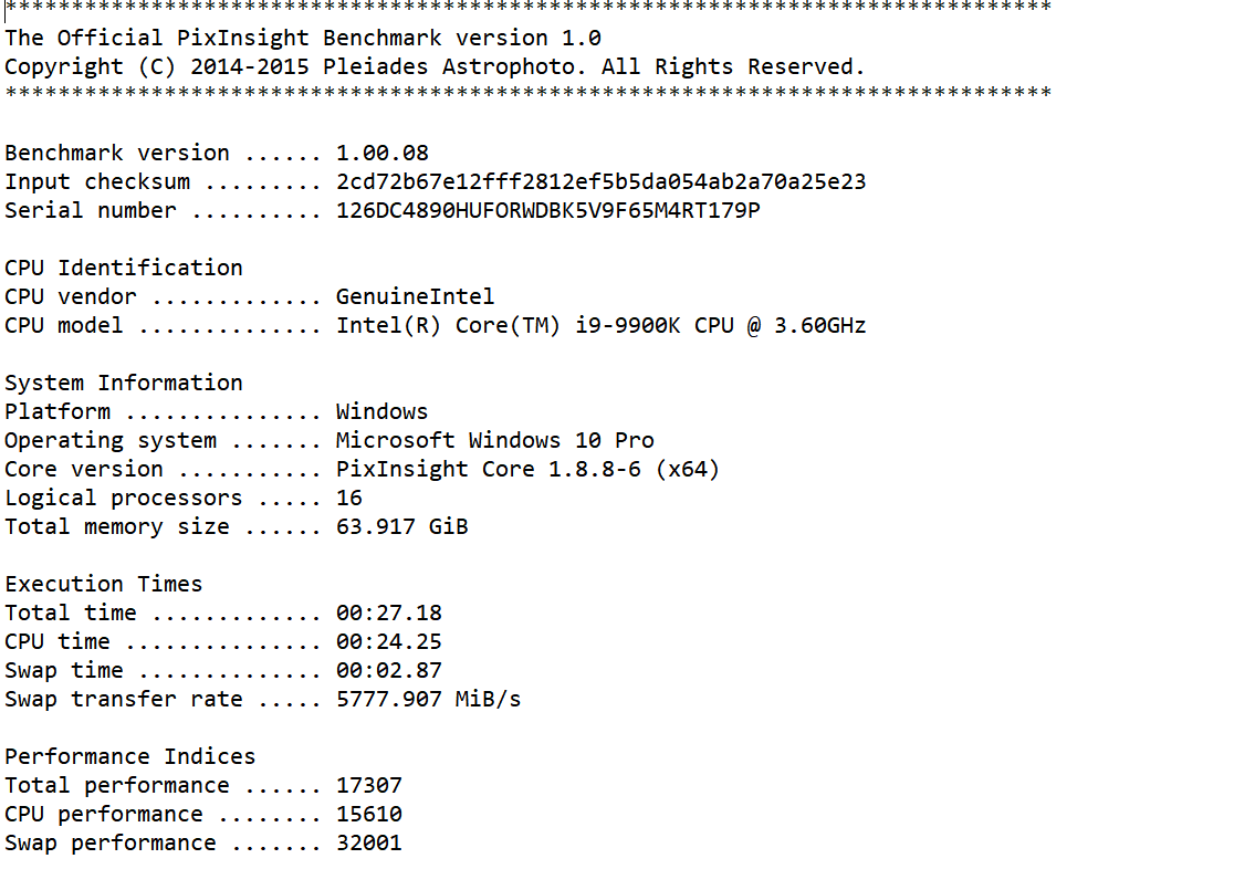

I often think about when or if I should consider building a new computer for this processing stuff, now that I am getting on to 5 years post build. But I have to say that I cannot complain. Mine is no super computer, but with sufficient RAM, though just DDR4, 3200 and a PCIe 3.0 motherboard. And no where near the latest processor with the 9th gen i9 and 16 logical processors, its still reasonably competitive in its class. On the other hand, the good news for those building today is that any new stuff in the mid-range, should easily outperform my computer assuming they don't get saddled with a dog of a motherboard, or whatever. But everyone should be aware what that performance means in the real world, within the context of what software they are using. Paying $5-10x to get a time to completion that takes you from 20 seconds to 15 seconds does not seem to make much sense even if the computing community sees such gains as phenomenal! It looks like that top-rated config uses UHP iSCSI disks for swap. I hadn't heard of that before, but apparently its some kind of networked storage that can be configured with multiple channels for rather insane performance. That may have something to do with it. Unless your RAM disks are vastly outperforming nVME drives, you are probably better off just sticking with nVME. Especially PCIe 5, if you have the opportunity, which last I checked, were outperforming RAM disks (which are emulated, hence the limits on performance.) IIRC ram disks were hitting ~7GB/s burst rates, while even a top rated PCIe 4 drive would hit nearly 8GB/s, and a PCIe 5 should hit 12.4GB/s. From what I read, the UHP iSCSI drives can be configured with multiple active channels, each of which can hit near 3GB/s per channel, and you can have a lot of channels. It seems like these UHP iSCSI drives have limited viability, they require special configuration with Linux, and I've had a hard time determining if its possible with windows (and if it is, its even more specialized configuration.) In your case, your swap performance is double your CPU performance, so I'd say you are probably thouroughly CPU bottlenecked right now. Note your times...it was just shy of 3 seconds spent on swap, and 24 seconds on CPU. So a CPU upgrade would be the most beneficial upgrade for you. That said...you are still under 30 seconds processing time. You would really have to weigh the value of an upgrade. At best, you might get down to about 15 seconds, which seems to be a rough limit for consumer grade equipment. Sub-10 seconds seems to be largely limited to EPYC systems (I honestly don't see the value in spending that kind of money on a rig just to shave a few seconds of compute time here or there during a manual processing session in PI...) To gai significantly on the cpu time front, I think it requires really scaling out the thread count (but if you do that, it could stress the I/O throughput more...you could hit swap a lot more frequently if you are doing your processing much faster). Those 96 core/192 thread EPYCs really push the envelope there, but boy are they costly ($5 grand or so just for the cpu).
