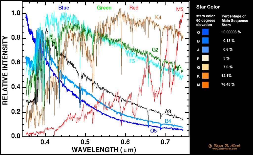

No, it's not a newly discovered recording by Stevie Ray Vaughn, kinda wish it was though... I just recently ran across this chart of star colors:  You'll notice that less than 1 percent of all stars are blue which leads to my question: Why are the Galaxy arms in a lot of astrophotography depicted as very strongly blue in color? I know I don't see that in my own data so it's really making me question where it's coming from. The graph above seems to show that depicting the arms as excessively blue is very far from reality. I suppose a case could be made that it's because the very brightest stars are blue but does that offset the data above? Especially considering that a UV/IR cut dumps everything above 400nm and the blue filter in a RGB set do the same.
This is very much true in our galactic companion, the Andromeda galaxy, where you often see an exaggeration of the blue intensity well beyond what the photometry would suggest. The same would apply on the average galaxy out there which would need to appear more yellowish than the current fad in over-emphasize color contrasts would otherwise lead one to believe. Having said that it is true that the OB clusters form in the arms of the galaxies and showing them isn't supposed to raise any eyebrow.
My understanding is that blue in galaxy arms is an indication of blue giants which in turn indicates star formation because blue giants are the shortest lived, so if they’re around they must’ve been formed recently. Giant, so bright, and maybe few because they come and go so quickly, relatively speaking.
Cheers, Scott
And Andrea pointed out, that could be true of OB regions, areas where star formation is intense but not for the entire outer portion of a galaxies as it's often depicted. Even in intense star forming areas there will be a lot of stars that are not super bright O & B type.
That's a good question.
In my pictures I don't tweak anything in the colors after SPCC is applied, yet in most cases galactic arms are blue.
So there should be some truth in this.
The type O and B stars found in the spiral arms of galaxies are super luminous so they are 3-6 orders of magnitude more luminous than the old yellow/red stars found in and around the core. A lot of these stars form in the spiral arms and that's what gives the arms their characteristic blue-ish color. John  |
John Hayes: The type O and B stars found in the spiral arms of galaxies are super luminous so they are 3-6 orders of magnitude more luminous than the old yellow/red stars found in and around the core. A lot of these stars form in the spiral arms and that's what gives the arms their characteristic blue-ish color.
 That's true but O and B stars are very rare with type O stars making up about 0.000013% of main sequence stars, B type at 0.13. I'm also wonder how much of the x-axis of the H-R diagram is cut off by a typical RGB or uv/ir filter set. I mean, 400 nanometers equals peak blackbody emission of around 7400K. I know stars aren't black bodies but still, a large amount of the radiation from these super hot stars is far outside of anything we image. I'm not challenging the idea that the different stellar population types will display a different hue, I'm just trying to get a handle on how much given the sensitivity of our cameras and the narrow bandwidth of our filters.
 That's true but O and B stars are very rare with type O stars making up about 0.000013% of main sequence stars, B type at 0.13. I'm also wonder how much of the x-axis of the H-R diagram is cut off by a typical RGB or uv/ir filter set. I mean, 400 nanometers equals peak blackbody emission of around 7400K. I know stars aren't black bodies but still, a large amount of the radiation from these super hot stars is far outside of anything we image. I'm not challenging the idea that the different stellar population types will display a different hue, I'm just trying to get a handle on how much given the sensitivity of our cameras and the narrow bandwidth of our filters. To respond to both, what John says is key. Yes, these stars are rare, but if you look at my image of M31 here and here (RASA14), where blue, white and yellow giants are clearly resolved, even the rarity that you, Tony, point to, is compensated by the magnitude difference. In the second image, very many of the stars seen are resolved, even the fainter stars that make up the galactic halo. Yet the spacing between these clearly blue giants is not that great, relative to their brightness. Examples, especially the OB clusters (NGC206 a prime example) throughout, and the fact that these higher densities of blues giants are able to illuminate much of their surroundings, including reflection nebulosity as the light reflects off of local molecular clouds. I have seen any number of locations, while carefully working up this data that shows such blue reflections adding to the blue cast. In any case, your point of 0.000013% does not mean that there are only a handfull of blue giants! Its all about the numbers and the visibility. 0.000013% of maybe even a trillion stars is still a lot of stars. Also of related interest, is that it is estimated that of all the stars in the Milky Way, dwarf stars make up over 90% by number of the total stars. Yet how many dwarf stars are even shown on any star chart. Not many. They basically are mostly invisible to our instruments.
