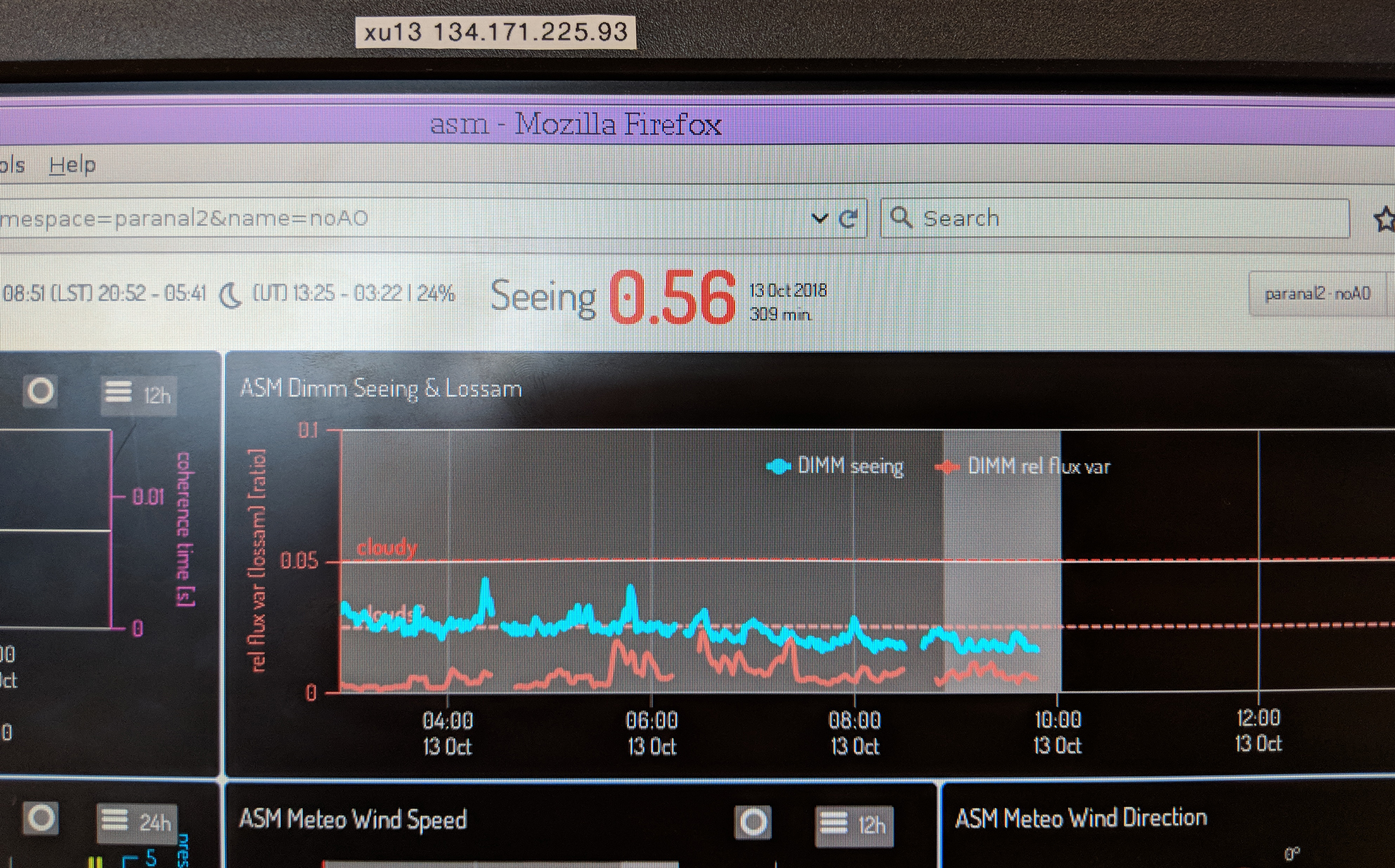

Regarding seeing, IMHO for a permanent site, a seeing monitor is a great idea. They are purpose built and keep track of trends graphically as well as being able (in most cases) to report to the ASCOM observing conditions hub so they tend to be more useful than using your primary instrument(s). There are a number of commercial units available from the spendy Alcor Cyclope to the more reasonable SBS SM3 and there may even be a few used old SBIG units out there. I still have an old SBIG unit at home that has been working for 15 + years! Of course we would all like this sort of seeing (note location at upper right).   |

Bill McLaughlin: Regarding seeing, IMHO for a permanent site, a seeing monitor is a great idea. They are purpose built and keep track of trends graphically as well as being able (in most cases) to report to the ASCOM observing conditions hub so they tend to be more useful than using your primary instrument(s). There are a number of commercial units available from the spendy Alcor Cyclope to the more reasonable SBS SM3 and there may even be a few used old SBIG units out there. I still have an old SBIG unit at home that has been working for 15 + years!
 Ohhh wow this is interesting Bill! While I never thought there was actually something like this for amateurs, I figured there was something for the big guys! So I’m intrigued now! I’ll have to look into this a bit as it would be kinda cool to have something like this in my observatory. Or maybe outside??? Dale

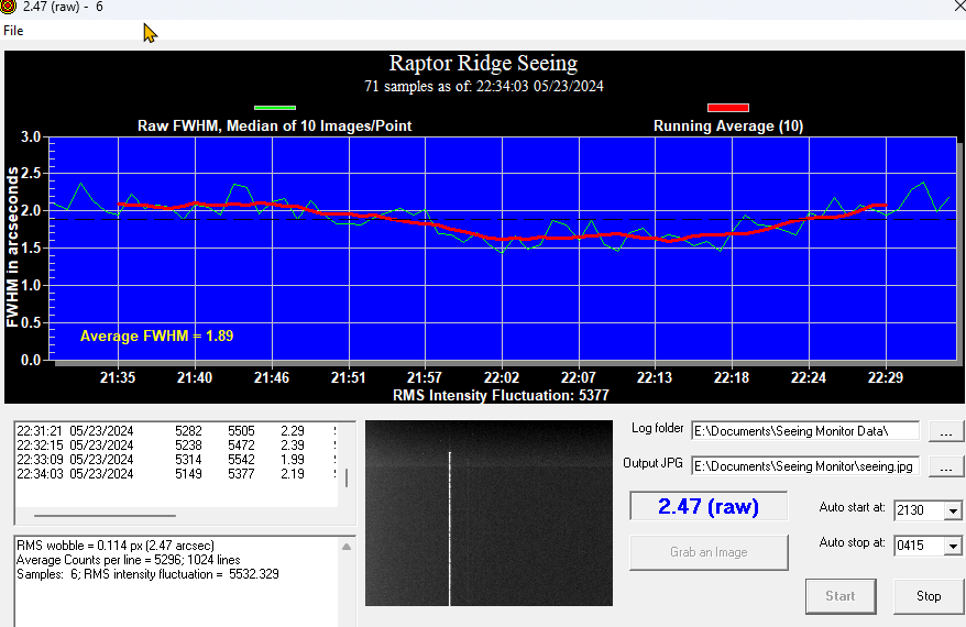

Dale Of course the image shown above is not from an amateur system. It was a snapshot I took of a monitor at the VLT in Chile during a walk thru the control room in 2018.  Amateur systems are typically mounted outside on a separate and very solid pier so as not to get any vibrations from other activities. Mine sits about 6 feet from the roll-off on a separate steel pier. Here is a snapshot from it from a few nights ago.  This is the from the old, no longer made, SBIG unit. The most commonly used these days is from Santa Barbara Scientific, owned by Alan Holmes, one of the owners/founders of SBIG before it was sold to Cyanogen. Link to his unit below. SBS and SM3These things are typically a tiny refractor tied to what is basically a guide camera and equipped with special software. They monitor the movement of Polaris so just need to have enough FOV that it stays on the chip all night and all year. The software adjusts for latitude so supposedly gives you the theoretical seeing at zenith. They are especially useful if one has a long and a short focal length system since they inform you as to which might be the better system for a given night and time. Here is A link to the monitor output from a SBS unit at my remote site, Skies Away Observatory in Ca. As you can see, the seeing was pretty decent there last night... SBS Monitor at SAROS |
