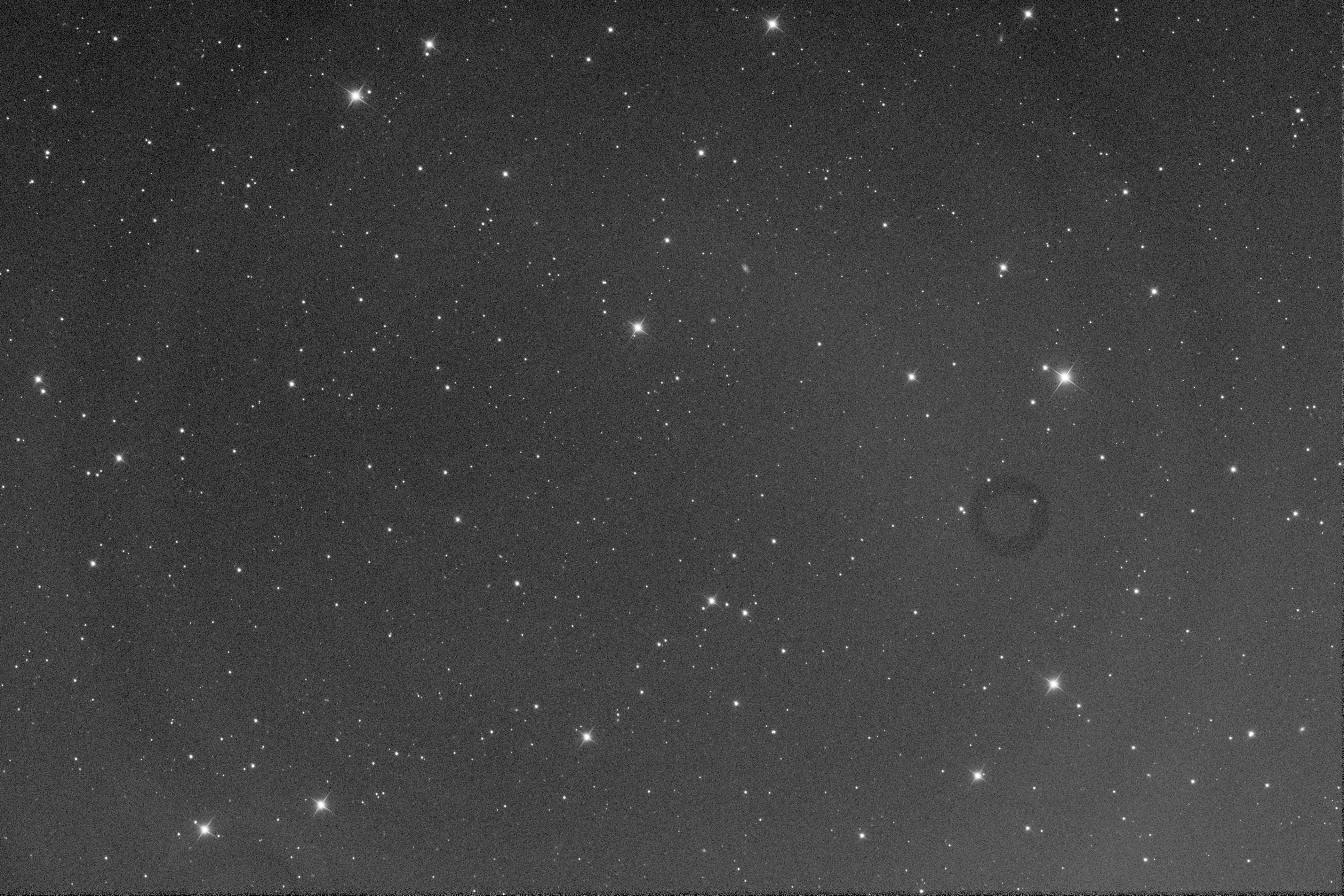

I have run into this very bizarre flat calibration issue in Pixinsight.
Just some background, I imaged a target with my Luminance filter on my 6200mm pro last night, 60s each frame, for a total of 250 frames, at gain 100, default ASIair offset (50), -5c, using the AG Optical Convergent FA12. I captured 30 flats using a Primalucelab Gitto 430mm flat field frame generator. I set the brightness of the flat panel to take 1.4s Luminance Flat frames to achieve just over 20000 ADUs.
I calibrate my flat frame with bias frames (being the shortest exposure possible for my 6200mm pro).
So after calibrating and stacking all 250 light frames in WBPP, I get this:
So multiple issues with this frame. There was undercalibration of the flat frame patterns. The second more strange issue is that not only was the dust mote on the right not calibrated out, but the dust mote on the left is something that did not exist at all in the light frames or the flat frame.
I really was sctratching my head, thinking maybe I got that dust later in the imaging session, but blinking through the images did not reveal that much. And then I realized, if I flip flat frame 180 degrees, the same dust mote on the right falls exactly in position of that *new* non existent dust mote on the left.

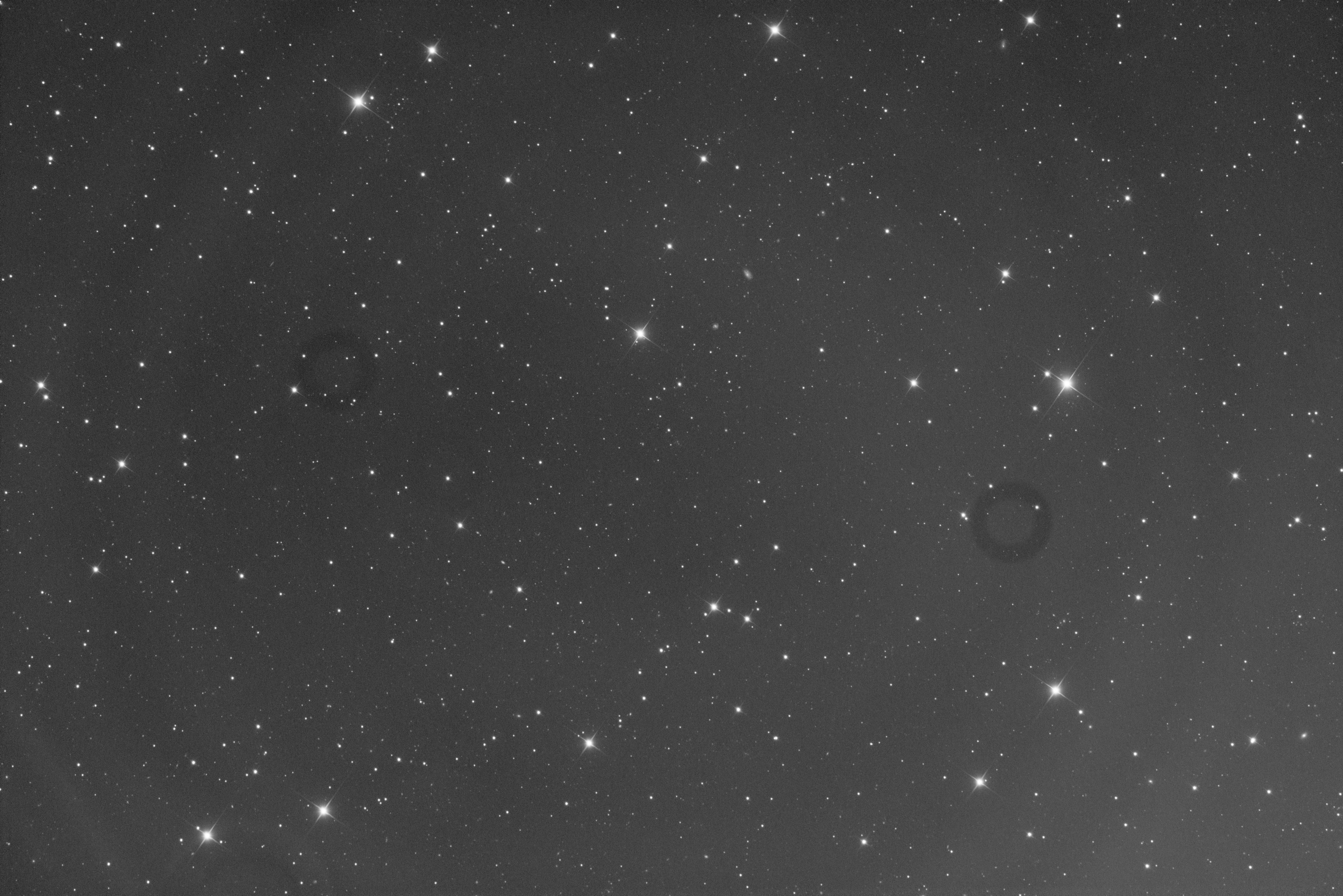

I then further looked into this. My imaging session of 250 frames, had 184 frames before the meridian flip, and 66 frames after the meridian flip. My theory was that the flat frame calibrated in the wrong orientation for the second half of the light frames, or something to that effect. To test that out, I just stacked the calibrated first 184 frames before the meridian flip seprately. This was the result:
The image is still under corrected. The large ring artifacts are still present, but the dust mote that was created to the left upper corner completely disappeared.

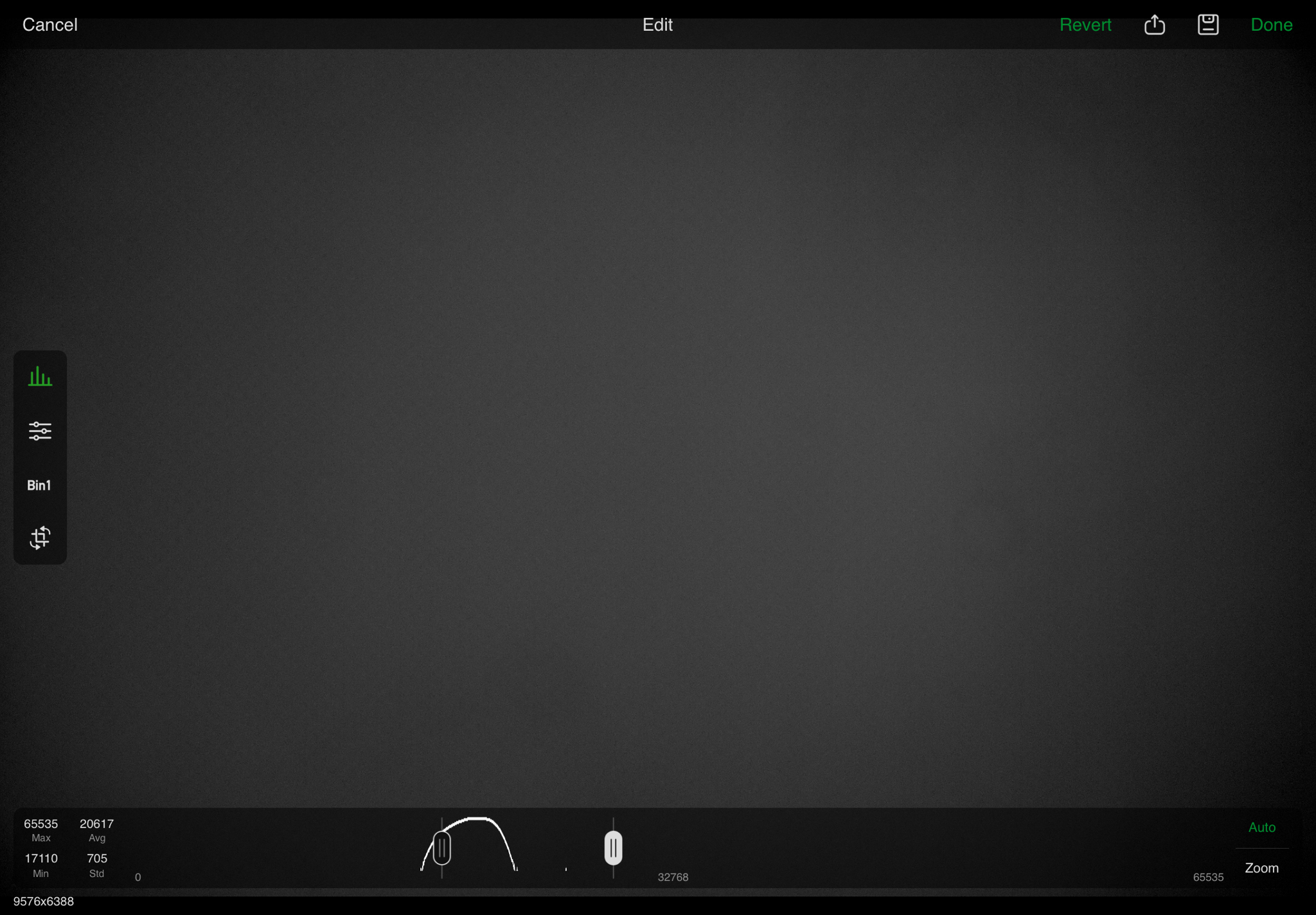

I have now taken flat darks to match my L 1.4s flats, and will try to stack and calibrate with WBPP again to see if it will fix the undercorrection, but at this point I do not have any faith in what is going on with my flats.
Any idea what the problem is here?

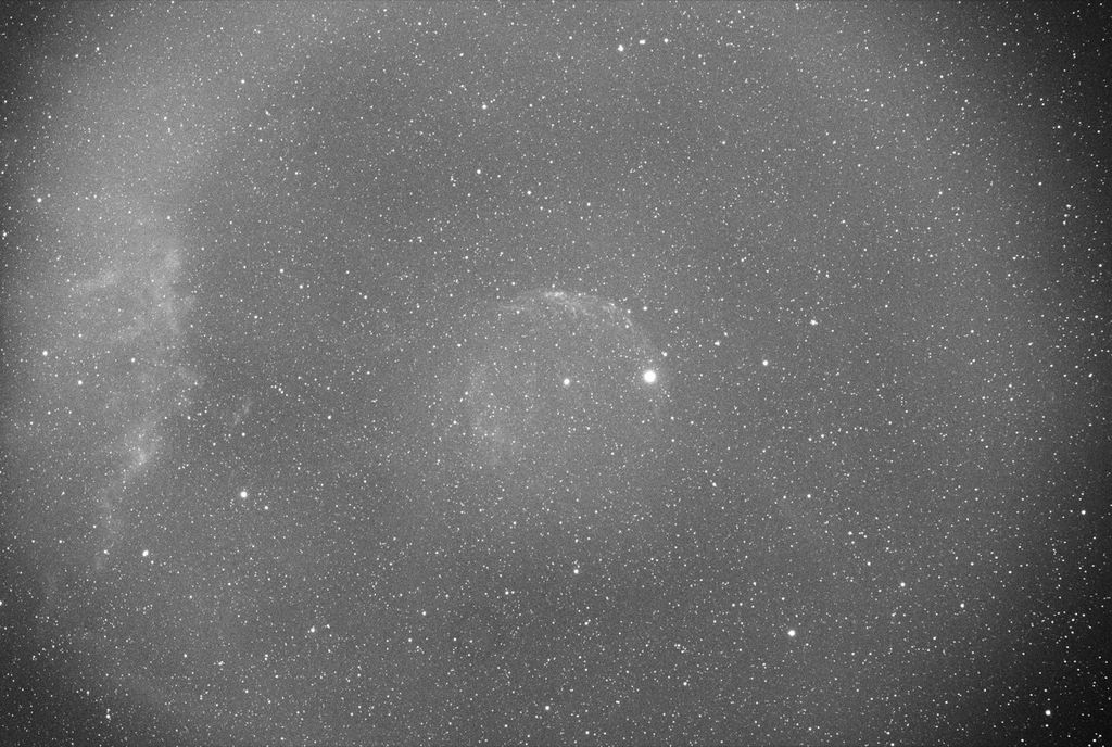

Hello, I have the same problem as you regarding halos. I don't understand what you mean by saying that the image is not sufficiently corrected. Can you explain it to me? How do you correct it?
I attach a shot of 600s Ha of the Dolphin Head Nebula (SH2-308) taken from my house, in Malaga Capital, with a bortle of 8-9.
You can see the kind of donut in the photo that I cannot remove with processing.

This looks like faint, diffuse internal reflections. The concentric rings, could be things within your image train, potentially even within the scope, that are reflecting light onto the sensor. It could either be oblique angles and non-blackened edges somewhere, or might be some reflection deeper in the image train, bouncing back out the scope, then off of something else and back to the sensor.
If you take the camera off, and look through the scope from the camera's perspective, with the pupil brightly illuminated…do you see anything reflecting. It may not be bright, but if anything shows up, it might be contributing to the problem. Someone recently had a similar problem and started a thread on CN. They did some blackening of some of their image train, and resolved some of the issues. They may still have some reflections from within the scope.

OP and other affected people, do me a favor. Take sky flats. The ring pattern will go away. The problem isn't with your optics, it is with the panel you use to take flats being unable to illuminate properly to capture the effect you see there.
If you need a method to do this, both NINA and Voyager have automated sky flat routines. You do not need to go outside with T-shirts or any of that. Just set it up to capture the sky flats either before or after your imaging session.
Once you do this and test this, come back and let me know. Also, stop using panels. They are nowhere near as good as the sky. Trust me on this one.
