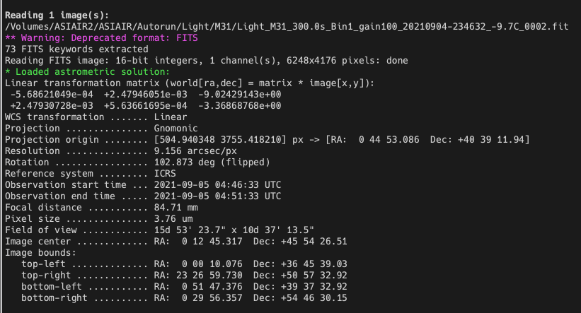

To provide some details here is a sample (below)  of what the FITS data provides of a sample image (5 min, Stellarvue triplet 70 mm, 2600 MC).
I thought of trying to use spectrophotometric calibration in PI, but am guessing thats not going to work.
Thanks in advance.
Ian
Data on the image sub:

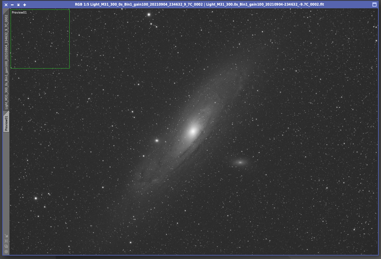

And here is a single 5 minute sub... stretched but nothing else done, to show you what I'm dealing with.

You should check out the debayer process. From what I can see on the screenshot you have a debayer grid, so it should be useable. If auto does not work, try RGGB.
You should be able to stack all the frames however you usually do it, then debayer the stack and go from there.

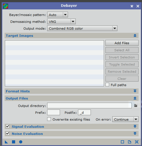

It worked,  thanks so much!
I'm not sure why this particular data needed this extra step but am very happy that I posted the question here.
Below is the same 5 minute sub... debayered using the automatic mode.  Its not perfect but I can go back and reprocess everything with colour.

Debayered result, single 5 minute sub, stretched with no calibration of any kind:
I can see various star colours now... should be good to go.

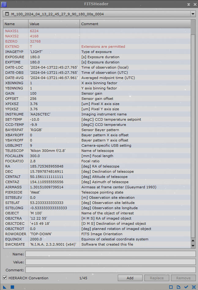

I can't see it being a Bayer matrix at all. And certainly the fits info displayed at reading doesn't tell that. One thing for sure is that the focal length is wrong. Only FITSHeader will tell you that:
