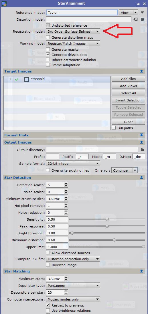

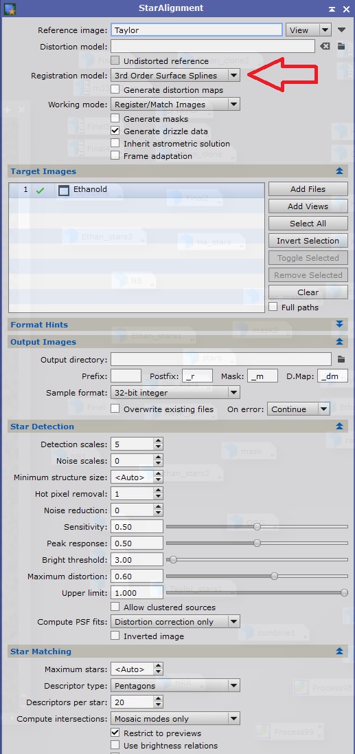

Thank you both so much. That really was what I was missing. I didn't really know about the different registration models and the surface spline options did the trick. Gonna experiment to see which looks the best but this resolves my major problem.
For future onlookers in case this comes up. That is changed here in the star alignment tool.preview.jpg
