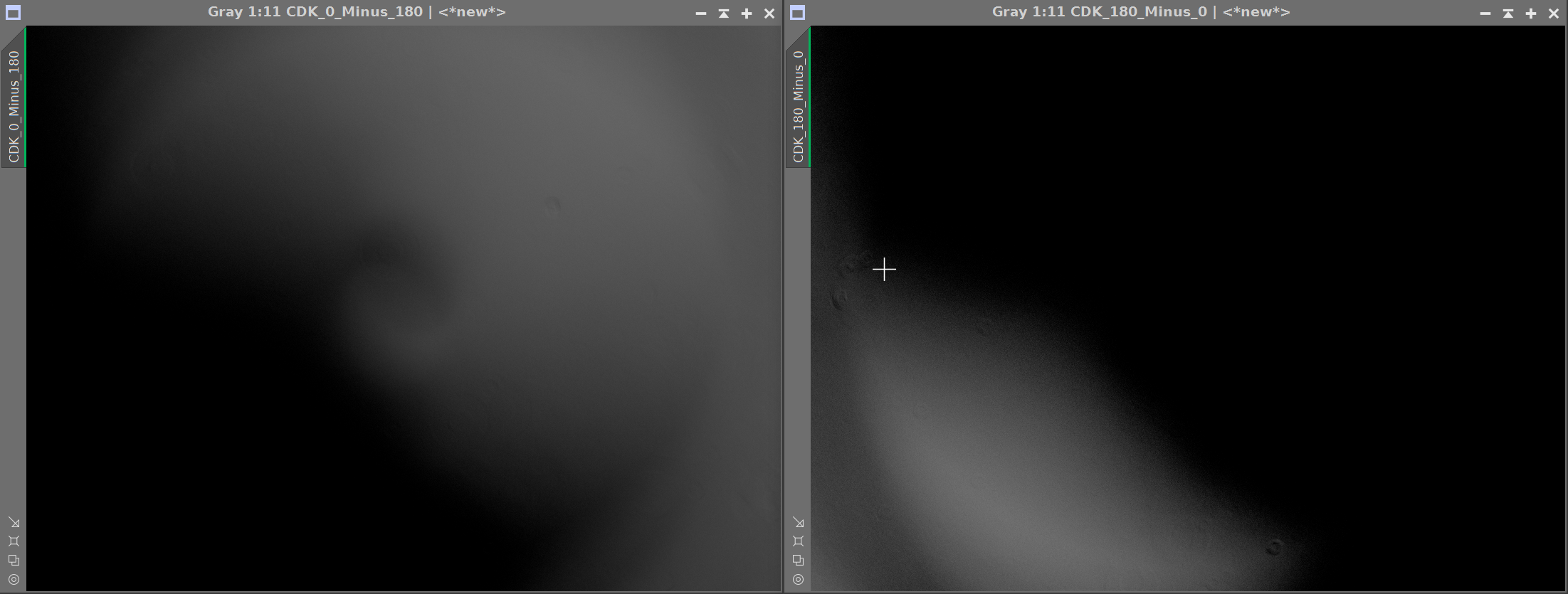

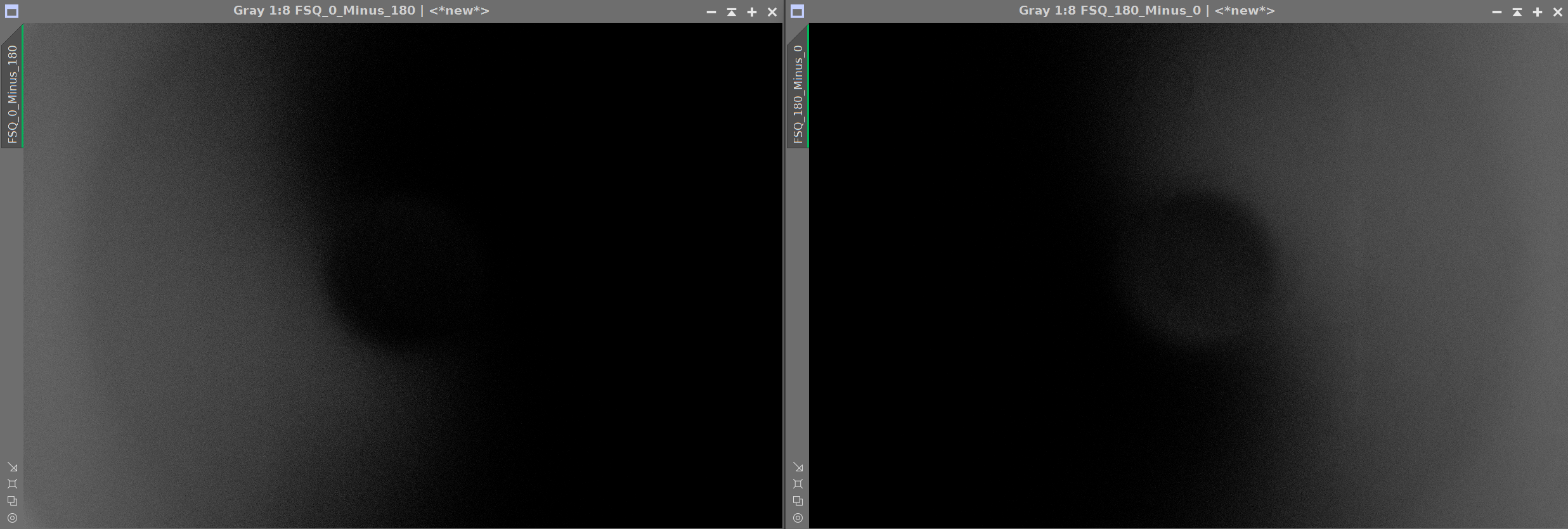

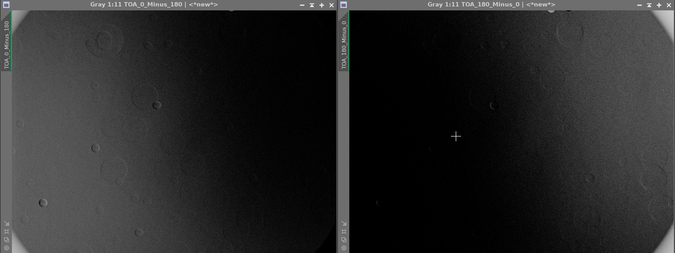

Okay, @Kevin Morefield -- once again you have identified one of my issues and proposed a solution whether I like it or not. I ran the test you suggested on all three scopes and the results were telling. In each case, I subtracted the 180-degree master flat from the 0-degree master flat and vice versa. Here are the results.
FSQ106
TOA130

So from now on, I'll be taking flats for each unique rotation angle. I'm not at all thrilled about it, but it has to be done. Fortunately, I can automate that in NINA with some generic code in my main template. So that's not a hassle at all. But managing an additional 210 404MB files (84GB) for each rotation angle will be no fun. I'll have to work out a system for that.

CDK12
Sorry Timothy - are those flat panel flats?
Yes. All three PrimaLuce Giottos. I was surprised at how bad this issue is--especially on the TOA, which I always thought was giving me pristine results.

Glad to be of any help at all!  Did you check the magnitude of the differences?  Maybe take the brightest spot you see on these difference and divide by (65535/2) to get the magnitude of the error that might occur.
