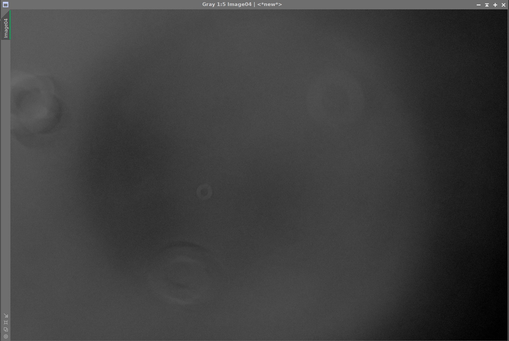

Kevin Morefield:
Please try it out and let me know what you see.
I will. Looks like I'll have a chance to try it tomorrow. I may have to do 0 and 90 since I've limited my rotators to 0-180. I'll try the luminance filter first.

Timothy Martin:
Kevin Morefield:
That should catch it if it's there but I think 0 and 179 would produce the biggest difference.  Here's my 0 and 159 for example (didn't have 180 handy):
If you get a black result when you subtract one from the other just reverse the equation.

whwang 15.16
Kevin Morefield:
I didn’t use rotation matched flats for years.  But after advent of the new more sensitive, low noise cameras and going deep in faint objects, I started seeing odd circular gradients. I ran flats at 0 and 180, subtracted one from the other and voila - the same circle appeared. After testing rotation matched flats the circular gradient was resolved.  I believe this is coming mostly from the  central obstruction on the CDK17 but I’m testing it on my refractor too.
The solution is flats for each object, not each night thankfully.
Kevin
I take flats for each rotation angle.  The case for my CDK 20 is that the illumination center is offset from the camera rotation axis substantially.  In my flat, it's obvious that the brightest spot is not at the center of the image, and it shifts after a camera rotation.  Maybe your CDK17 also has this, but not as apparent as mine (so it only shows up after dividing an unmatched flat).
morefield 12.31
Wei-Hao Wang:
Kevin Morefield:
Kevin
Yes, I'm sure that's it Wei-Hao.  I'm also somewhat concerned that shooting sky flats could have a very slight gradient.  I'd like to test sky vs. flat panel but I don't have one available in Chile.

whwang 15.16
Kevin Morefield:
Twilight sky should always have some gradient built in.  However, if that gradient is in the flat, its inverse will equally exist in every calibrated sub, so it should not impact any processes during registration and stacking.  For the FoV of CDKs, the gradient in sky should be quite linear.  So it should not add additional difficulty to the final gradient removal.  So although I always worry about it, in practice I have found no cases where I can say for sure that the gradient in sky flat had any real impact in the final results.
We also have a flat panel in our telescope enclosure.  Unfortunately the width of the panel is only about 10% wider than the frame of CDK20.  So I kind of suspect that it's not large enough.  So I only use it for situations where twilight flat is not possible.

What you said is quite reasonable.  I said I take flats for each rotation angle.  This is because I rarely use rotation angles other than 0 and 90 degrees.  I try as much as possible to fix my framing exactly east-west or north-south.  If you are doing wide-field mosaics with many different rotation angles, then it obviously will be very tedious if you take flats for every angle, and I doubt whether that's necessary.  You may try taking flat every 1 or 2 degrees and see how it works.

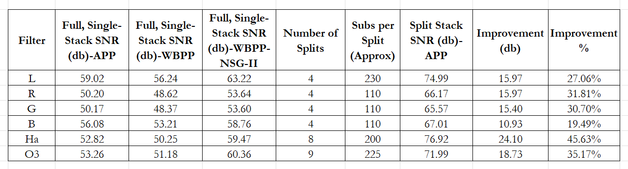

Timothy Martin:
Recently, I've completed capture on a single frame with more than 400 hours of acquisition time--my longest ever, obtained only after suffering the pain equivalent to delivering a breach birth. It's a project I started in 2024, when I got 50 hours of data, and then completed this year by slogging through another 350 hours of data starting in January. 5808 subs for all filters. Here are the basic stats:
When I stacked the entire image, the results were less than pleasing. For example, using the Image Analysis-->SNR script in PI, the Ha master came up with an SNR of 53.38db. The Ha stack from last year, about 10 hours of Ha, came up with an SNR of 61.2. Results from all the other filter masters were very similar. The 10 hours of Ha from last year not only had a higher SNR, but also it just looked better and processed better than the 128 hours of data I bled for.
Okay, maybe I had some bad data in those 1546 Ha subs that I missed somehow with Blink and Subframe Selector. That's simply not the case, and here's how I know: I split the data up into chunks of 150 to 200 subs and stacked those chunks separately--eight of them. They each had an SNR of 75+ and all of them looked way better than the full stack of 1546 subs.
(Please note that I did both the full stack and the split stacks in both APP and WBPP. The results were very consistent)
After I stacked the 8 chunks of Ha data into 8 masters, I then stacked those 8 masters using PI's ImageIntegration process. The result was effing spectacular. An SNR of 89.66--and it looks like a million dollars--exactly what I was hoping for. I started processing it and was astounded at how much better it was than the full stack of 1546 subs.
(Again, these results were basically the same in both APP and WBPP)
So my question is: WTF?
Or better still: W. T. Holy. F?
Note: I'm sorry I can't share screen shots or raw files here. The image isn't finished and I don't want to disclose anything about what it is yet. So you'll have to trust me on these numbers and descriptions. But any insights could be helpful.
Without knowing anything at all about the stacking algorithms or the math involved, here are my theories--none of which I'm very confident in.
1. Somehow Mabula and the PI team both failed to account for extreme integration times and their algorithms simply aren't robust enough to handle such things
2. Somehow weighting is playing a role--perhaps weighting lesser quality data over higher quality data when enough lesser quality data is there
3. Rejection algorithms are playing an unexpected role over a very large sample size
All I know is that splitting this project up into ~200-sub stacks and then stacking the results of those chunks creates vastly--vastly superior results. I haven't been this discombobulated since November 5th. Please explain this to me if you can. If no one knows, then I'm just going to change my pre-processing workflow to stacking in chunks of no more than 250 subs, which will be a giant PITA.

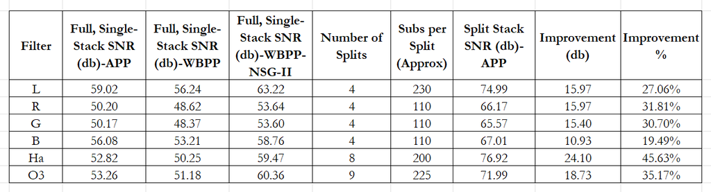

I've finished working this issue just about every which way I can. I did (1) a full stack of all subs for all channels using AstroPixelProcessor (APP), (2) a full stack of all subs for all channels using WBPP, (3) a full integration of all subs for all channels using PI's ImageIntegration after spending a mind-numbing number of hours with Normalize Scale Gradient (NSG), and (4) I split the integration into chunks using APP and then stacked the resulting masters to produce final channel masters with PI's ImageIntegration (with rejection turned off). I then ran the SNR script on all the final masters generated from this mess and put those results in a spreadsheet:
The results were a bit surprising to me. Mostly I was struck by the 5%-ish loss in quality going from APP to WBPP. I ran some comparisons a couple of years ago before WBPP had Local Normalization Correction (LNC) and determined that I was getting better quality stacks out of APP. I hadn't really done much with WBPP since, having settled into habit. I'm a bit surprised to see that while the gap has narrowed, at least in this example, the addition of LNC hasn't completely closed that gap.
I'll note that while NSG did produce the best results of the full stack sets, it was still nowhere near the split-stack results. Some of that--but probably not all of it--is the result of having a loose nut behind the wheel. This was my very first foray into NSG, so I'm sure I'm not doing it in the best possible way. I just followed John Murphy's five-part tutorial as best I could.
There are two obvious paths here I have yet to go down. First, I did not use WBPP to produce the split stacks. And second, I did not use WBPP in combination with NSG to produce the split stacks. I'll save that for a rainy week. I felt like the results I got from the APP split stacks were pretty darn good, so I stopped there for now. I do have a life outside astrophotography. I generally loathe the APP user interface and find WBPP to be much easier to use--but when you put NSG into the mix, the scale tips hard back the other way. These extreme integration times are not something I can and will do very often, so it might well be worth the trouble.
I'm still finalizing the image, so I'll post it later today or tomorrow.
The bottom line here is that I think I've found a new tool to put in my arsenal. But it's no panacea. I used the same approach on another image I just finished capturing. That image was only ~130 hours total with ~90 hours of Ha captured over the last two months. I used the split method on the Ha. That result actually turned out worse than the single, full stack. This leads me to believe that the split approach likely works best when data capture is spread out over many months or even years--probably because stacking in contemporaneous chunks allows LNC to function better. I have another image I'm capturing that just passed 350 hours heading to 400 that I can try this on in a month or two. It'll be interesting to see what happens there.
I do still plan to execute the flat exercise @Kevin Morefield recommended. But note that it's not relevant here because all the flats for this image were taken at 0-degrees sky rotation, which is the same rotation angle as the image in question.
