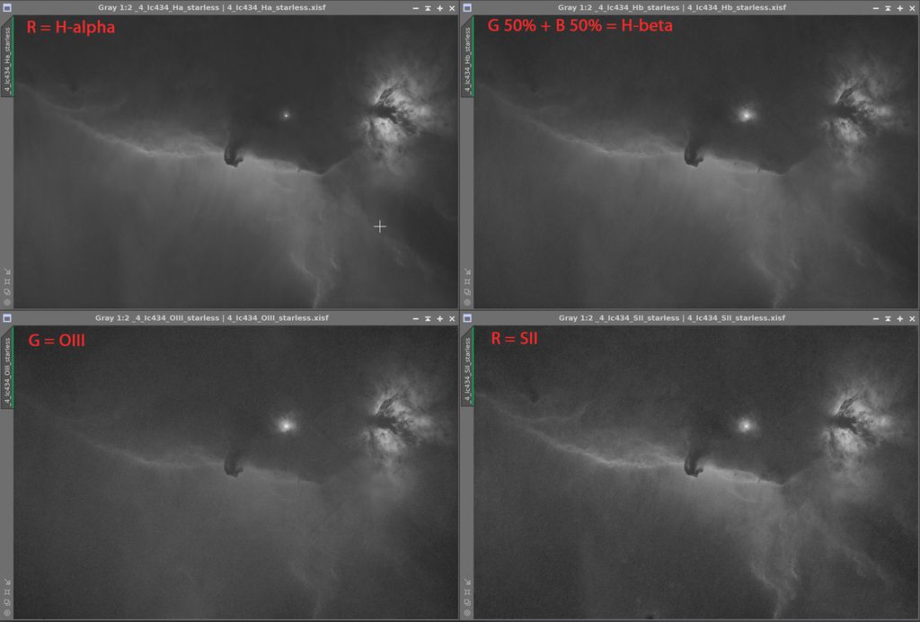

By splitting the RGB channels of the two dual bands, I created these mono images assuming: 1) H-alpha is only the RED channel of the Ha.OIII dual band, 2) OIII is the GREEN channel of the Ha.OIII dual band, 3) H-beta is a 50-50 blend of the GREEN and BLUE channels of the Hb.SII dual band, 4) SII is the RED channel of the Hb.SII dual band. Monos below are just scren stretched and were combined with different palettes/scripts to get the above images. Of course, by splitting a dual band OSC into the single narrow bands we don't get a "pure" narrow band signal as if shooting with mono cameras and dedicated filters, but the tecnique has the advantage of reducing the overall exposure times.
