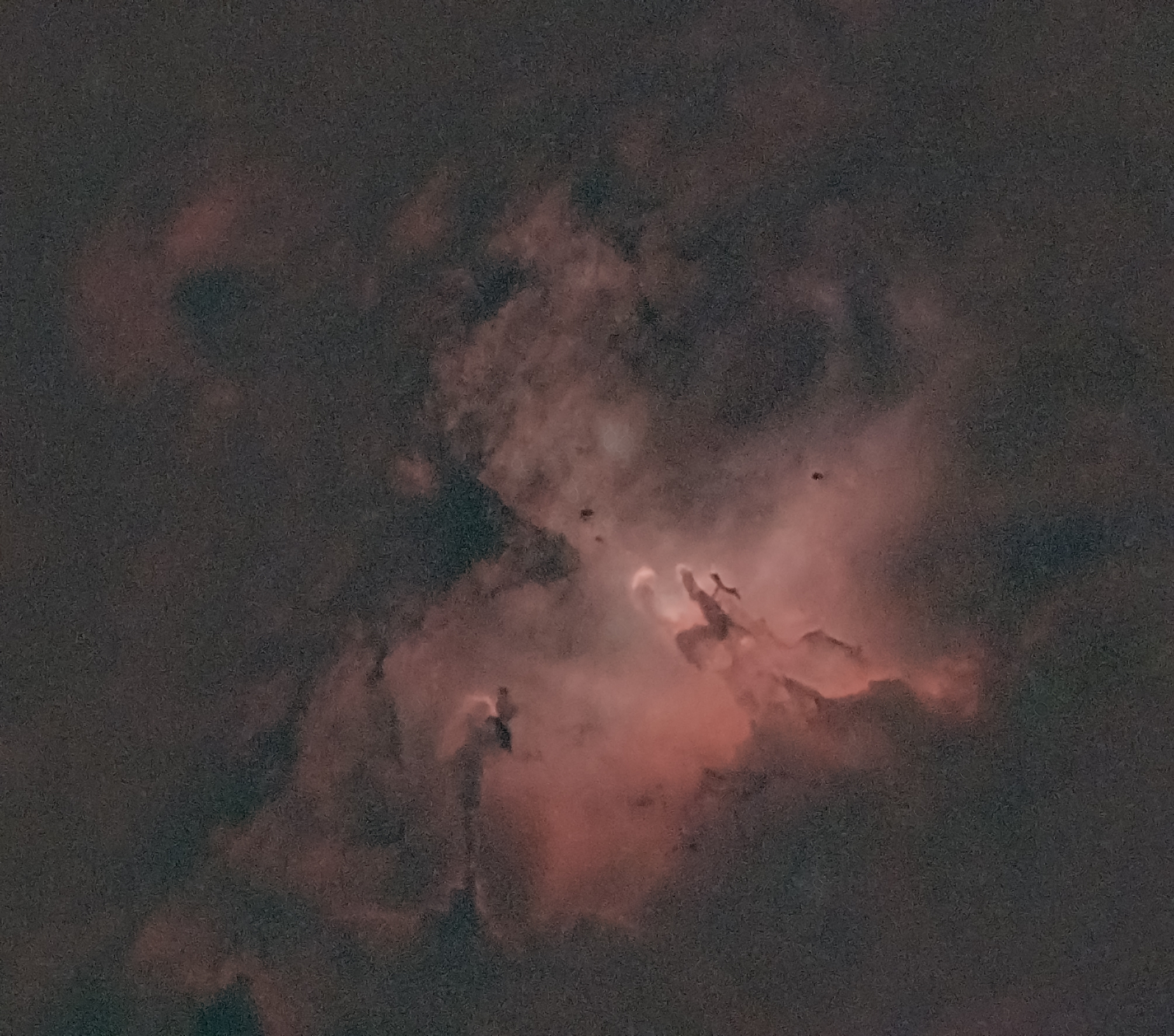

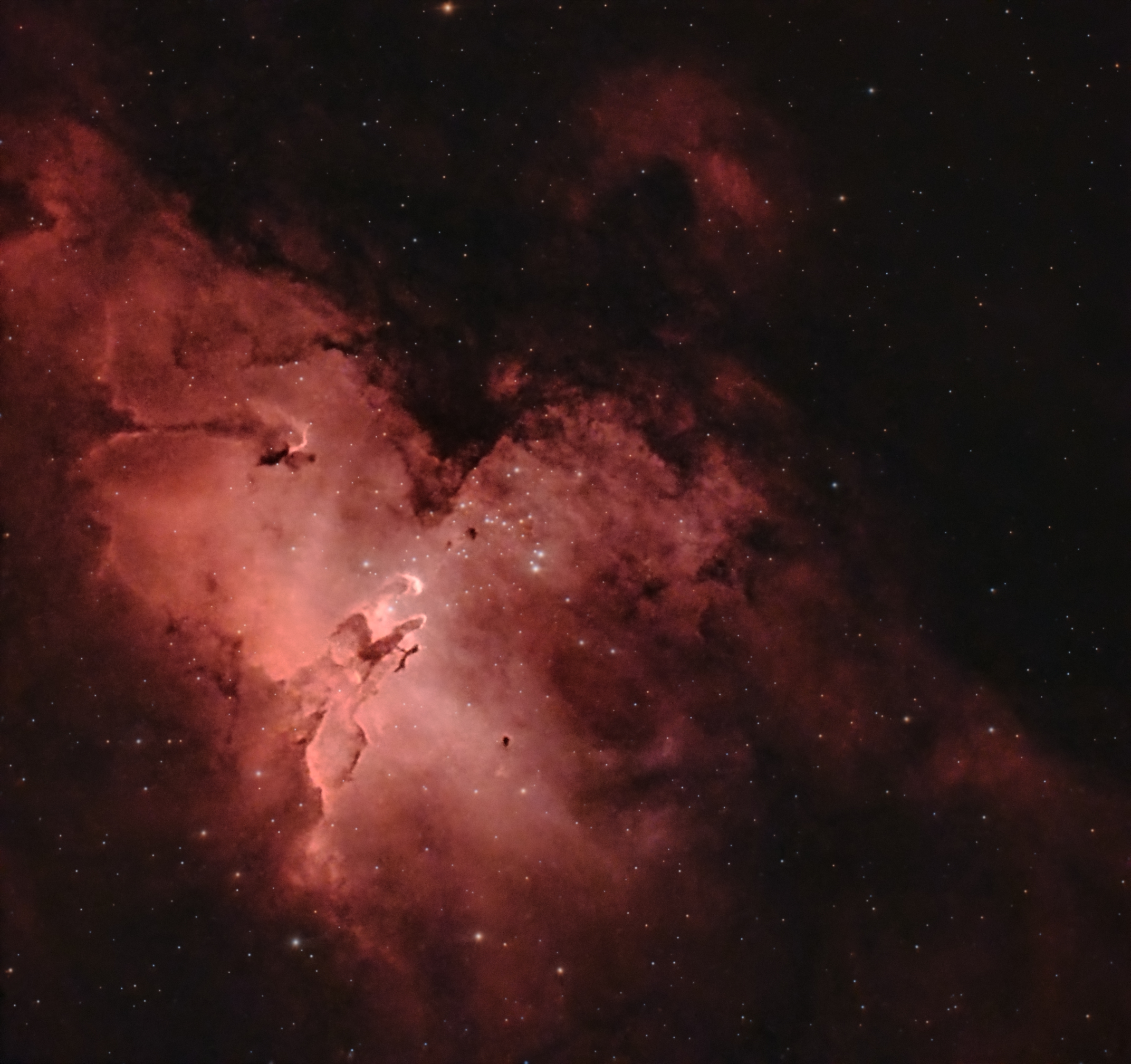

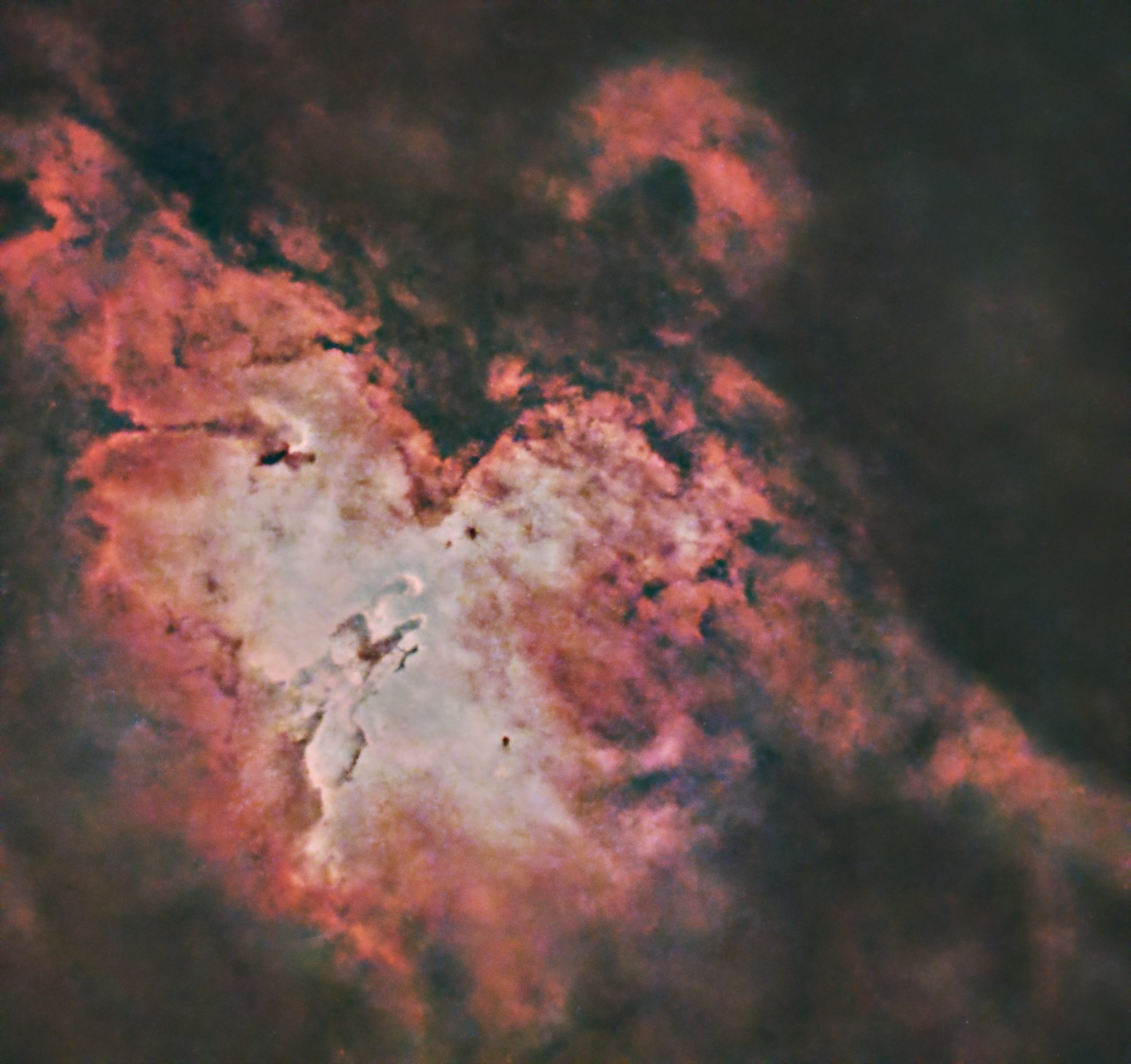

Nevermind, looking at your account it seemed to be 800ish. Here's the resultm16a.jpg

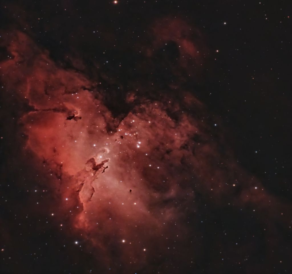

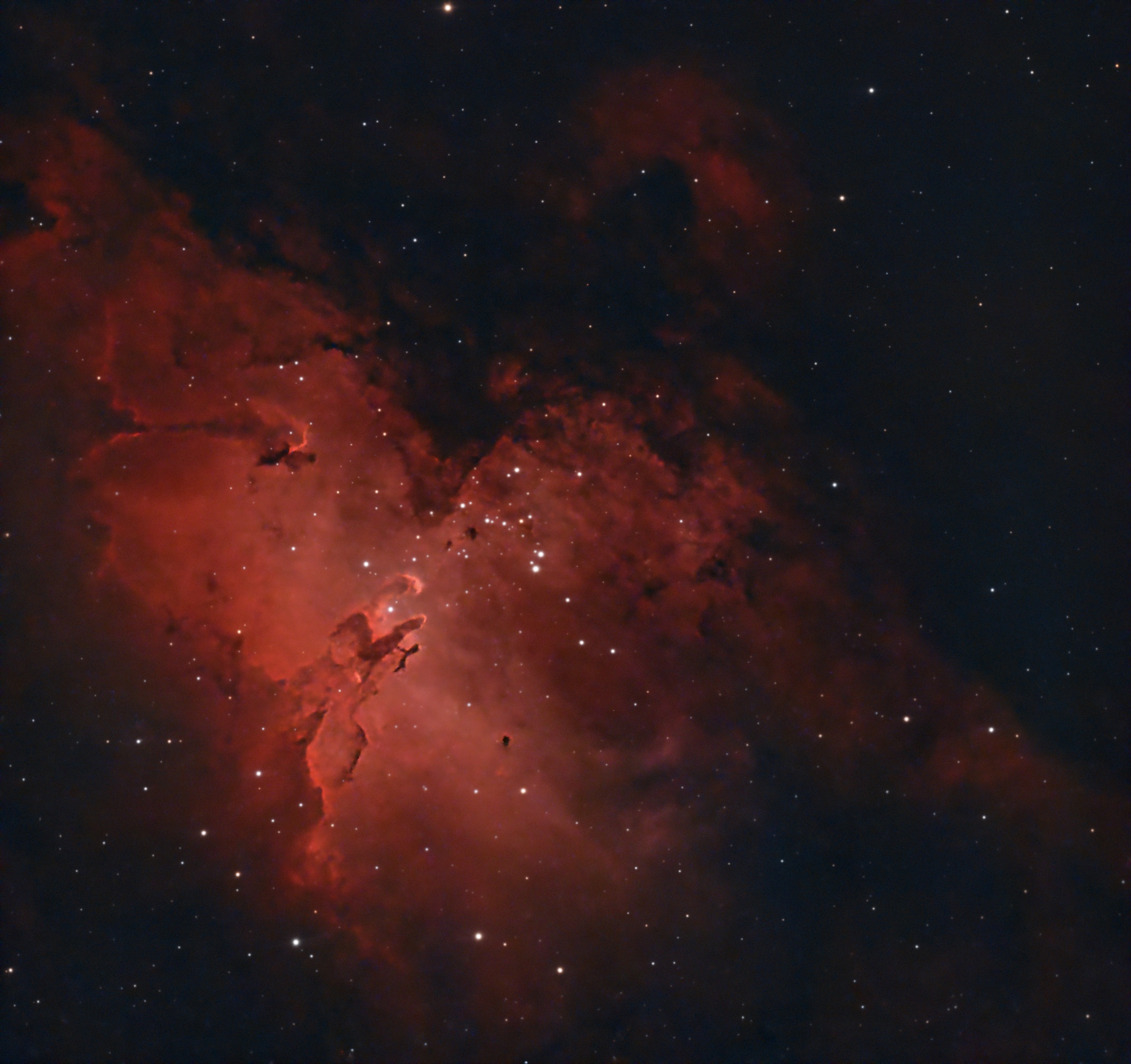

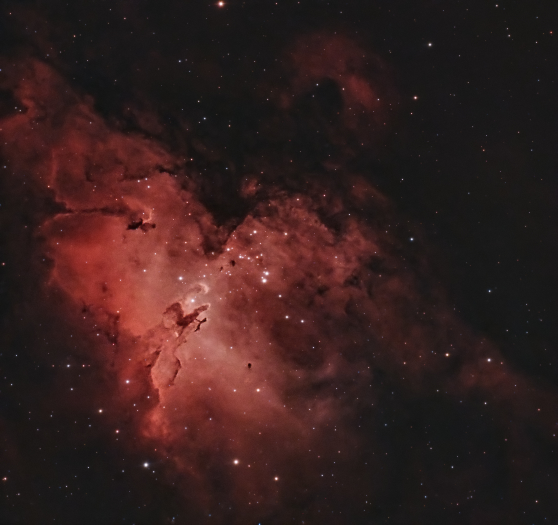

my version, workflow in pixinsight
- dynamic crop
-  Gradient correction
- image solve (I uploaded it to nova astrometry to have hints)
- photometriccolorcalibration
- blurxterminator
- starxterminator
  - I kept starts from an ez "soft stretched" image clone of the original
- noisexterminator
- histogram transformation (stretch)
- noisexterminator
- histogram transformation (remove black point)
- curves transformation (the "S")
- local histogram transformation (with mask) at 64px
- local histogram transformation (with mask) at 256px
- unsharp mask (with range selection mask)
- noisexterminator
- pixel math (stars back to image)
- curves transformation (increased saturation)

The one M16 to rule them all.
My own data with similar filter always turns out like the other red ones. Now you're forcing me to try again, again. With no pixinsight, though I can transpose most of your workflow with a couple of substitutions.

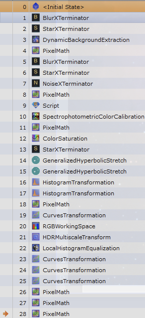

AstroTrucker 6.22

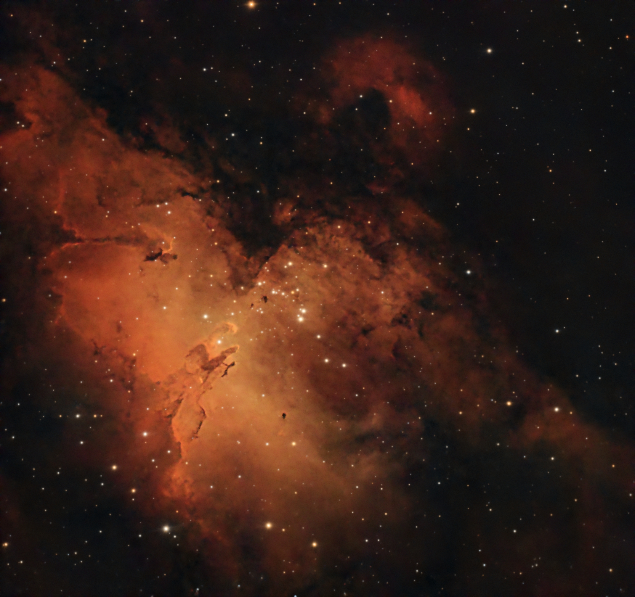

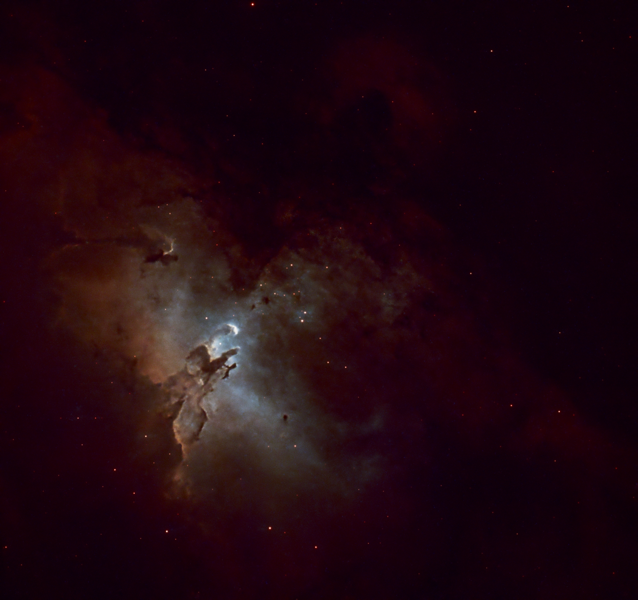

This is my take on the data. I decided to leave it a straight up RGB and focus on the stars and background. I didn't go completely black on the background. This is such a gas rich region I wanted to tease that there is something just below the surface... I used my standard RGB workflow and selected the Antlia ALP-T filter in SPCC in PI. BXT, SXT, and NXT were used. Stars were separated while image was linear and processed separately.

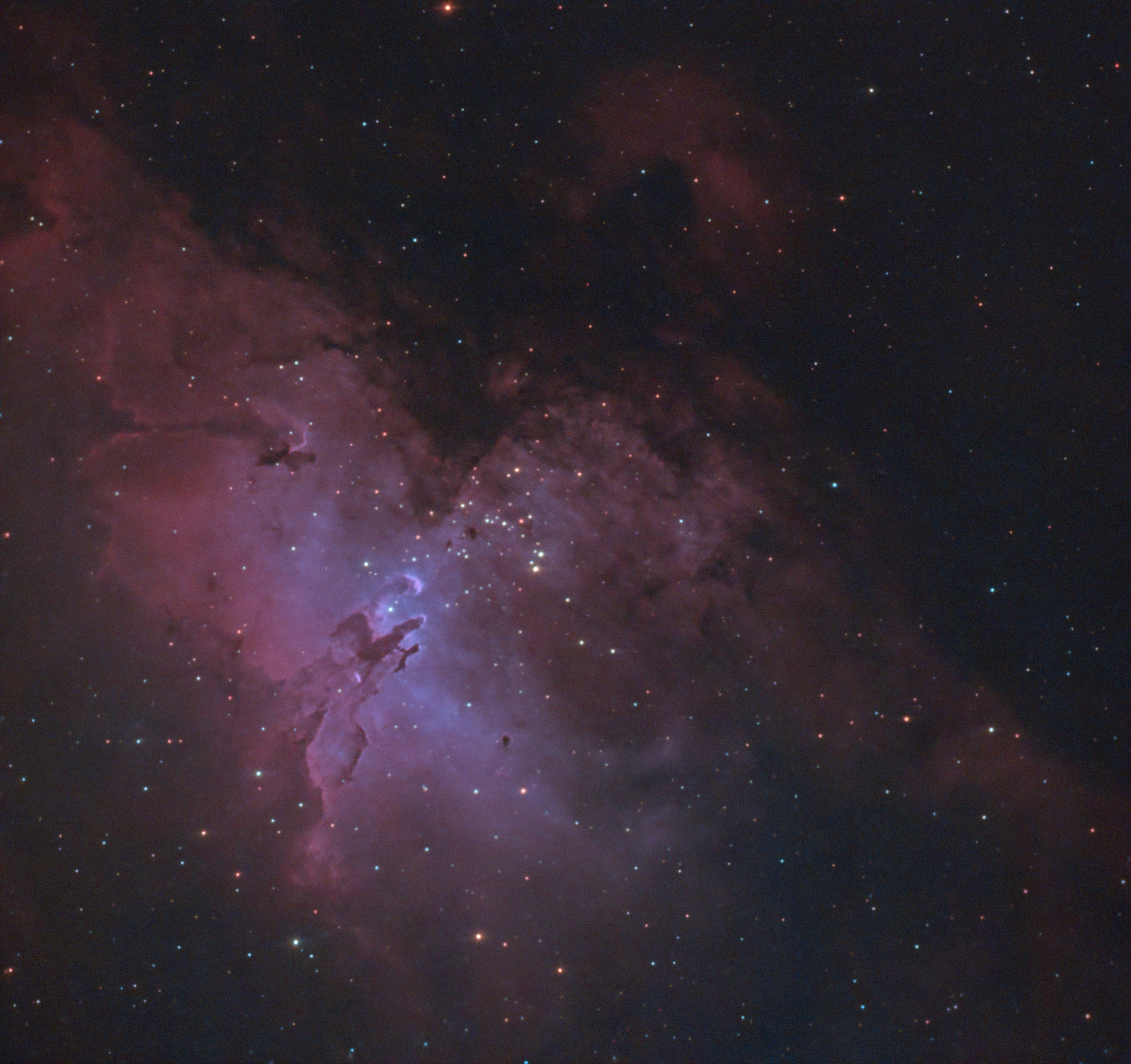

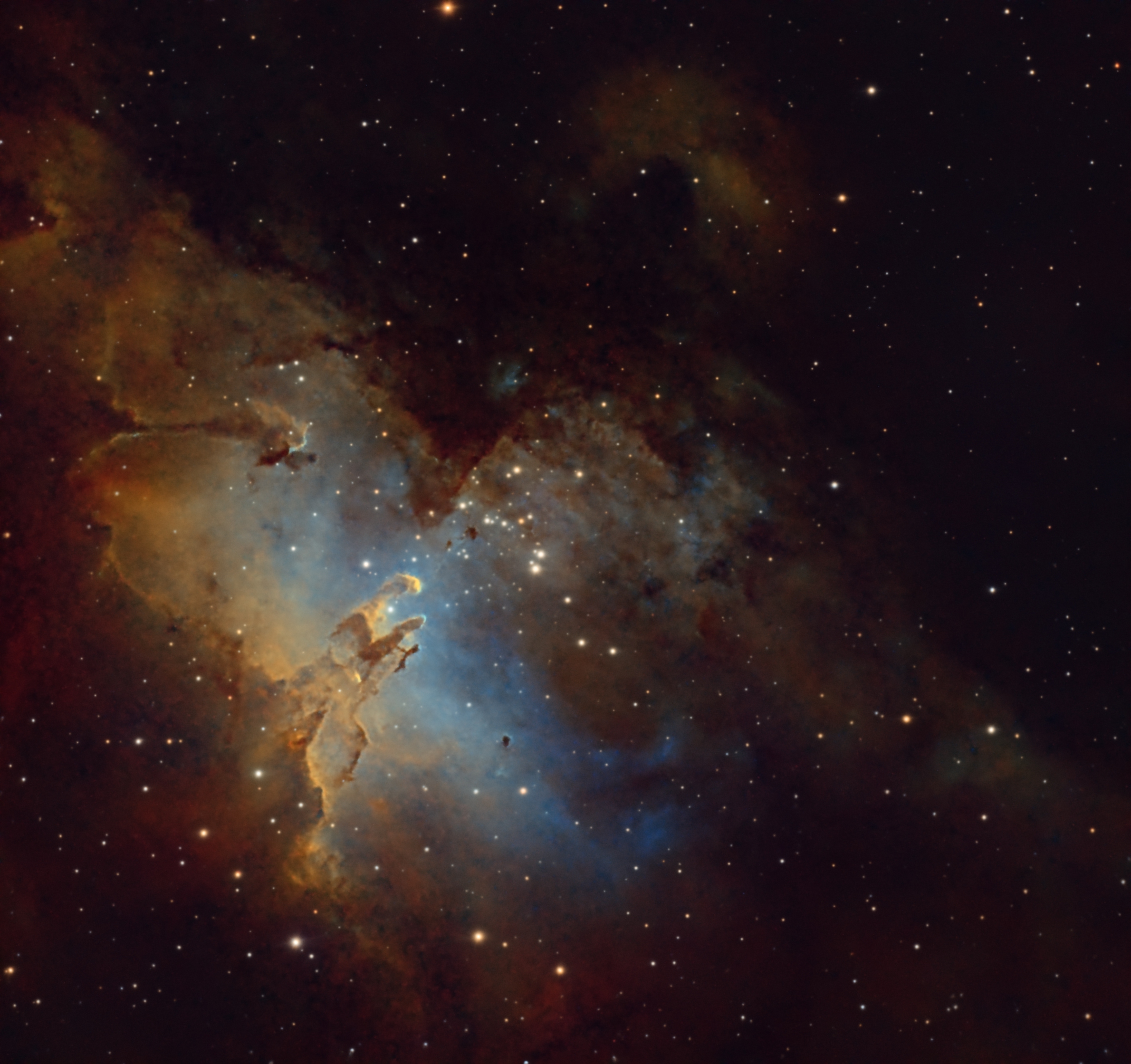

If you are after a more colorful image, the best way is to add Sii data. This is a quick'n dirty edit with your HOO data and my own Sii data.

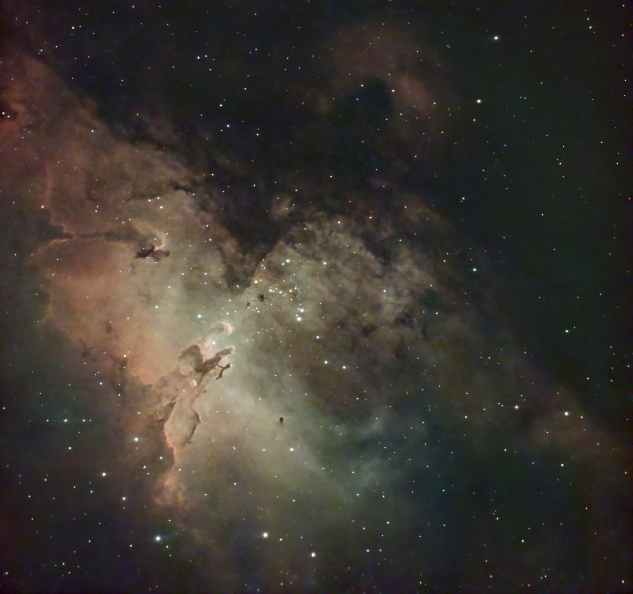

Taras_M 2.39

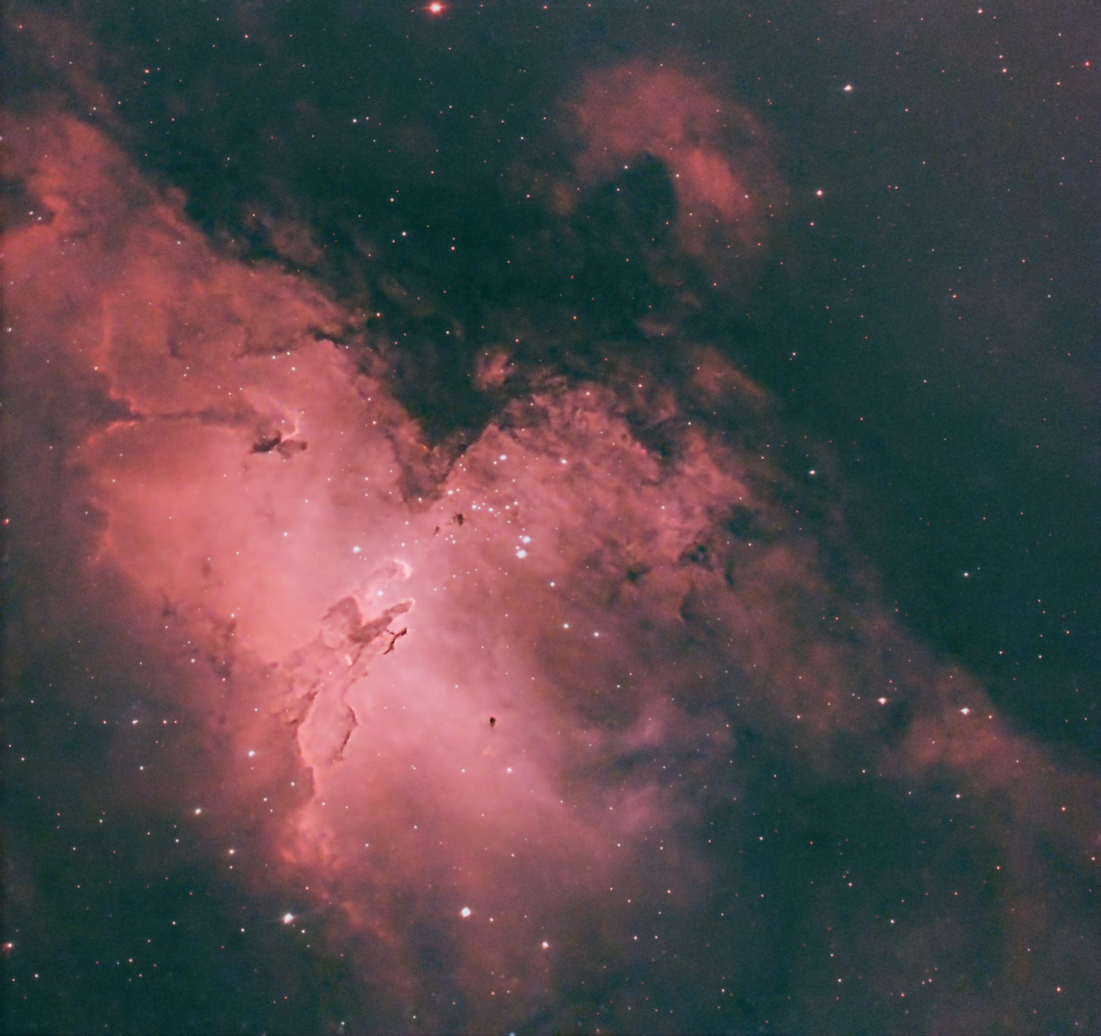

Im getting something like this:
And the processing path:
CS Taras

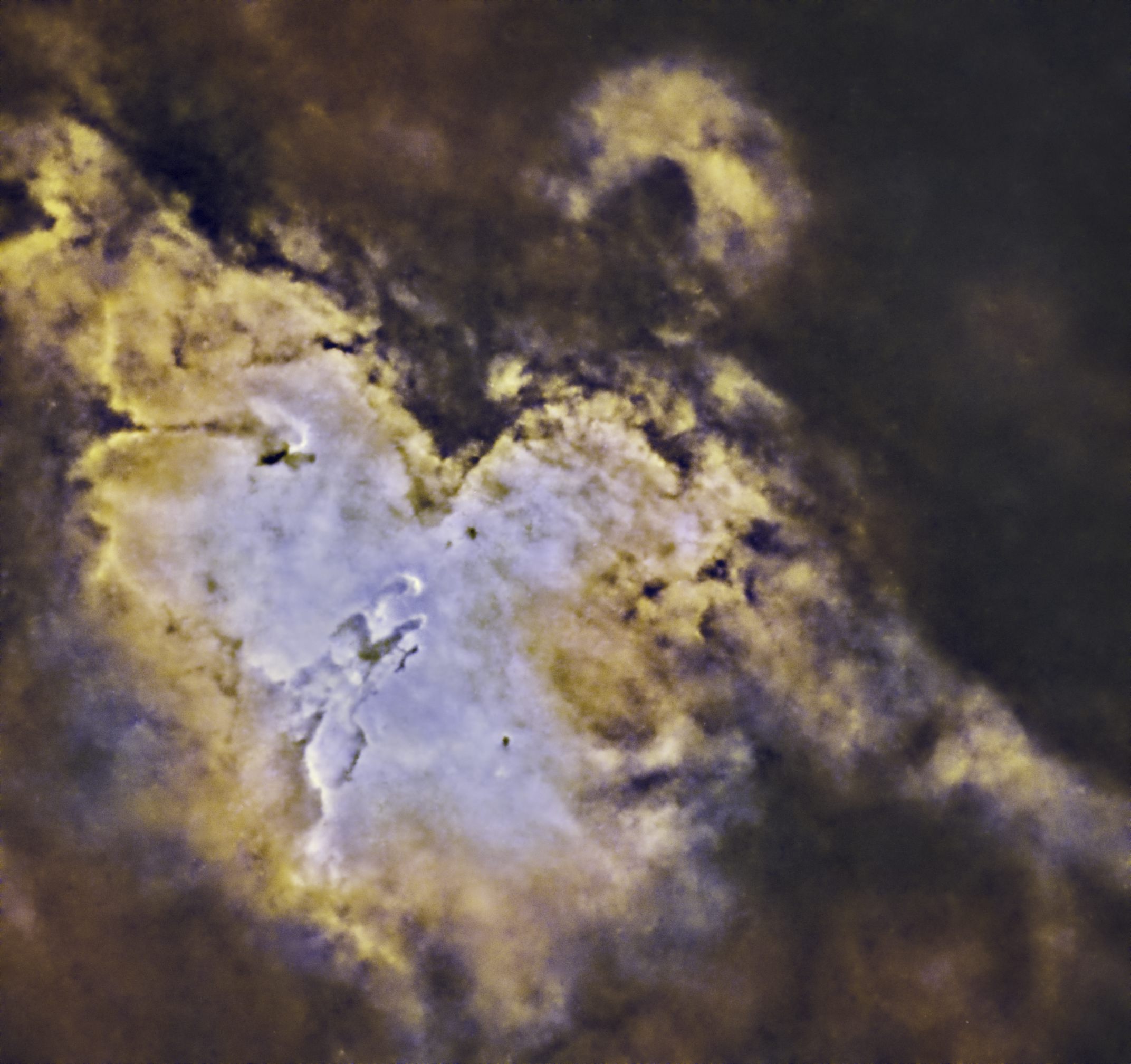

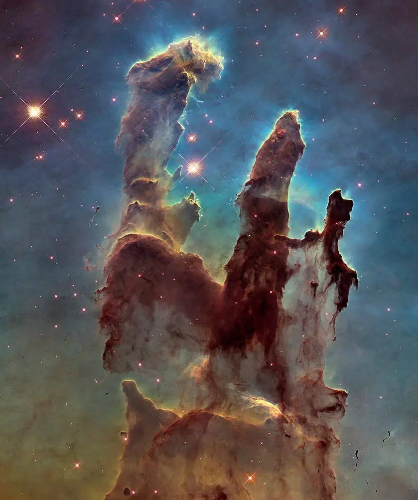

Hello, I made your data look like Hubble
and I didn't add any SII or anything other than what was in your data
this is your data:
this is Hubble:
I used some made up masking techniques and narrowbandnormalization also, and a careful eye, of course
