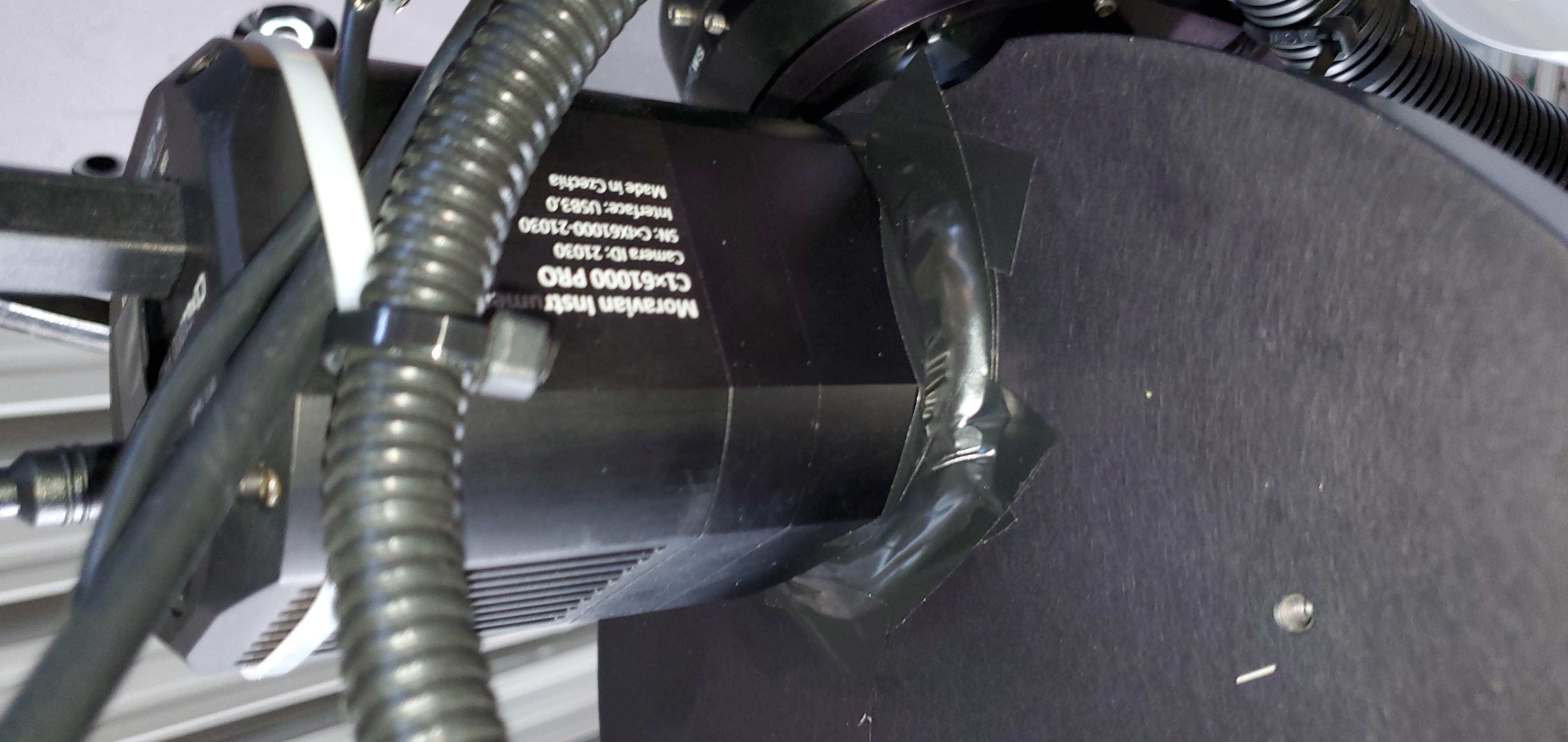

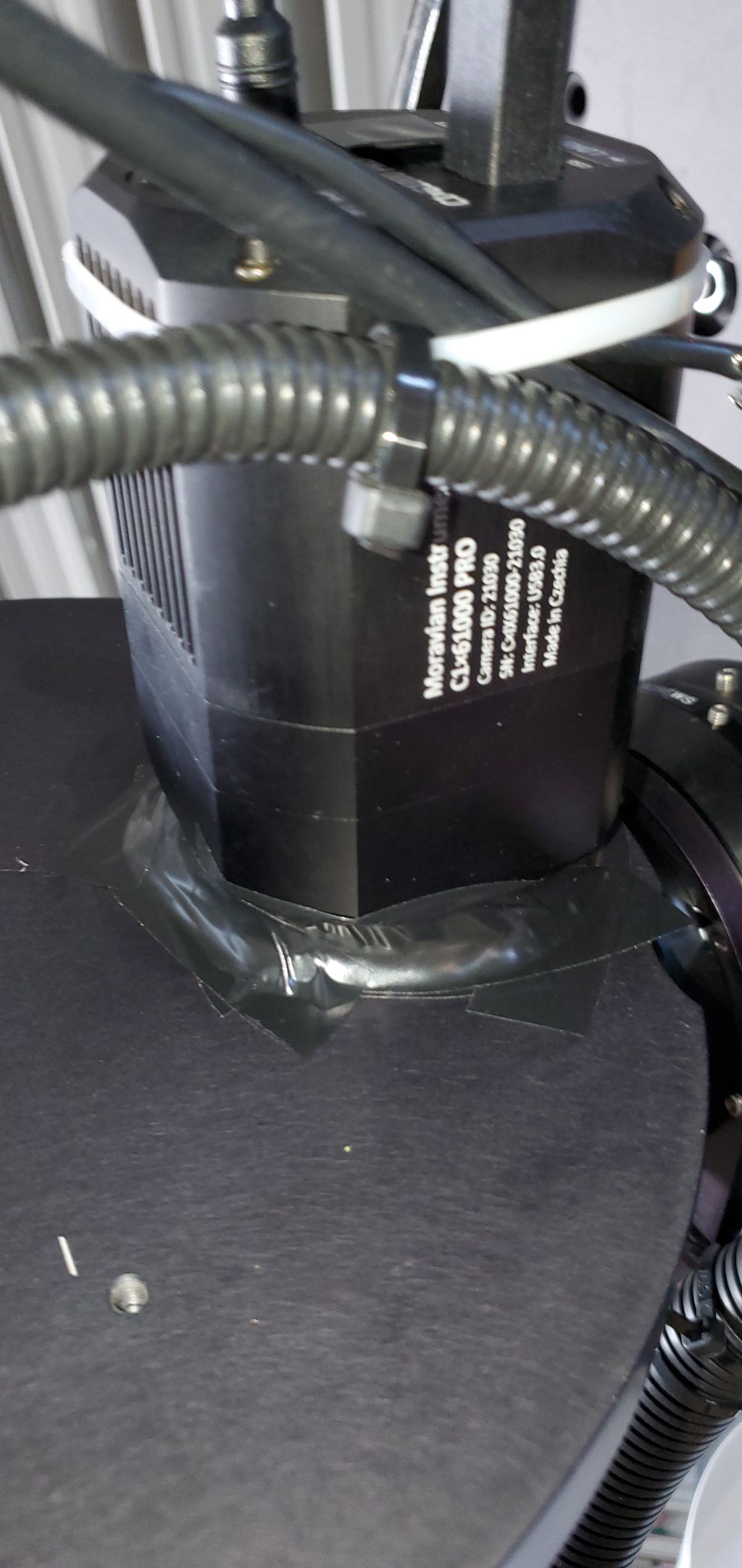

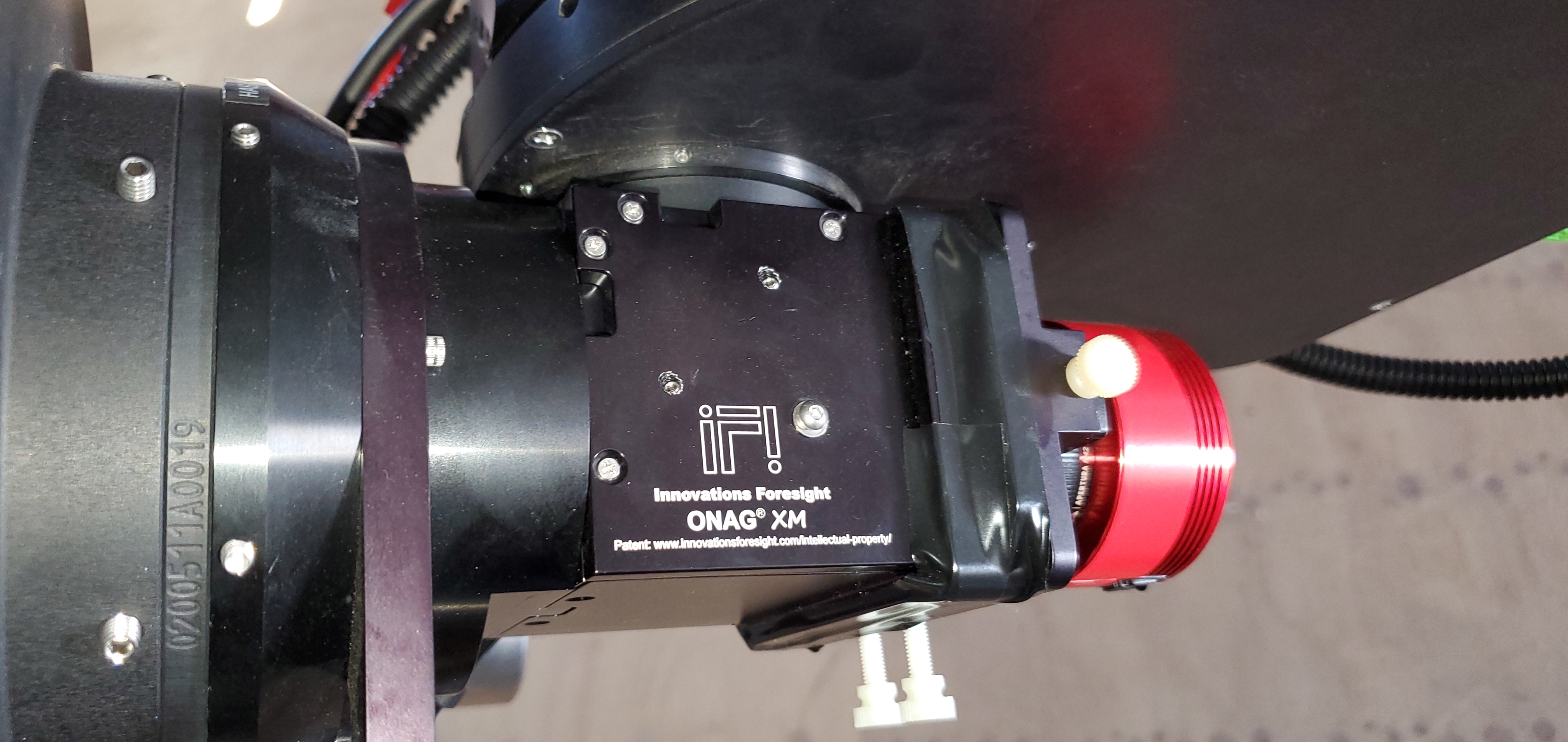

Here's a quick download of a couple of phone shots.  The tape is only required on non-dust tight interfaces.  It's hard to tell in the photos but there are multiple layers of tape to insure that everything is completely air tight.
thx, that does give a good impression of the solution 👍
