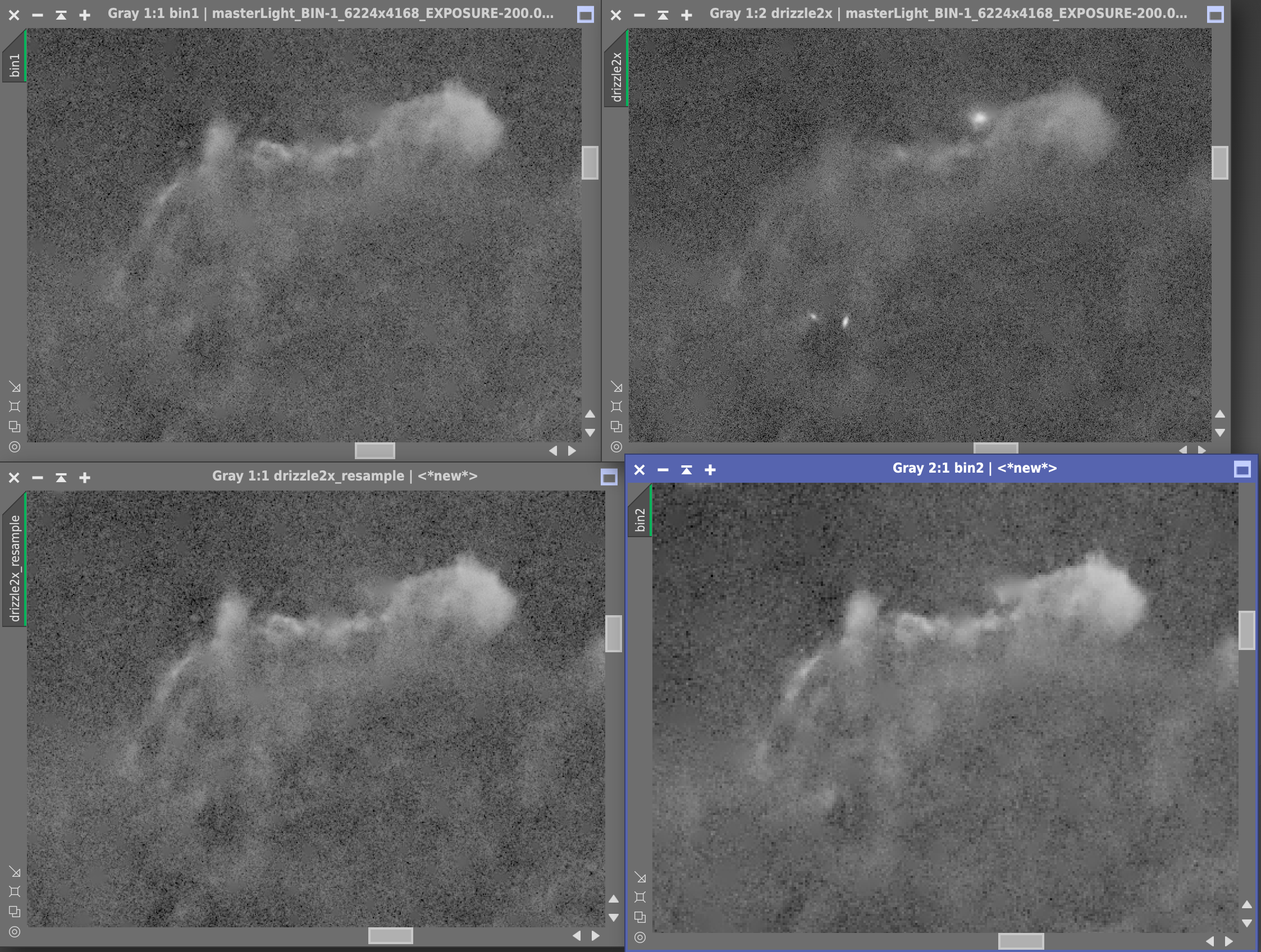

i am having a day off and thanks to the bad weather no new data to process, so I decided to make a comparison of (the same) differently sampled luminance data of my latest project.
what do we look at?
https://www.astrobin.com/v2tmwo/
128x 200sec luminance (antlia)
esprit 120 at 840mm
touptek imx571 mono
well dithered
eq6r pro (tuned)

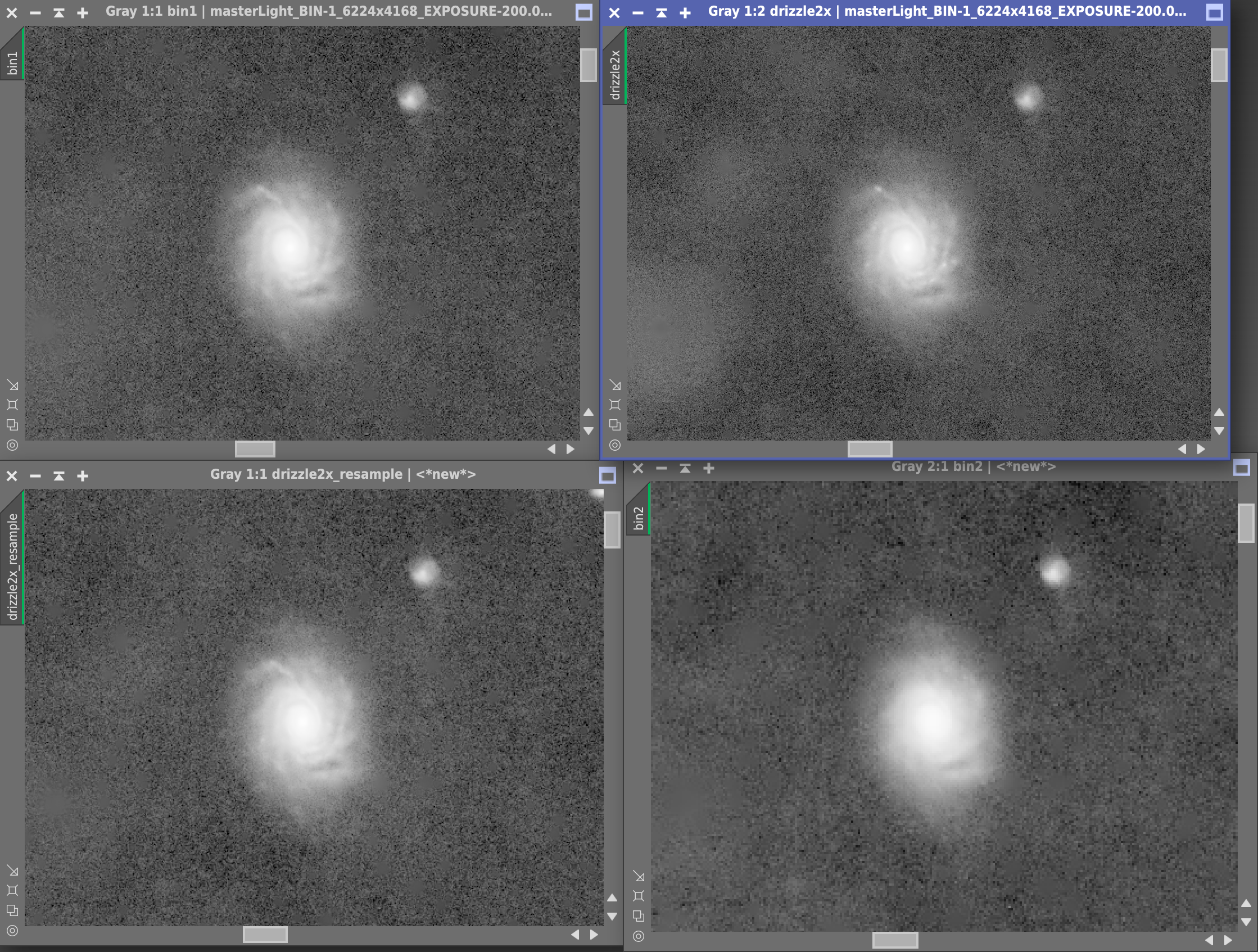

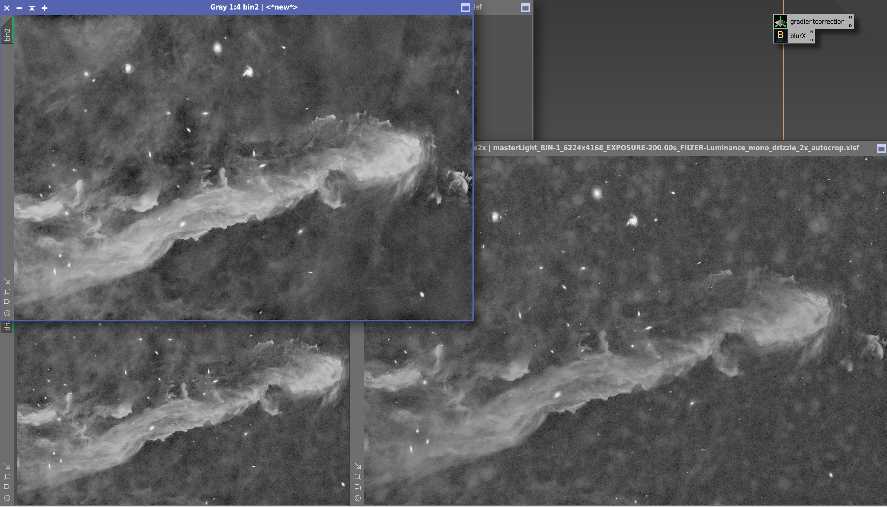

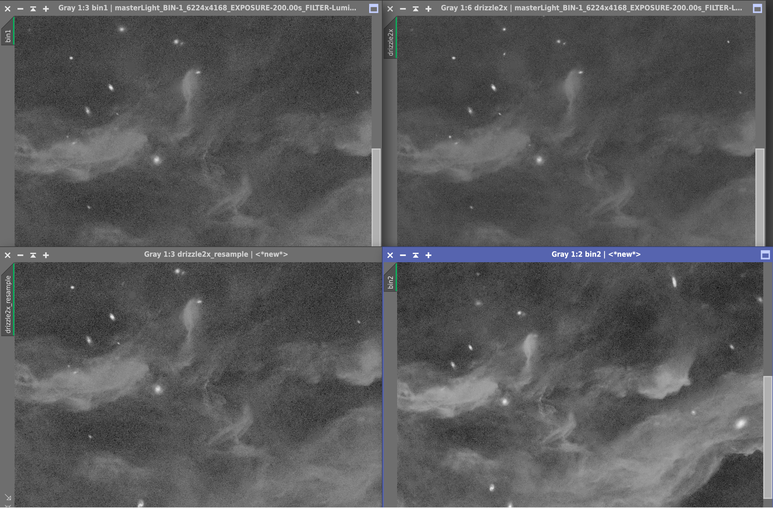

i processed the data in 4 different ways:
  1. bin1 native data --> 0.92"/pixel
  2. drizzle 2x 0.7 dropplet size -->
  3. drizzle 2x 0.7 dropplet size --> resampled to the original resolution using the pixinsight resample tool after using blurX
  4. bin2 data --> 1.85 "/pixel (resampling of the integrated bin1 image in pixinsight)
the pictures I am about to show are small screenshots of the different datasets and I am sure there are better ways to display my results but well, thats what I got and I would say the differences between them are still visible.
here is a short summary out of gpt o1, which got the task to look at the data and give a short summary of what it is seeing. Short Summary
You have four versions of the same dataset:
Native: This is your baseline, with original resolution. Balanced in detail and noise—no up- or downscaling.
Drizzle 2x: Potentially shows the finest details because it addresses undersampling. However, it tends to increase noise.
Bin2: Halves the resolution (combines 2×2 pixels), noticeably reducing noise but losing some fine structure.
Drizzle 2x, then resampled: Combines the higher detail recovery of Drizzle with reduced noise after scaling back down. Often a good compromise between detail and smoothness.
Overall, Drizzle 2x can yield the most detail but at the cost of higher noise, while Bin2 is the cleanest but sacrifices resolution. The resampled Drizzle version frequently strikes the best balance for many astrophotography needs.

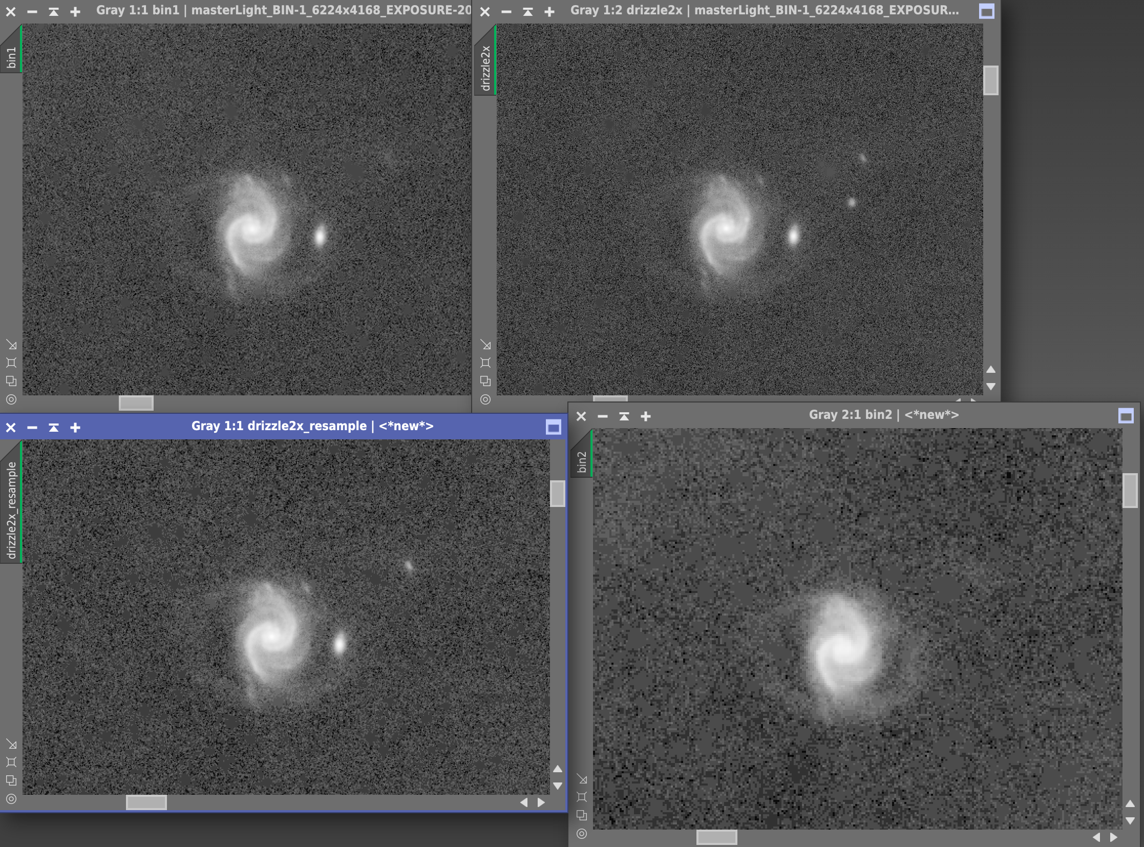

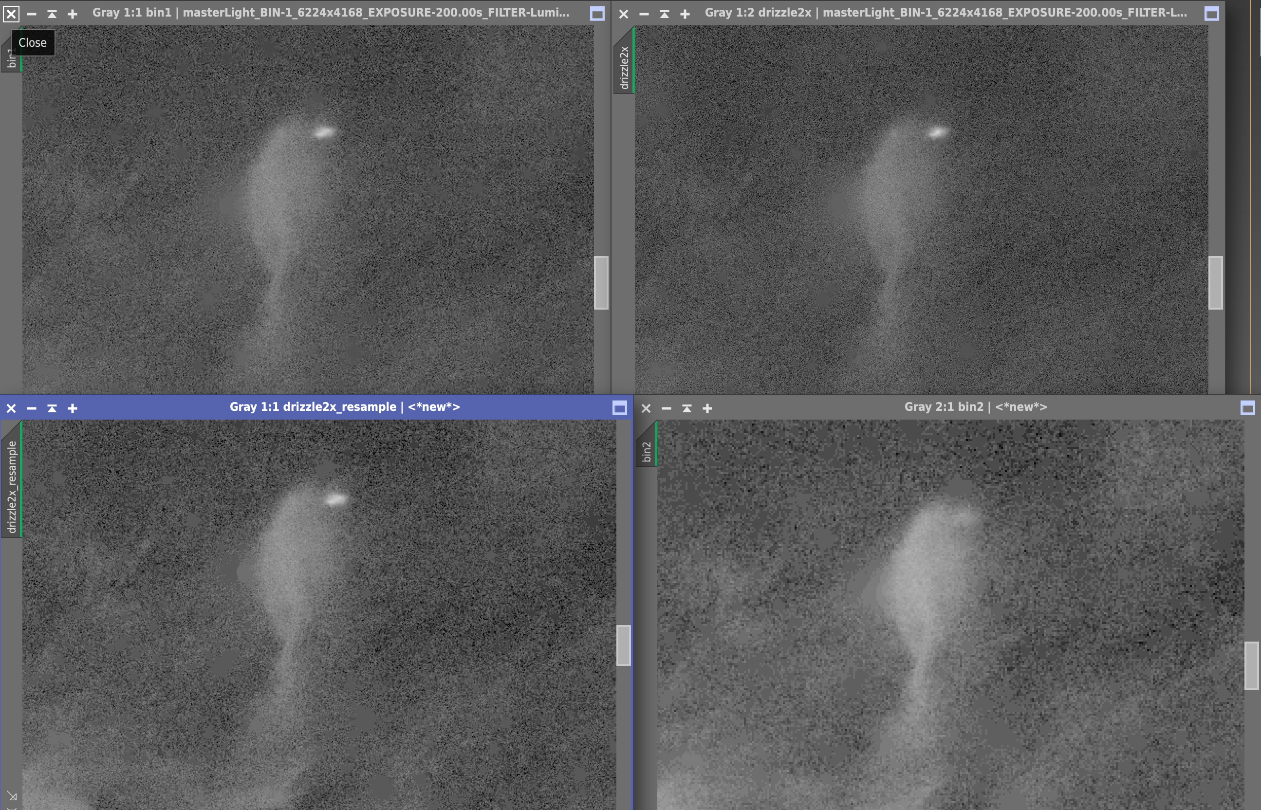

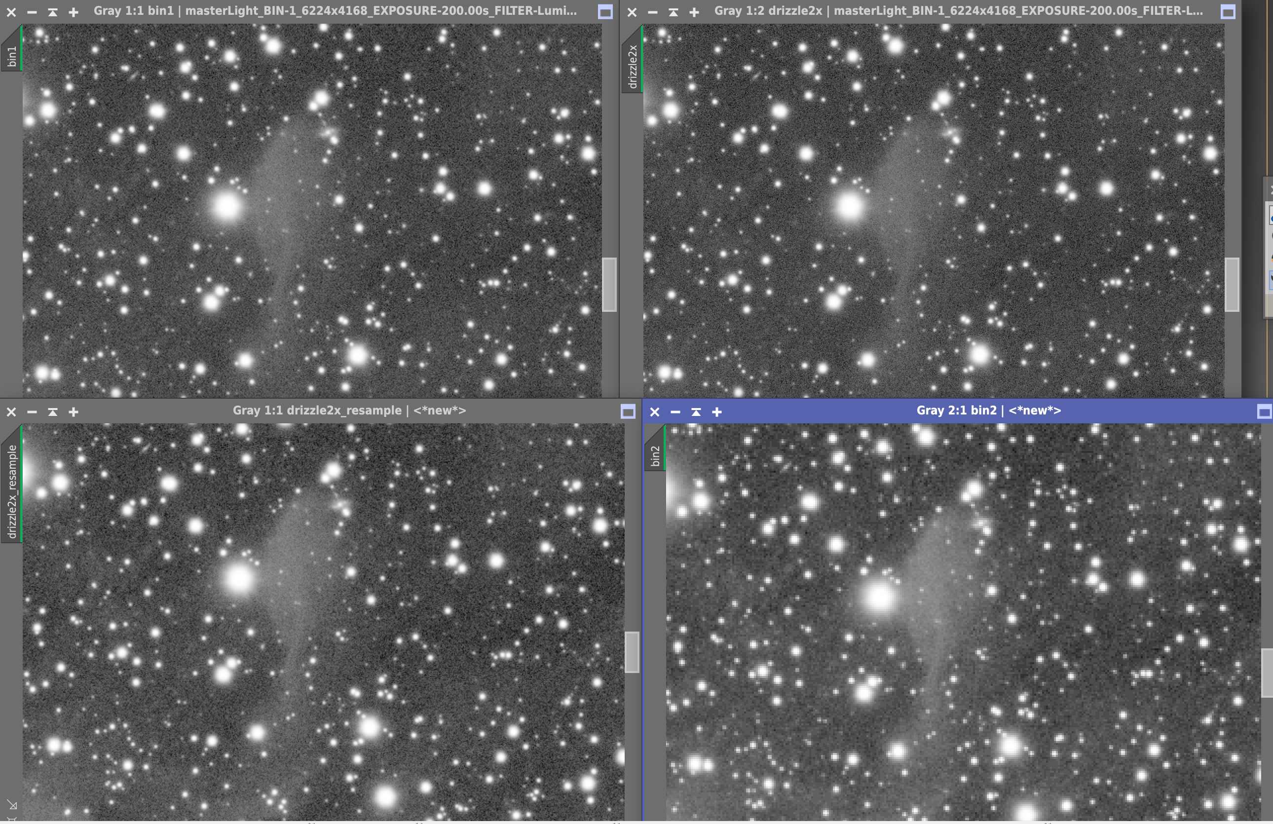

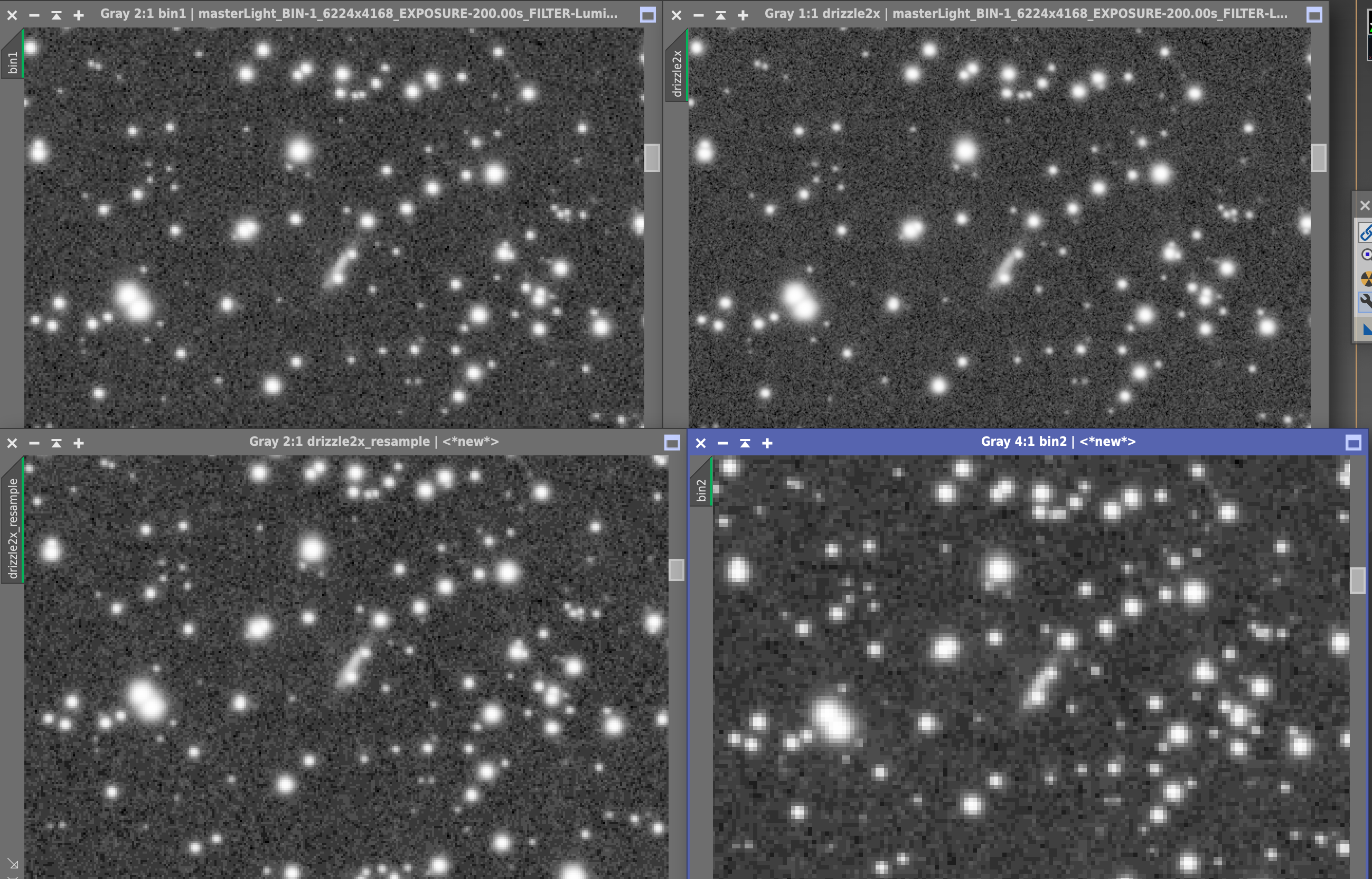

full field 2.pngfull field.pngnoisex2.pngnoisex1.pngnoisex.pngstarx2.pngstarx1.pngstarx.pngblurx2.pngblurx1.pngblurx.png

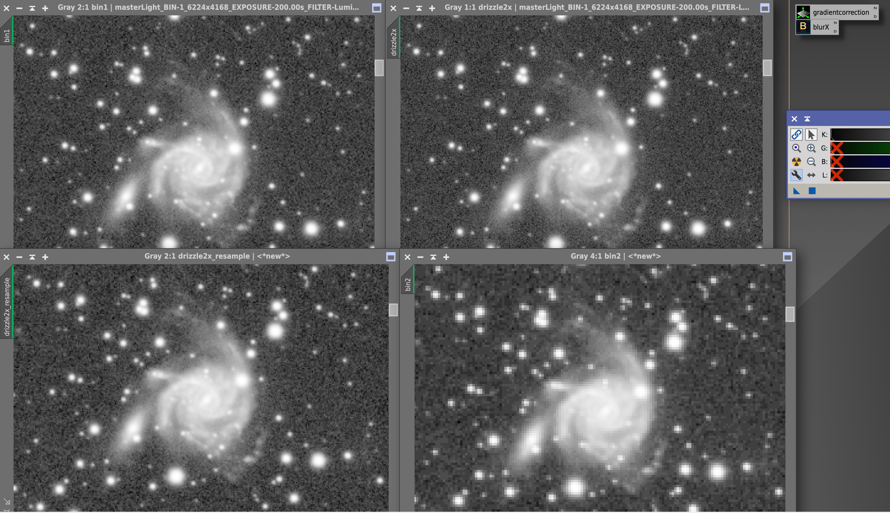

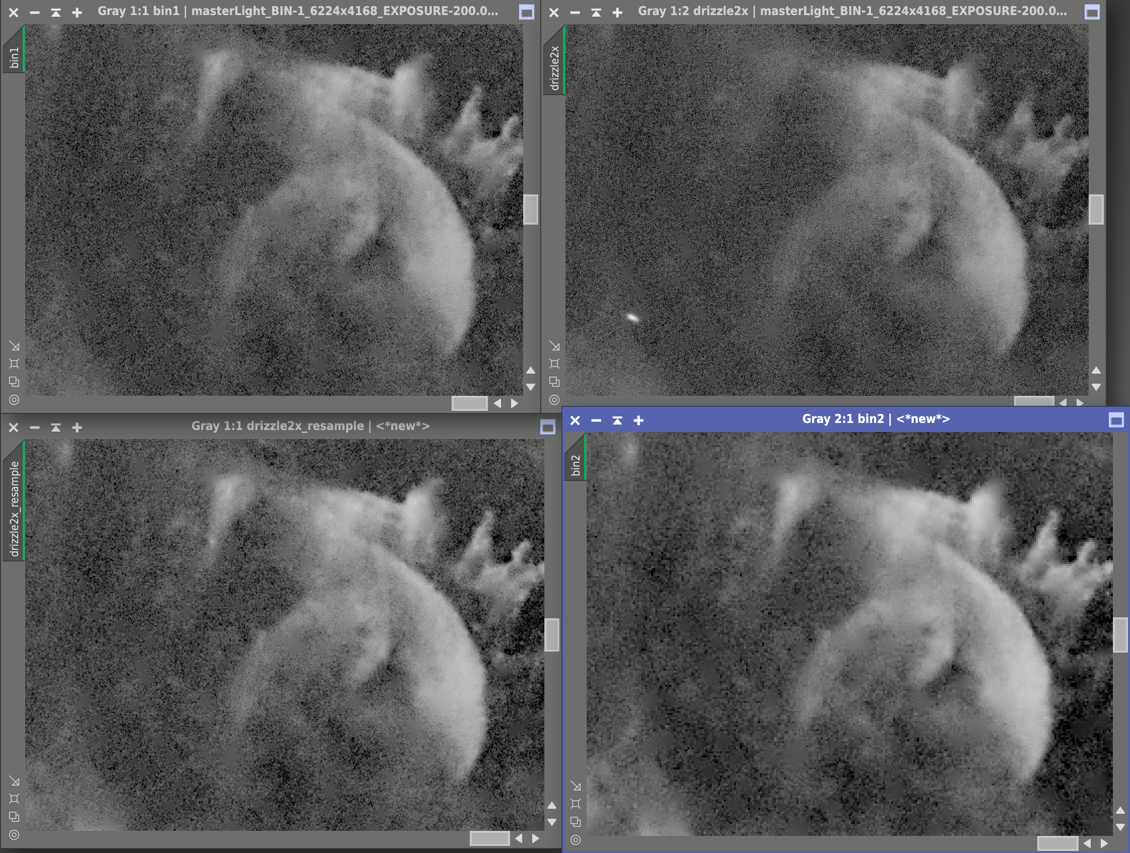

A few noteworthy points:
  1. Drizzle 2x
  2. The gain in detail using 2x drizzle is relatively small, but in my opinion, even at 0.92"/pixel, there’s still some benefit—especially when looking at the stars and the finer structures. I also find that the noise looks more pleasing both before and after using NoiseX.

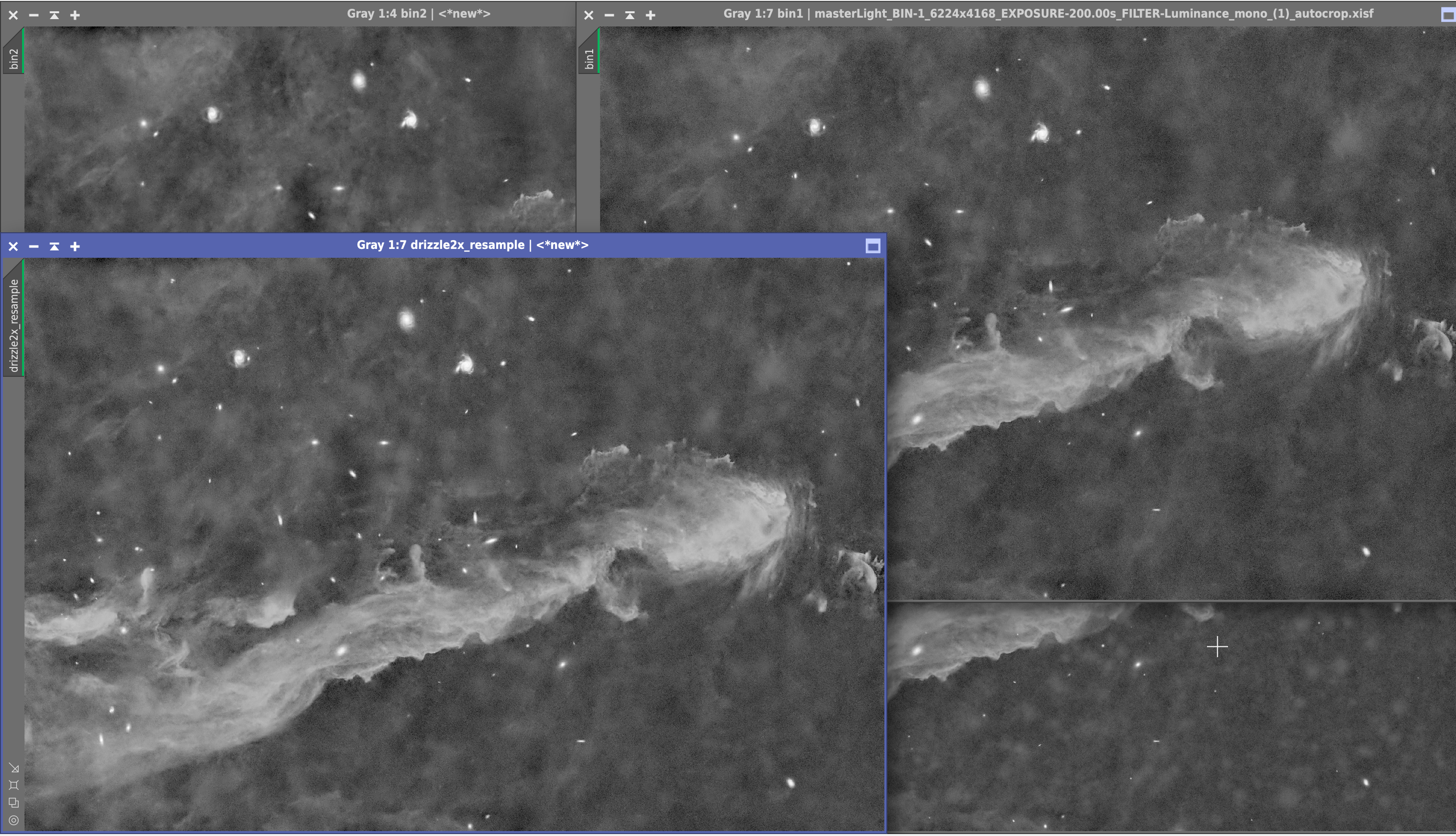

  3. Bin2 vs. Drizzle
  4. Drizzle isn’t the only way to capture more detail. The Bin2 data shows a better and more detailed view of the nebula overall. While drizzle can bring out very fine details, Bin2 reveals significantly more structure in the larger areas. When comparing the full field in 2x-drizzled data versus Bin2 data, the drizzled image seems to lose a lot of the fainter nebula features and instead shows something more like altocumulus clouds.
  5. HDR approach
  6. While GPT suggests that a 2x downsampled drizzle image offers the best balance, I think it might be worth exploring some sort of HDR-style combination of both drizzle and Bin2 data.

Bin2 yields zero advantage other than file size on modern sensors.   With that drizzling 2x on binned data makes zero sense to me.
Drizzling is a trickier answer.   At 0.92 image scale on a 120, you're likely seeing limited, and far from undersampled.   But some skies are better than others.   I am fortunate enough to take advantage of that in my backyard, but it's not consistent.   Drizzle can be combined with BlurX to enhance an image as well.  I find the increase in spatial resolution helps, albeit very minimal in most cases.  Typically the image is rescaled back to native resolution at the end of processing.
I do not drizzle everything, however.   At 0.96 image scale on my Esprit 150, I do find some nights with exceptional seeing.   I know this because my stars will end up being single pixels.  That indicator alone is how I judge if an image can gain from being drizzled or not.    Even at my image scale, it's rare.
At the sake of being blunt, in the images you provided don't seem to gain much if, if at all from the different methods.

Hey brian,
it may look like there isn’t to much of a difference because we are only looking at screenshots here but i can assure  you there is a huge difference between the drizzled2x and binned2x data.
Bildschirmaufnahme 2024-12-22 um 16.30.20.mov
The drizzled shows slightly more fine detail, and way less detail in the large details like weak nebula. The binned data shows way less detail but way more weak nebula.
you can clearly see the difference in this short video. this is a blink between the drizzled and binned data
You are not gaining much by binning on capture with a CMOS sensor, just do it in post if that's what you want. Honestly, if you get even a small gain by drizzling, do it. This is a game of small things adding together to get a good result. To go deeper, for the most part I wouldn't BIN, I'd just simply expose longer. Such a cheap easy thing to do with our highly automated rigs.
