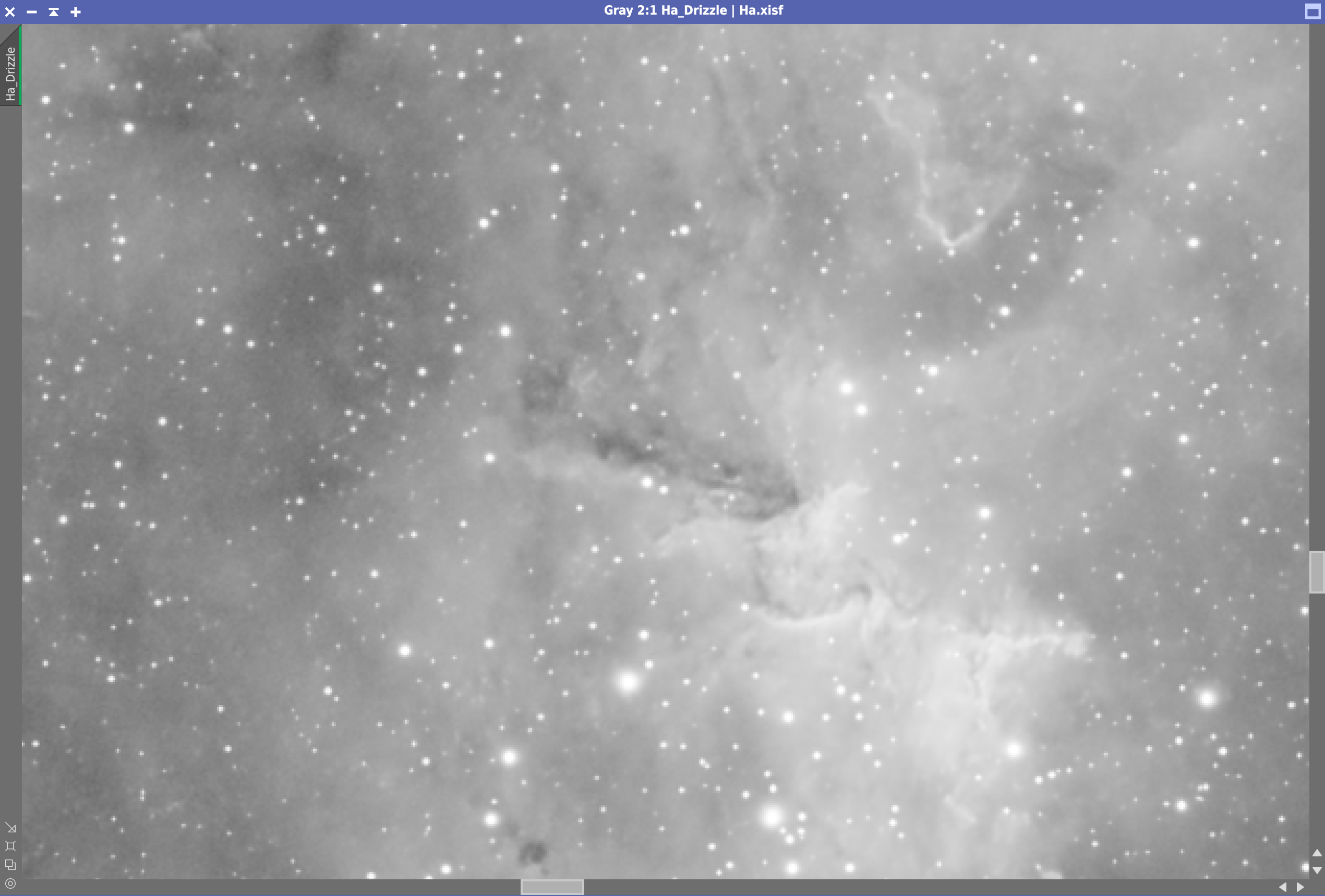

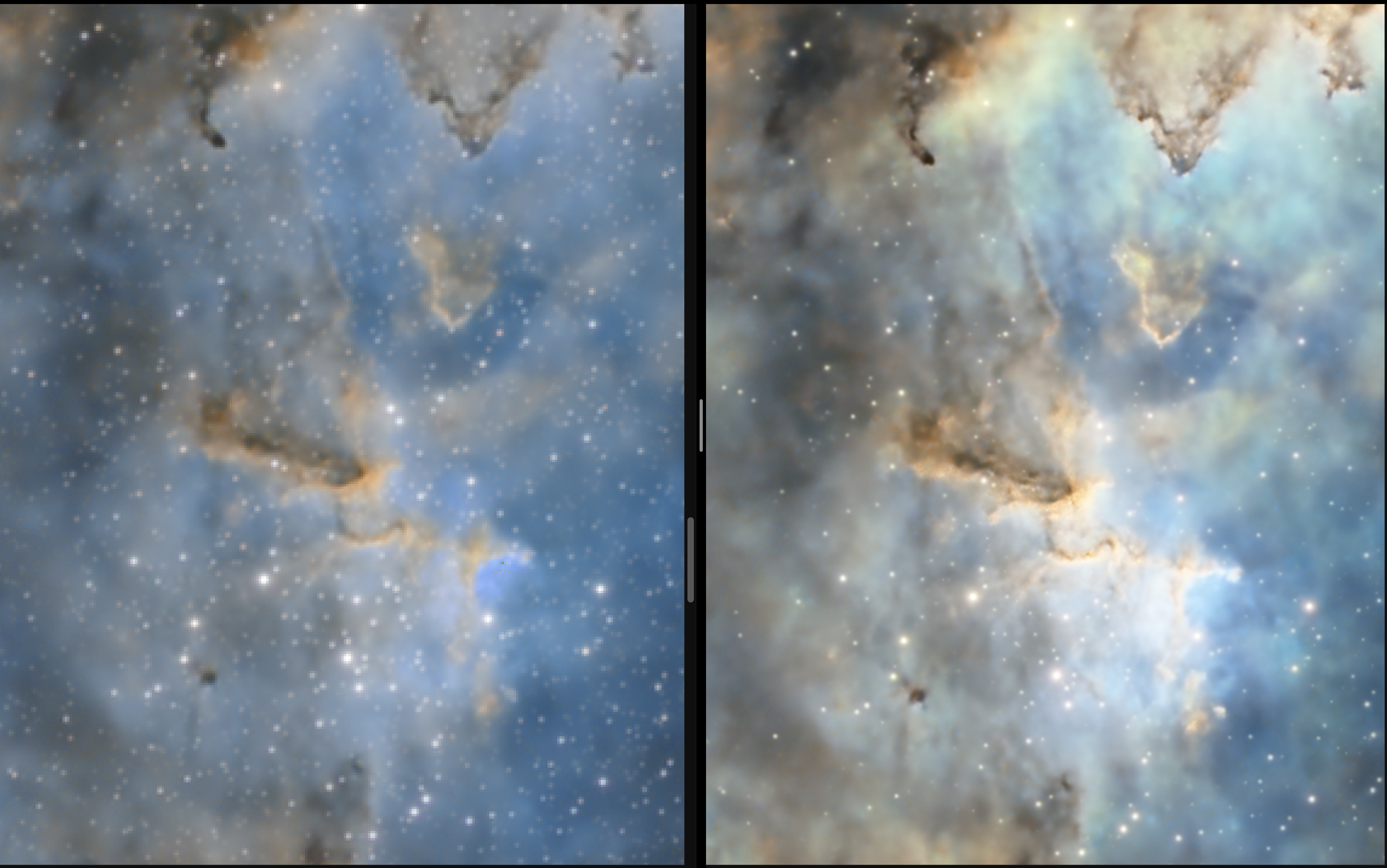

I am working on a widefield image of IC1805 and am aiming towards 60+ hours of narrowband data.
The lens used is the Samyang 135mm and an ASI2600MM pro - with that, I have a pixel scale of about 6 arcsec/pixel, which is significantly undersampled.
Yesterday, I tried to drizzle my data, which seems to have worked pretty well. I now have a pixel scale at about 3 arcsec/pixel and a much more pleasing image to look at.
Left is non-drizzled - right is drizzled - it's Melotte 15 heavily zoomed
What might be the downside to this approach?
I don't care about the larger images or the potentially longer process time, which to me is insignificant and a price I'm willing to pay if the end result as I currently see it seems much better.
JanvalFoto 4.51
The price you pay is the increase in noise as you increase your image size, but you could also just resample the image afterwards to negate that effect, or try drizzle x1 which will not affect SNR. If you have lots of data maybe the change in SNR won't be that noticeable though.

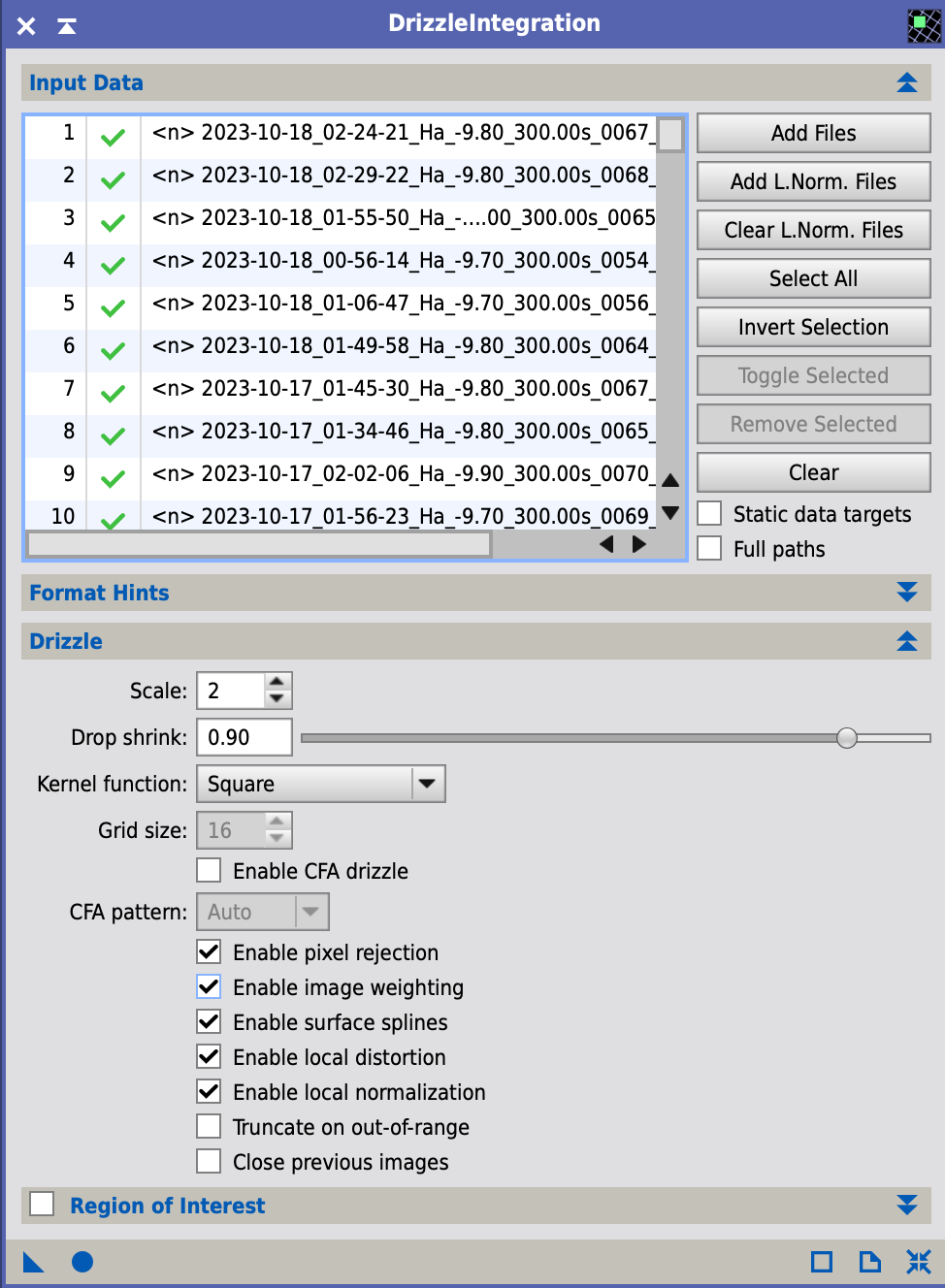

These are the settings I used for the Drizzle Integration.
Anything I could benefit from changing?

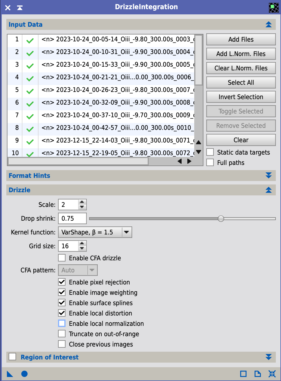

WhooptieDo 10.40
Christian Bennich:
My best results so far have been with Var Shape 1.5 kernel, with drop shrink anywhere between 0.5 and 0.8 depending on how much integration time I have.   Experiment with it, not every situation is the same.   Compare them side by side and look for empty pixels when you've gone too far.  If you want an example of just how well it can work, look at my Veil images in my gallery from a few months ago.  Those settings worked almost too good lol.
Also, things could probably go a little faster if you turn off local norm.
Christian, the drizzled image looks indeed much better. You seem to have lost a lot of the weaker stars. Is that only drizzle effect, or more processing steps involved?
Bennich 5.02
Willem Jan Drijfhout:
@Willem Jan Drijfhout - the “loss” of stars is intentionel.
I am using Bill Blanshans “Starreduction” script for that.
Personally I like the way it emphasizes the nebulosity when the stars are not that dominant.

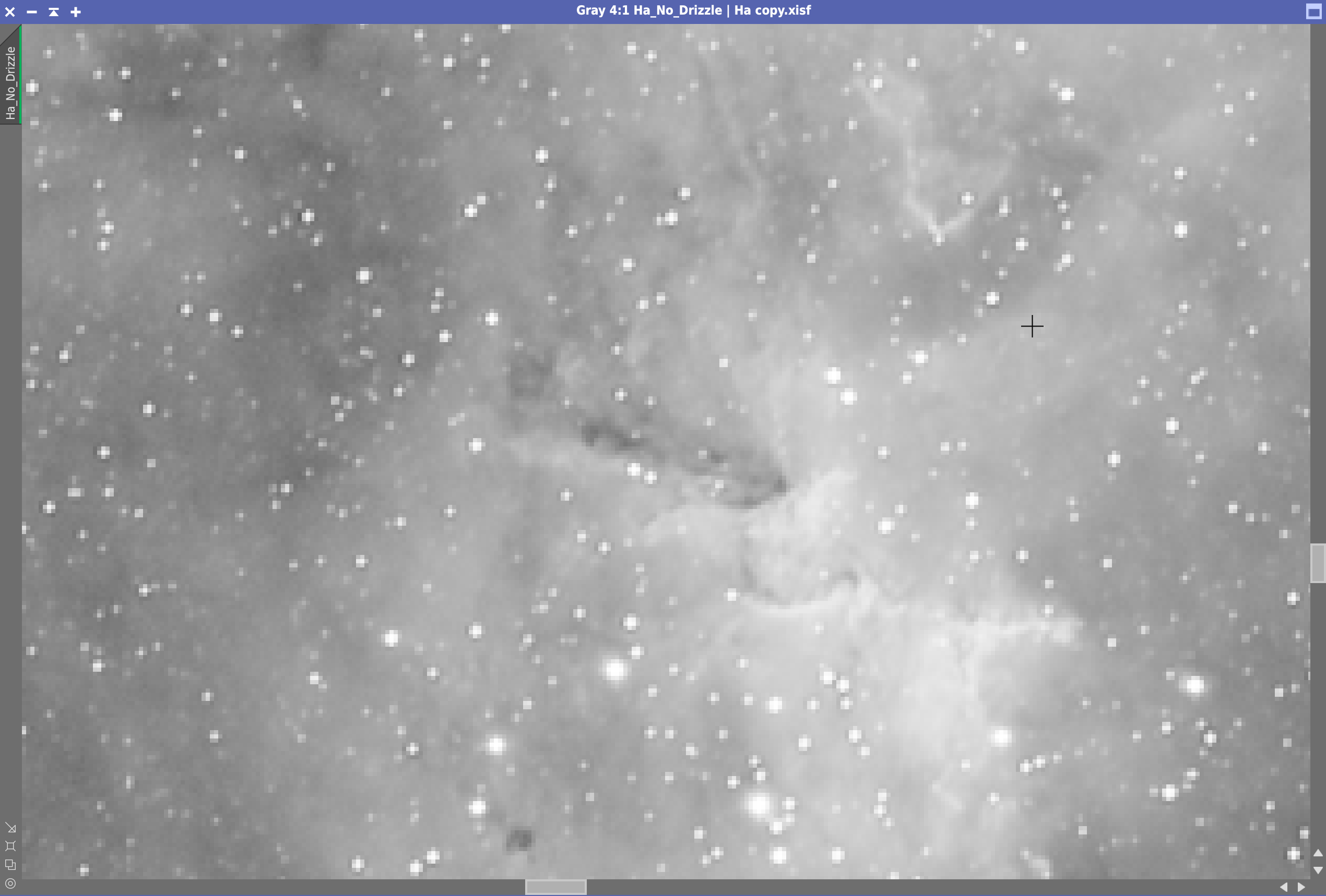

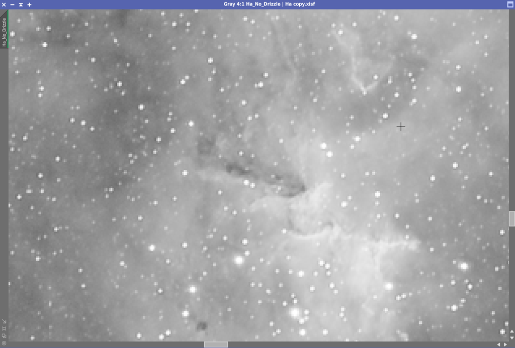

@Brian Puhl - I reran the DrizzleIntegration now.
Here are the results on the stacked HA image.
Comparing 3 images.
Without Drizzle, With default Drizzle settings and finally with the settings you suggested.

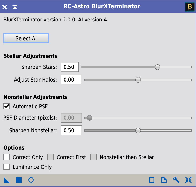

Only thing I have done to the image is BlurXterminator - ONLY to see a simple result.
Default STF stretch.
TL;DR - The settings you provided make for yet another significant improvement to my image.

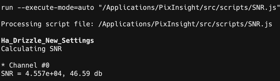

I am no master in understanding the SNR - as I interpret it - I get a significant improvement in my overall image, at the cost of a slightly higher noise level.
Overall - I think that we have a winner here.
Samyang 135mm + ASI2600 + Drizzle == 😍😍😍
Default Drizzle Setting:
New Drizzle Setting:
BlurXTerminator Setting:
Images 1 - NO Drizzle

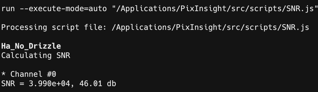

SNR calculation in image:

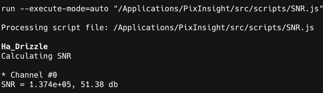

Image 2 - Default Drizzle settings

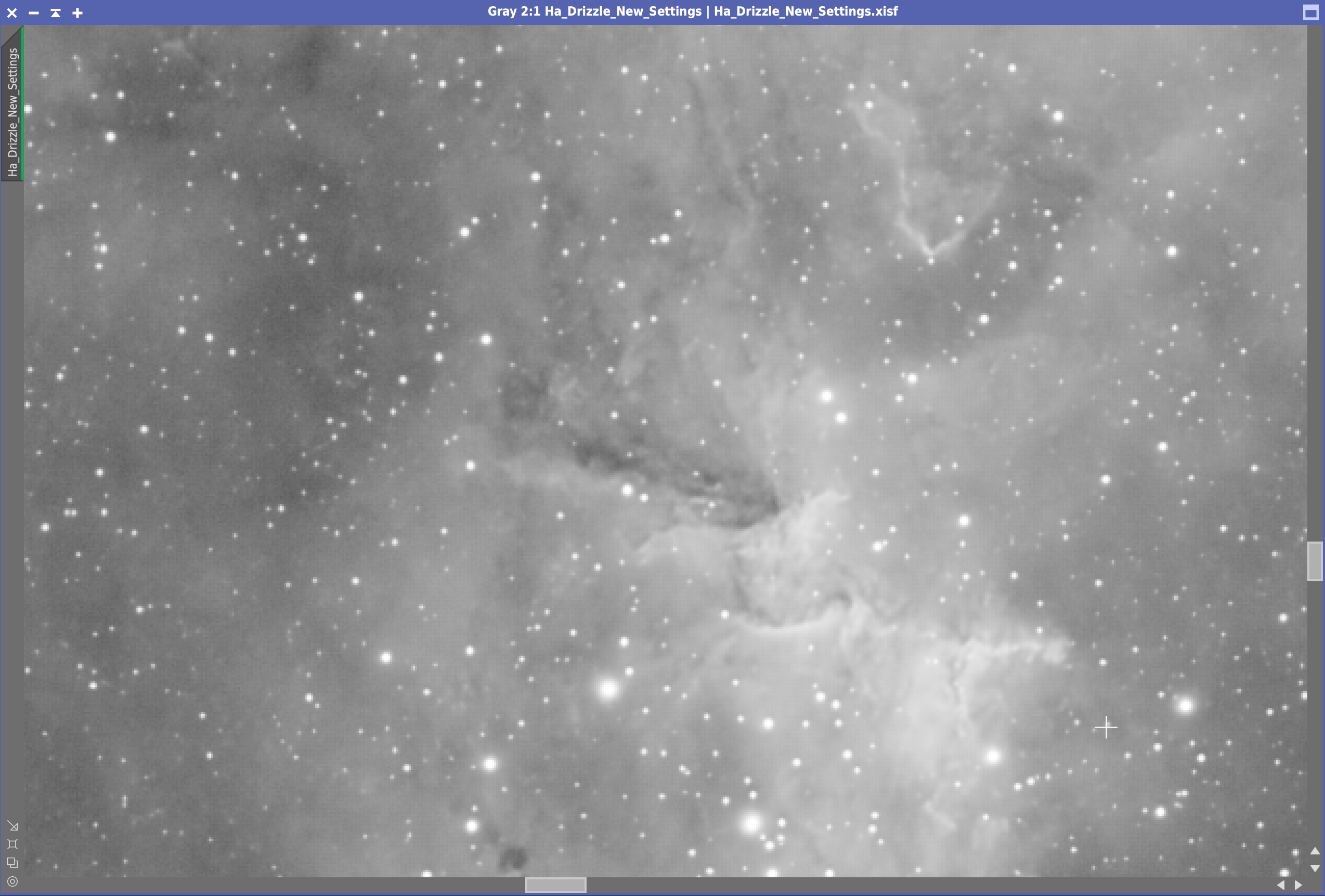

Image 3 - New Drizzle settings
WhooptieDo 10.40
It's hard to tell with an STF, (i'd relax that a bit cuz she's bright) but it almost looks like you ended up with a bit of a grid pattern in your third iteration.   I guess you're at 2:1 scale though.      Definitely a solid improvement.   Like I said, it's alot of trial and error, but I'd say you're off to a really great start.
Bennich 5.02
Brian Puhl:
Yep - a bit of grid pattern in the there. Have to figure out how to get rid of that.
WhooptieDo 10.40
Christian Bennich:
Brian Puhl:
That's kinda what I was getting at with the empty pixels part.   Might have gone a tad too far due to lack of integration.    but if you don't see it at a 1:1 scale, I wouldn't be concerned.
Bennich 5.02
The faint grid pattern completely disappeared during processing.
Especially NoiseXterminator fixed it entirely as the last step in my process.
