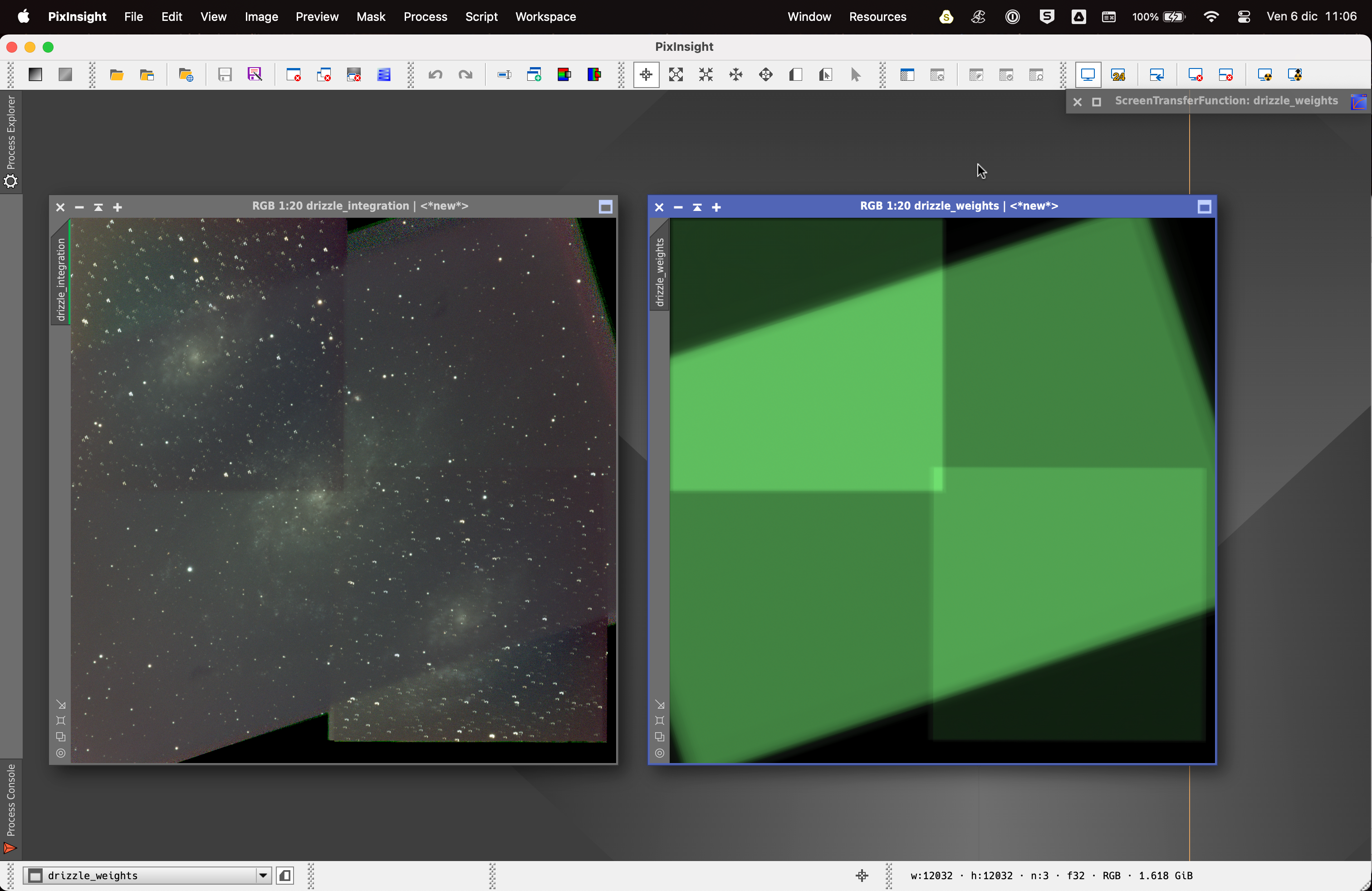

today I’m presenting an issue I’ve encountered while trying to integrate two sets of images with different resolutions and original sampling in PixInsight: one taken with an ASI533MC PRO + 115/800 telescope and the other with a Canon 90D + Sigma zoom. Both the star alignment and the integration process works perfectly, whether I use a Canon image or an ASI image as the reference for alignment, even without any preliminary resampling of the ASI images and all process parameters kept as default (but checking the drizzle flag in both the process, see beyond).
If I then attempt a drizzle integration using the drizzle files generated by the alignment and integration process with a Canon image as the reference, everything works correctly, and the final image is resampled at 2x without any issues. Fine!
However, if I try a drizzle integration using the drizzle files generated with the ASI image as the reference, the final image is completely pixelated, as if something went wrong during the previous process, either alignment or integration. If I open with blink all the aligned file which go as input to the integration process, everything seems perfect.To troubleshoot this, I tried to resample the debayered ASI images by a factor of 2x before registering the two sets of images using a (resampled) ASI image as a reference, so that the ASI images matched the original sampling of the Canon ones. Again, even in this case the registration and integration algorithms work perfectly, and the final integrated image is flawless, except it’s obviously double the dimensions compared to the previous attempt.

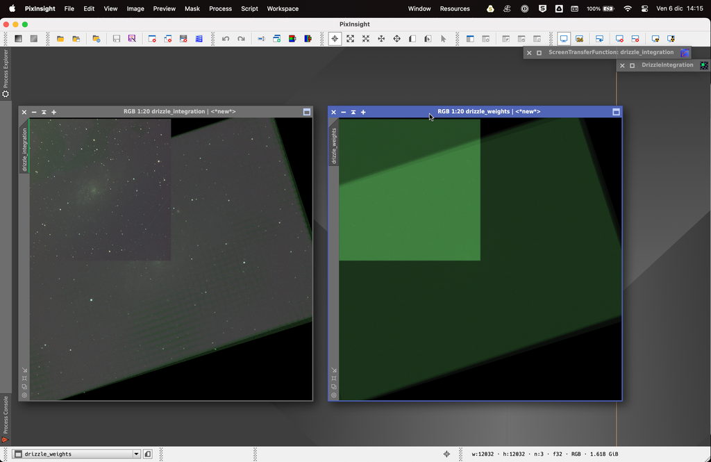

However, when I proceed to a subsequent drizzle integration, I encounter the situation shown in the attached screenshot: the ASI images, despite being properly resampled and registered relative to the Canon images, are “stacked” either with their initial coordinates (0,0) in the top left corner, or in the bottom low corner, instead of being perfectly aligned with the Canon images.
Where am I going wrong?
Note: the first screenshot was taken while testing the drizzle integration process on a subset of the total images, the second screenshot by applying the process to all the images. In both the screenshots you can notice that absolute alignment appears to be right, but not resampling and relative overlapping of the two image sets.

Attempt 1:
  • Star alignment using Canon image as a reference, all other parameters as per default: everything is fine from alignment, through integration, to final drizzle integration.
  • Star alignment using ASI image as a reference, all other parameters as per default: everything is fine from alignment, through integration, but NOT drizzle integration, which appears to be heavily pixelated.
Attempt 2:
  • Resampling debayered ASI images 2x.
  • Star alignment using Canon image as a reference, all other parameters as per default: everything is fine from alignment, through integration, to final drizzle integration. Final images have of course double resolution compared to attempt 1.
  • Star alignment using ASI image as a reference, all other parameters as per default: everything is fine from alignment, through integration, but NOT drizzle integration, which appears as in the attached screenshot, with ASI images positioned in (0,0) coordinates.

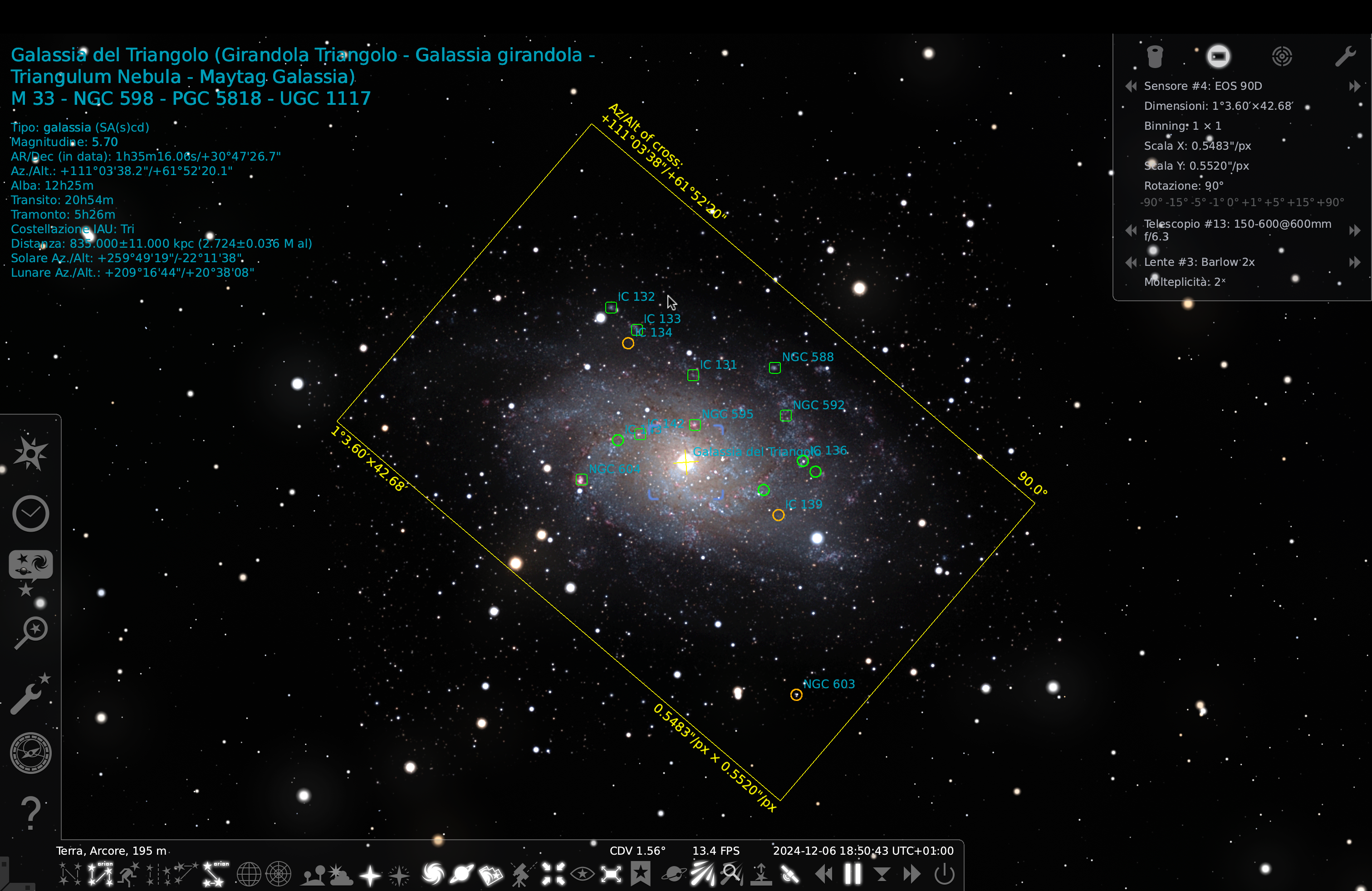

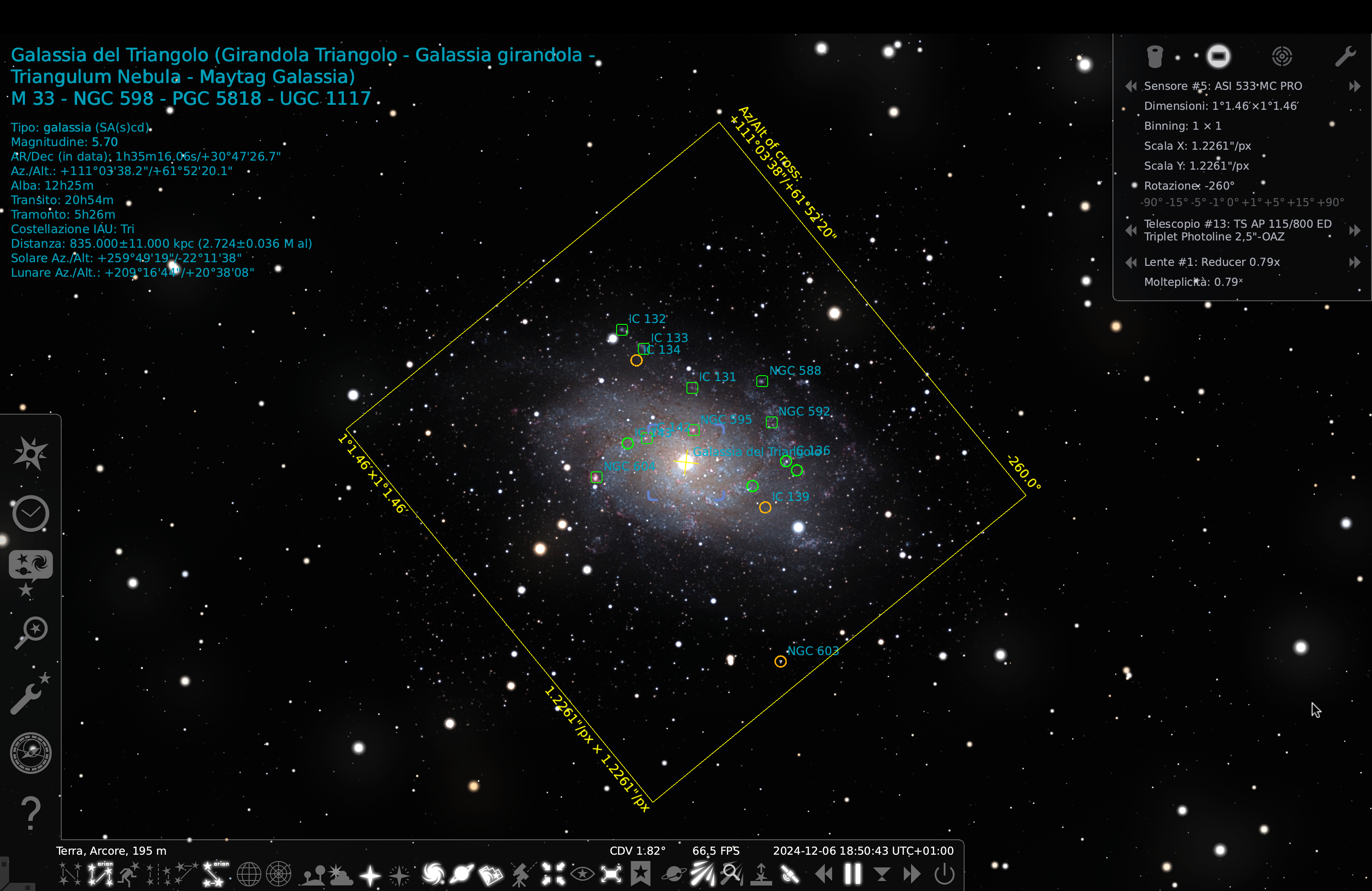

If you take a look at my previous screenshots you can get an idea. The target is M33 galaxy. Rectangular field come from Canon images, square-shaped from ASI.
I here attach the simulated FOV on Stellarium of both the set-ups , of course considering the right configuration ASI+telescope+flattener  / Canon+zoom+teleconverter.

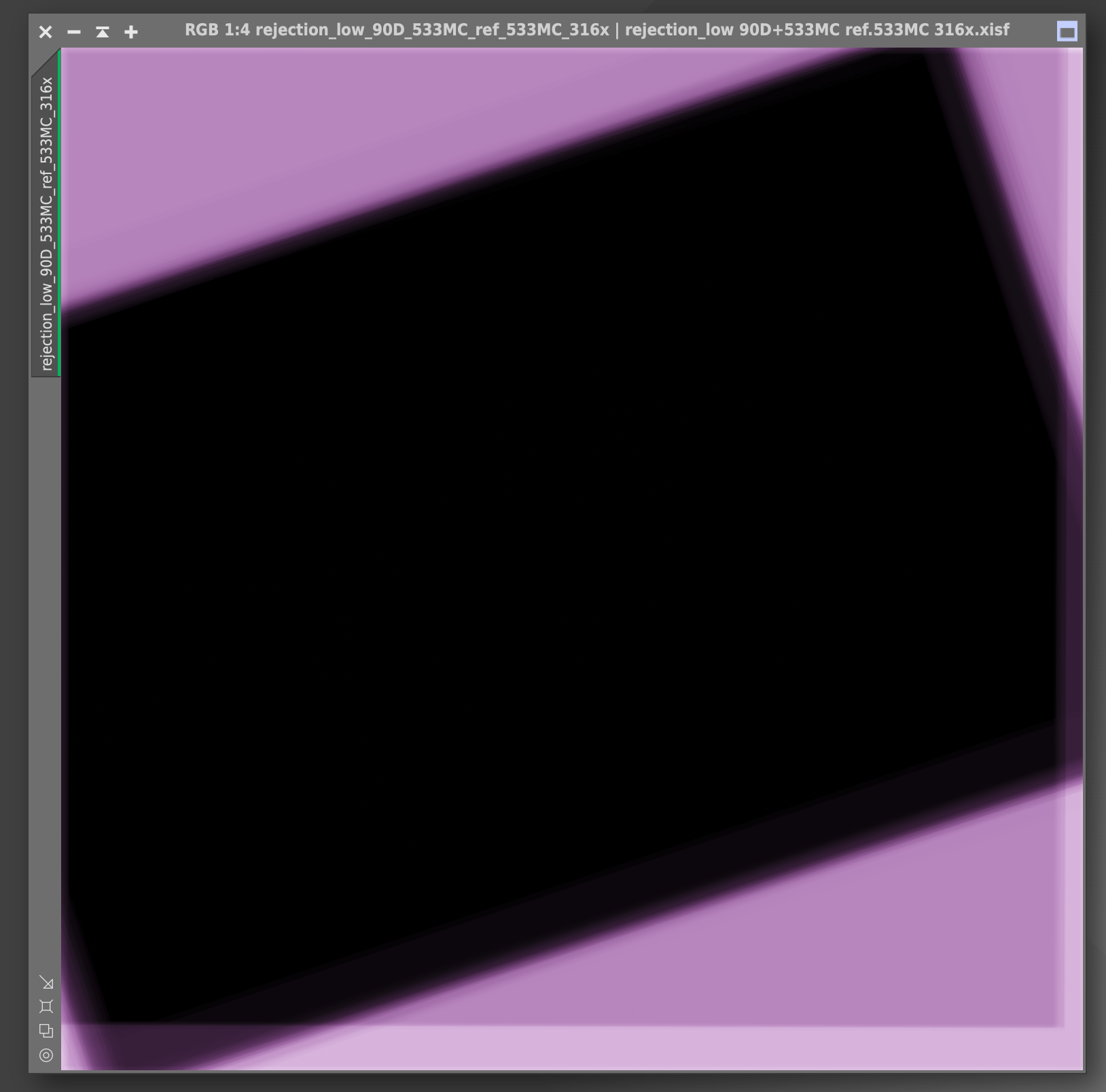

You can also see the actual overlapping looking at the attached rejection low image resulting from the regular integration, where the rectangular FOV is Canon and the square-shaped FOV is ASI used as a reference. As you see, without drizzling everything works fine and the final image is ok.
FOVs are not so different, but images characteristics are. Canon images are 6960 x 4640 pixels, sensor is an APS-C whose diagonal is 26,82mm, while ASI images are 3008x3008 pixels and sensore is 1" whose diagonal is 15,98mm.
Asked ChatGPT to do some rough calculation about, and after correcting a couple of its incorrect assumptions, sampling in arcsec/pixels should be 1.23 for the ASI+telescope system and 0.55 for the Canon+zoom system.

Just to give an update: I then tried applying the drizzle integration separately to the two sets of images and so discovered that the error occurs specifically during the integration of the resampled ASI images set. That result produces exactly that strange image with the “doubled” galaxy, while the drizzle integration applied to the Canon set works perfectly fine.
So, the error is likely upstream in the preliminary resampling of the ASI images (the above mentioned "attempt 2", which in my experience shouldn’t be necessary anyway). This also means that the ordinary workflow I used in my "attempt 1" should be the right one, but probably there is some parameter for that case which I'm omitting.
