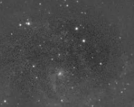

Far too many times in the first hour or so in an imaging session I get excellent stars only to find there is a small dark patch in my subframes caused by dew on the sensor. If I zoom in, it is actually not a darker patch after all – instead it is a few isolated pixels whose values are very different from the neighbor pixels.
This got me wondering whether these pixels can be located and processed away using a PixInsight script. Have anyone thought about this or worked on this? Thanks!!

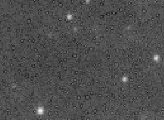

Here are the dew patch zoomed out and in. They are not really single pixel defects, but a few pixels bounded by dark boundaries.
Screenshot 2024-09-29 at 10.00.44 PM.pngScreenshot 2024-09-29 at 10.09.18 PM.png
