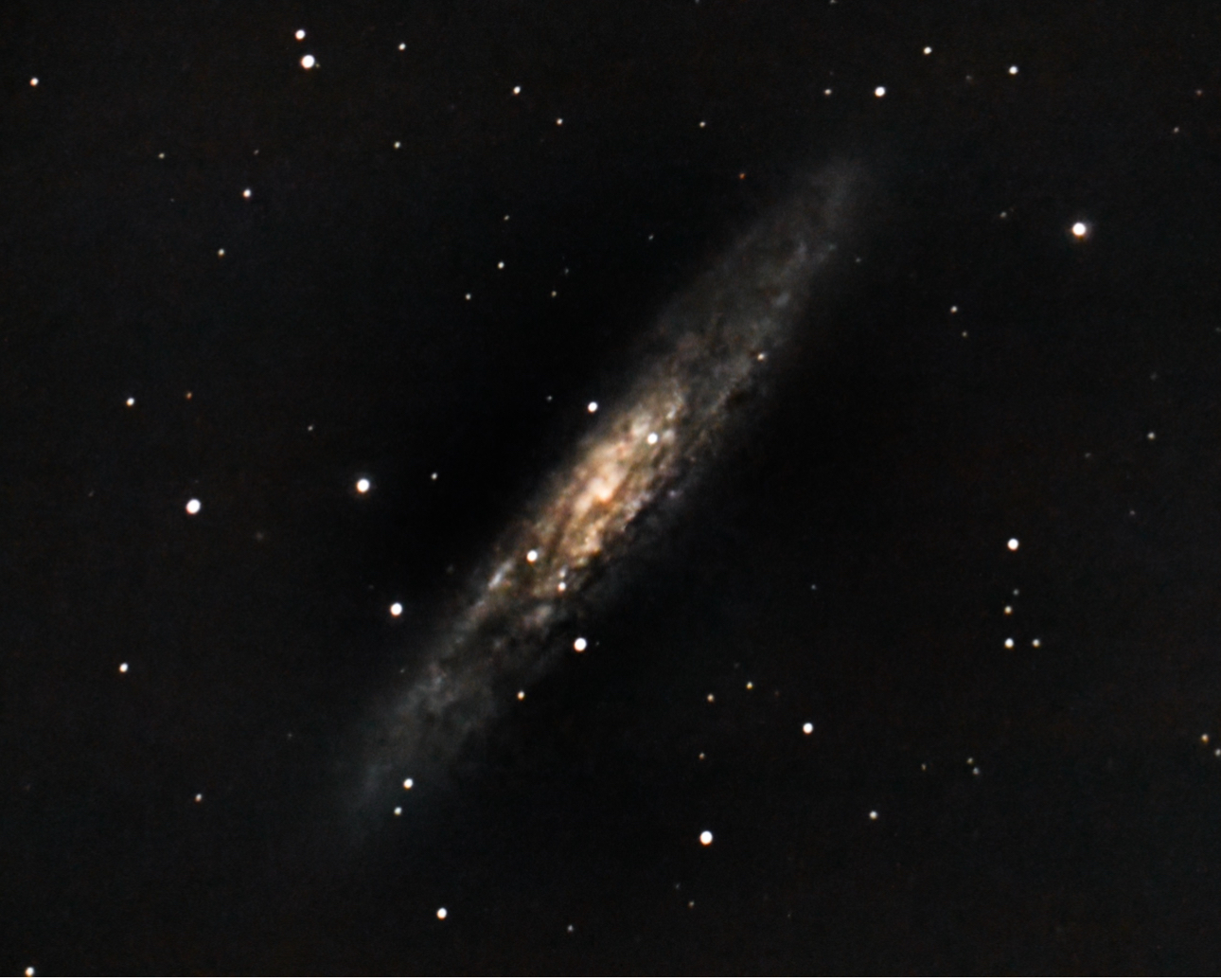

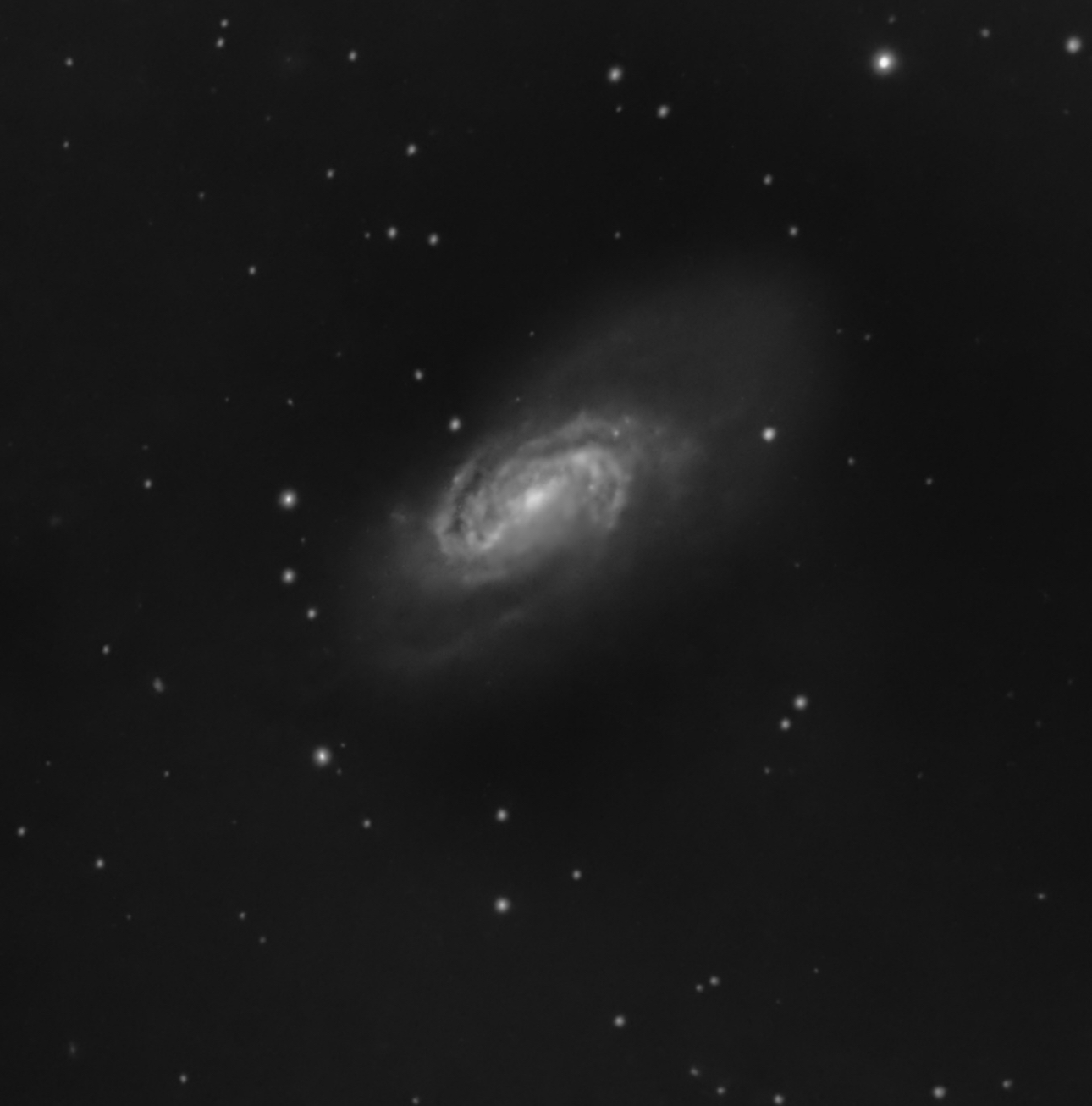

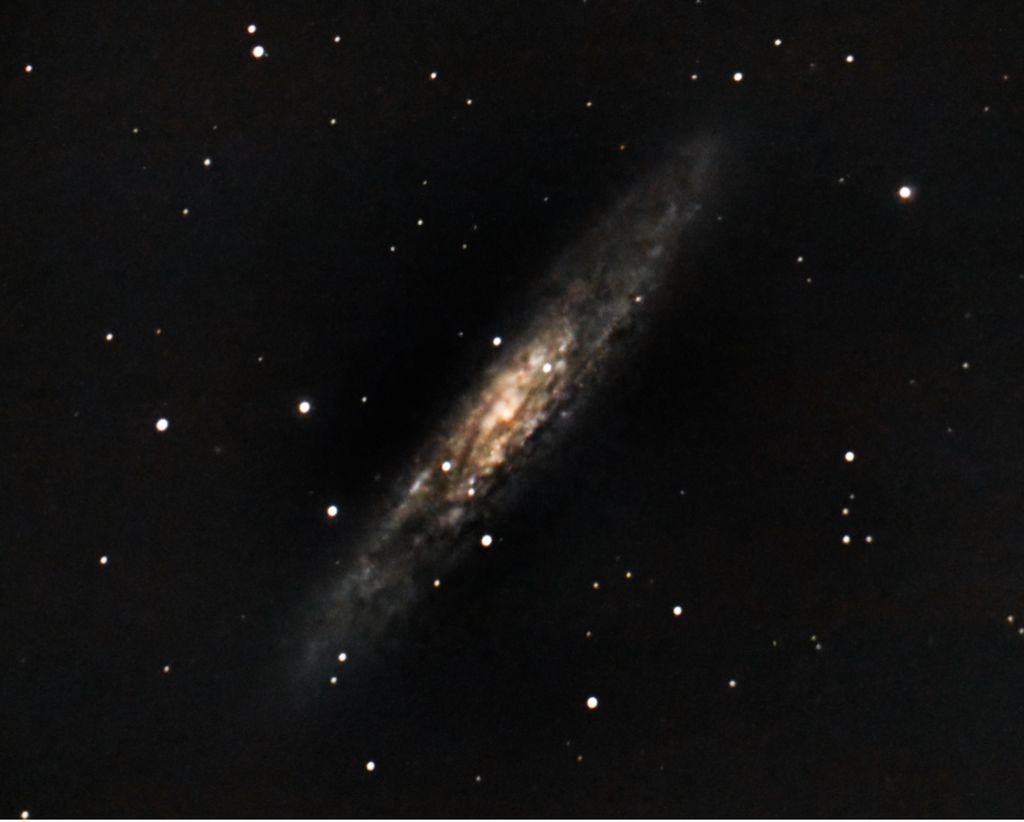

Hello!
I’m new to this amazing hobby and have a few questions that I’m struggling to find answers for.
I’m imaging with a Celestron NexStar 8SE + f6.3 focal reducer on the alt/az mount (I just got the wedge and auto guiding, but haven’t had a clear night to test it!). With the alt/az, I limited my imaging to 8 seconds and would try to acquire at least 500 subs for stacking. The camera is a modified Canon EOS 1100D (h-alpha mod). Processing consists of DSS and photoshop. I’m saving up for Pixinsght!
My scope is collimated and focus is checked throughout the night with a Bahtinov mask.
My questions are:
1. Am I doing something wrong that’s causing the bloated stars?
2. Is it even possible with this setup to achieve a nice background star field?
3. If these stars aren’t fixable in image acquisition, what’s the best way to reduce their size without distorting them? I’ve been using RC-Astro’s StarShrink, but have to be careful because they’ll sometimes leave little rings behind.
Any advice or suggestions will be so very much appreciated!!
Please also check my nebula images on my Astrobin. I can’t get them to load here because the files are too large.

They look a lot like the stars I would get with my 8se + nexstar before I switched to a better mount. I can now get reasonably good stars with the 8se - and no reducer - and running much longer exposures (see my images for a few examples), but the nexstar mount was hopeless for me…

Heather,
This is a hobby that really benefits from OCD.   Everything counts and it's the sum of the parts that make up the final result.  Here are some things that can contribute to less than perfect results.
1) Optical quality.  First, the base optics need to be of high quality and second they need to be well aligned.   Using a reducer can work but in general, reducers are likely to produce poor results at the edge of the field.   My recommendation is always to start without a reducer to get everything dialed in.  That reduces the number of variables when you need to figure out why things aren't as sharp as they should be.  The other thing that affect optical quality is component spacing.  Have you confirmed that the sensor in your camera is properly positioned with respect to the specified back working distance?  Finally, it doesn't take much misalignment to seriously degrade optical performance.  Be VERY careful to make sure the secondary is properly aligned.  A misaligned secondary will produce coma and I don't see much coma so that may not be an issue with your system.
2)  The number one thing that causes poor imaging is a focus error.  Using a B-mask is a great way to focus and if you are using it properly, you should be getting pinpoint stars.  Zoom way in on the pattern and very carefully center it to insure perfect focus.  Thermal drift can cause your scope to change focus significantly so it's important to check focus frequently.  Your images looks mostly out of focus to me.
3) Guiding errors can cause enlarged stars.  Your stars should be circularly symmetric over the field and clearly that's not the case so you've most likely got a guiding related error.  Polar alignment can cause this sort of problem with longer exposures.  Mechanical vibration can also cause elongated stars so make sure that the scope is mounted on a solid surface.
With the short exposures that you are using, you should definitely see pretty sharp stars in the background when everything is properly adjusted and the guiding is good.  Keep in mind that really poor seeing can also cause soft star images but even on an average night an 8" telescope should be able to deliver sharper images than what you are showing here.

The world with an SC telescope is very different from that with a small APO refractor telescope. The reason is not so much the quality of the optics, but simply that the resolution is entirely different. The cause could be poor tracking or inaccurate focusing, but one of the likely reasons is poor seeing. While stars are about 2-3 pixels in size with an APO refractor telescope regardless of the seeing, with an SC telescope, the star size can vary between 3-10 pixels depending on the seeing, even if everything else remains the same. The F-number of the telescope also limits how small the stars can be.

I third the recommendation to ditch the reducer, and if there's no other corrector, then backfocus is no longer a factor, right? I agree with John that it 'looks' like focus is the primary issue, but to Tommi's point, I've also had seeing bad enough to produce similar results….and as seeing deteriorates, so does focusing and guiding, a vicious circle….
For improving thing with processing, BlurXterminator is going to be you best bet for both correcting and then reducing stars plus bringing back detail in the target. Also, fwiw, I stretch my stars (separate from the target) using GHS and play with the Local Intensity adjustment to soften them around the edge so they don't look so much like dots.

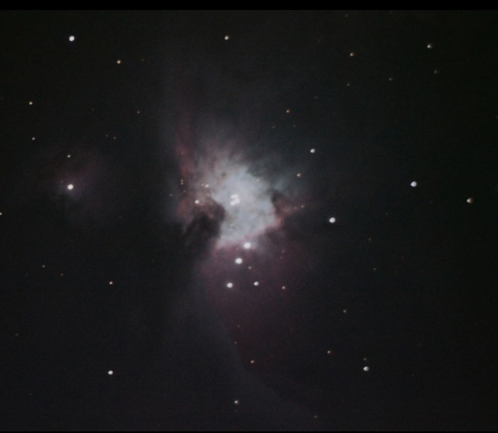

@Scott Badger I definitely need the reducer. There’s no way I would get any data with exposures even up to 5 minutes. The back focus is actually dead on with the reducer, t-adapter, t-ring and camera.
Here’s Orion before I got the reducer.
And after (exposures and integration time are the same).
https://astrob.in/9xkgls/0/
The stars all show severe coma, especially on the right side. Most likely your collimation is way off. That would explain the lack of sharpness with the reducer.

That was before I added the reducer and before I learned how to collimate. I had the telescope for about 2 weeks when I took it.
