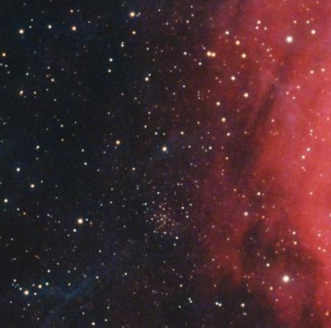

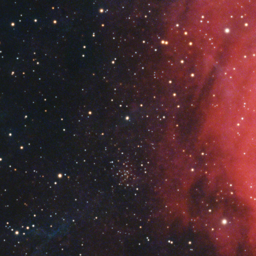

This is a crop at 100% of my last image:
And this is the same, on a more screen-friendly scale:
Hoping to see how others manage theirs!!
