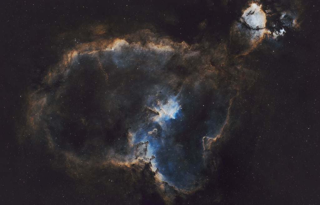

I'm still relatively new to mono processing so I tried processing it for fun and man do I wish my data was this good. There is definitely blue in there. I used Siril and Photoshop instead of PI but the process is essentially the same. I assigned SHO data to RGB channels in Photoshop and then in Siril I ran color calibration > remove green noise (I think it's called SCNR in PI) > background extraction > star removal > small stretch > increase saturation > another small stretch > increased saturation a tad more > star recomposition w/ a small stretch again to brighten it up and then topaz denoise. Took me about 20 minutes and it was good practice so thanks. Most important parts I think in getting the blue to show is color calibration > remove green noise > increase saturation.  |

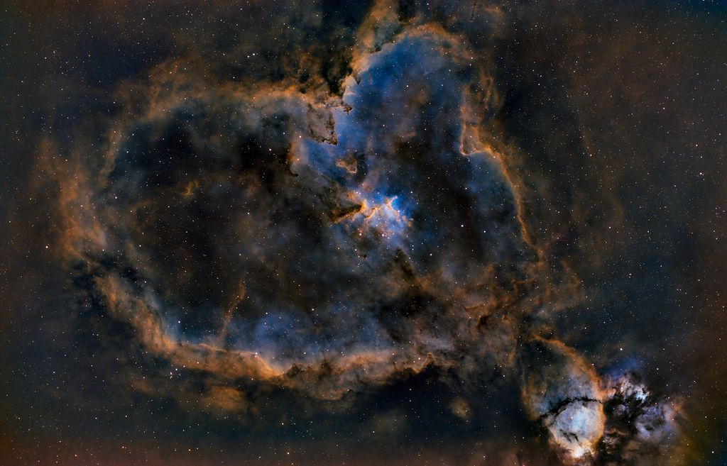

Well, I tried... Had no good noise reduction tools, so had to keep it a little dim. But hey, I definitely got the blues!  This is what I did: -SHO combination -Color Calibration -Background Extraction -Starnet -Decreased green with curves on Starless -Increased blue with curves on Starless -Messed with saturation on all colors (I don't remember exactly what I did) on Starless -Did Asinh black point increase -Did Stars and Starless recombination -Brought into Photoshop, increased highlights a little -Used Camera Raw, decreased color noise by 100%

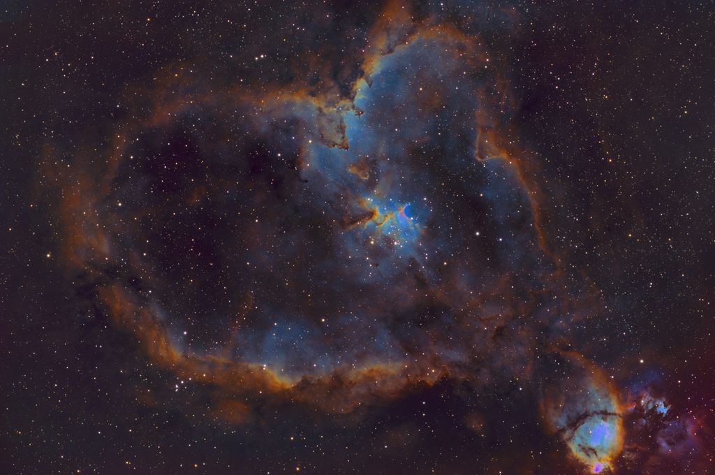

Hi. This is my attempt, I hope you like it. It is the first time I work with mono data anyway. Things to consider: SII and OIII data had gradients, so I removed them first thing individually. Also, they lacked signal, that's why it doesn't show very much. Steps: *Gradient correction (automatic convergence) on SII and OIII. *RGB combination in SHO. *BXT correct only *Another gradient correction pass on the composite image. *NXT 0.39/0.39 *Linked stretch ( I haven't tried with an unlinked stretch, sometimes it helps boost oxygen when it is not high in signal) *Star removal. *Bill Blanshan's SHO Normalization V5 with SII Boost at 1.2 and OIII Boost at 1.2 (these signals were both rather low) *Green cast reduction. *Play with the green curves to achieve the beautiful colour gradations of this palette. *Noise reduction with Topaz. *Stars back (saturated).

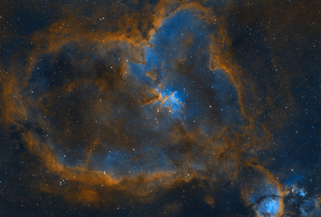

This is a SHO (Foraxx) rendering (very very weak OIII signal):  |
