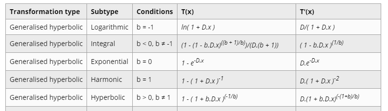

Götz Golla: Hello @David Payne and fellow astronomers,
thanks a lot for sharing your formulas and your analysis and graphs about the generalized hyperbolic stretch transformations. This is very helpful for our whole community. Thank you for taking the time !

Goetz Hi Goetz,
I agree with you, but ultimately it takes a programmer to actually put the algorithm/method into code and create a GUI for it. Thanks to @Mike Cranfield and @Adrian Knagg-Baugh for doing this for Pixinsight and Siril respectively - they are even collaborating on both. I am glad you like the process/script.
Cheers, Dave You're too kind, Dave, all I did for Siril was port your and Mike's excellent existing work! @Götz Golla im not sure if you're using the stable 1.0 series of Siril or the git version, but the version in git is more extensive and has a better user interface than the initial version that got backported to 1.0. It'll get a full release in v1.2 when that happens.

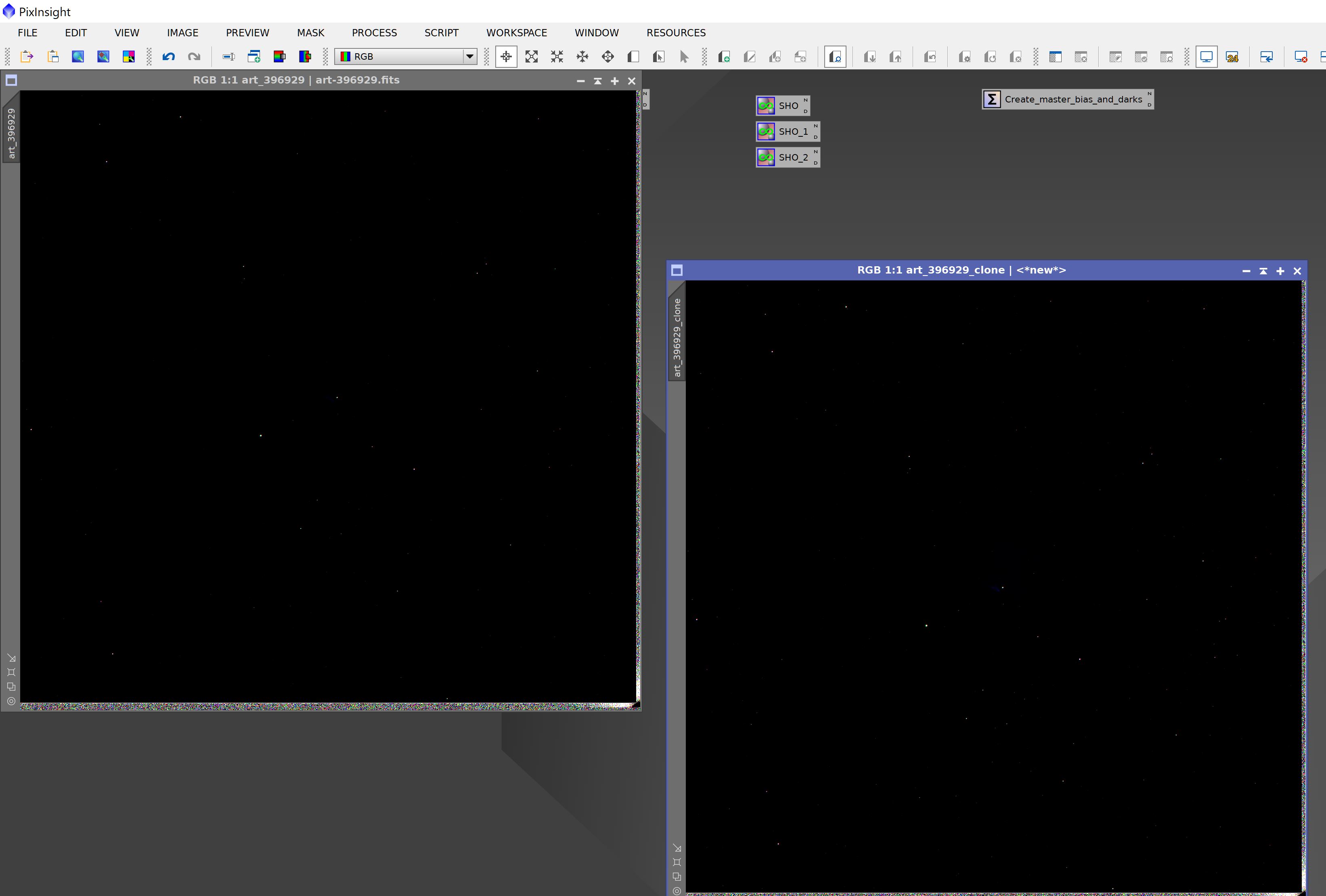

HI Stuart. THe parameters particularly D (stretch amount) is very low in the Pixelmath example. Try a value of a few hundred for a linear image.
Cheers, Dave

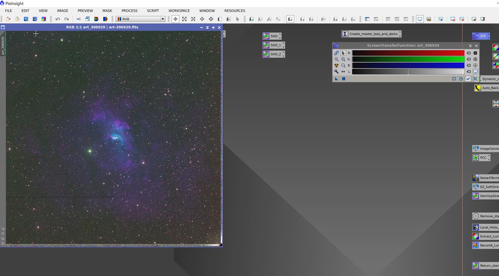

And just to prove that my image does contain some actual data, here is an unlinked STF applied to the same file
 Hi Stuart I am just wondering why you are using the PixelMath expressions rather than the script. The latter is much easier to work with! If you are having problems installing the script please let me know and I will be happy to try and help you get up and running. CS Mike
