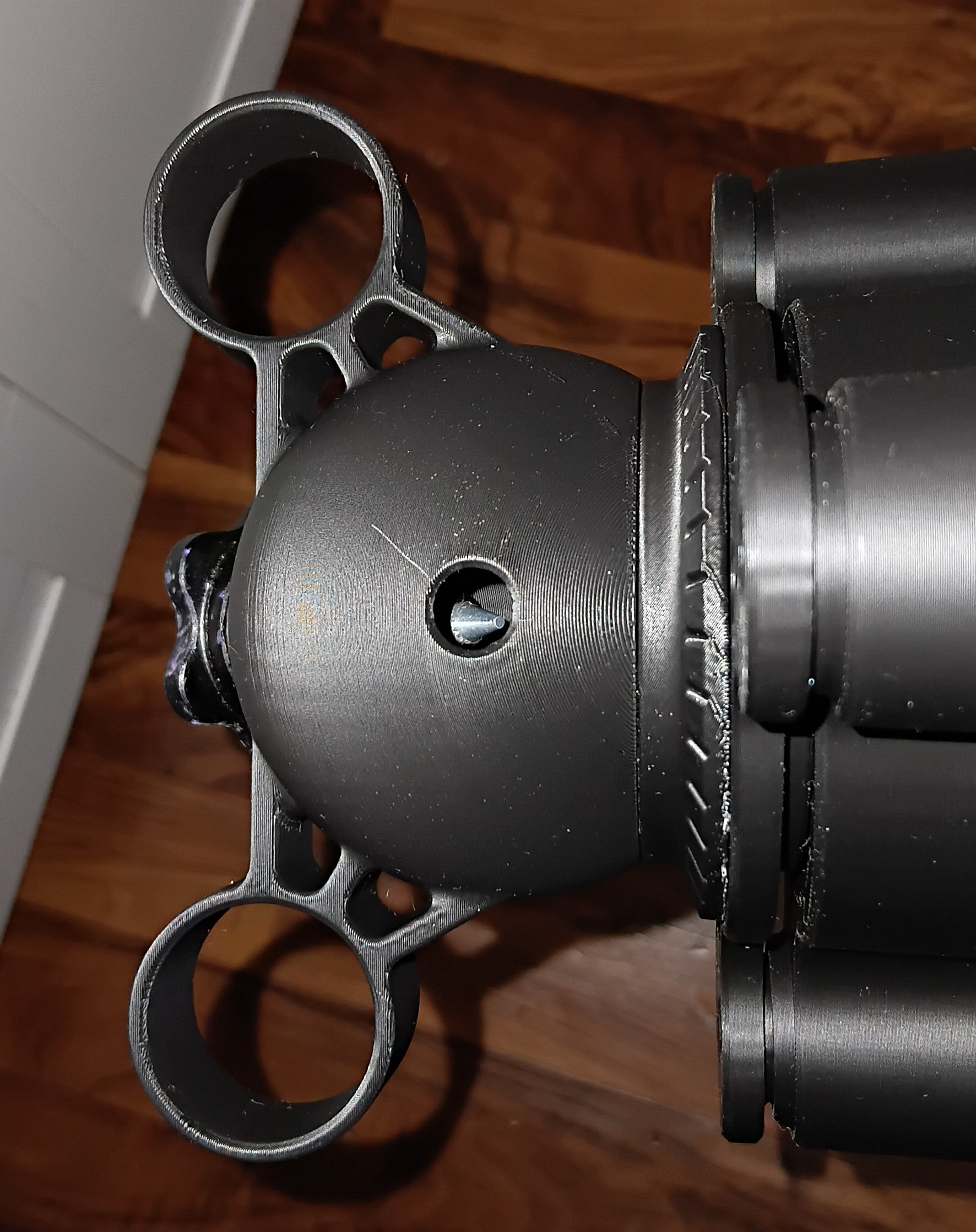

MO64 0.00

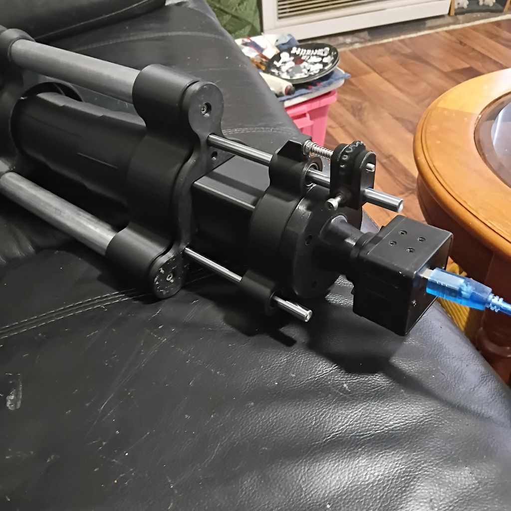

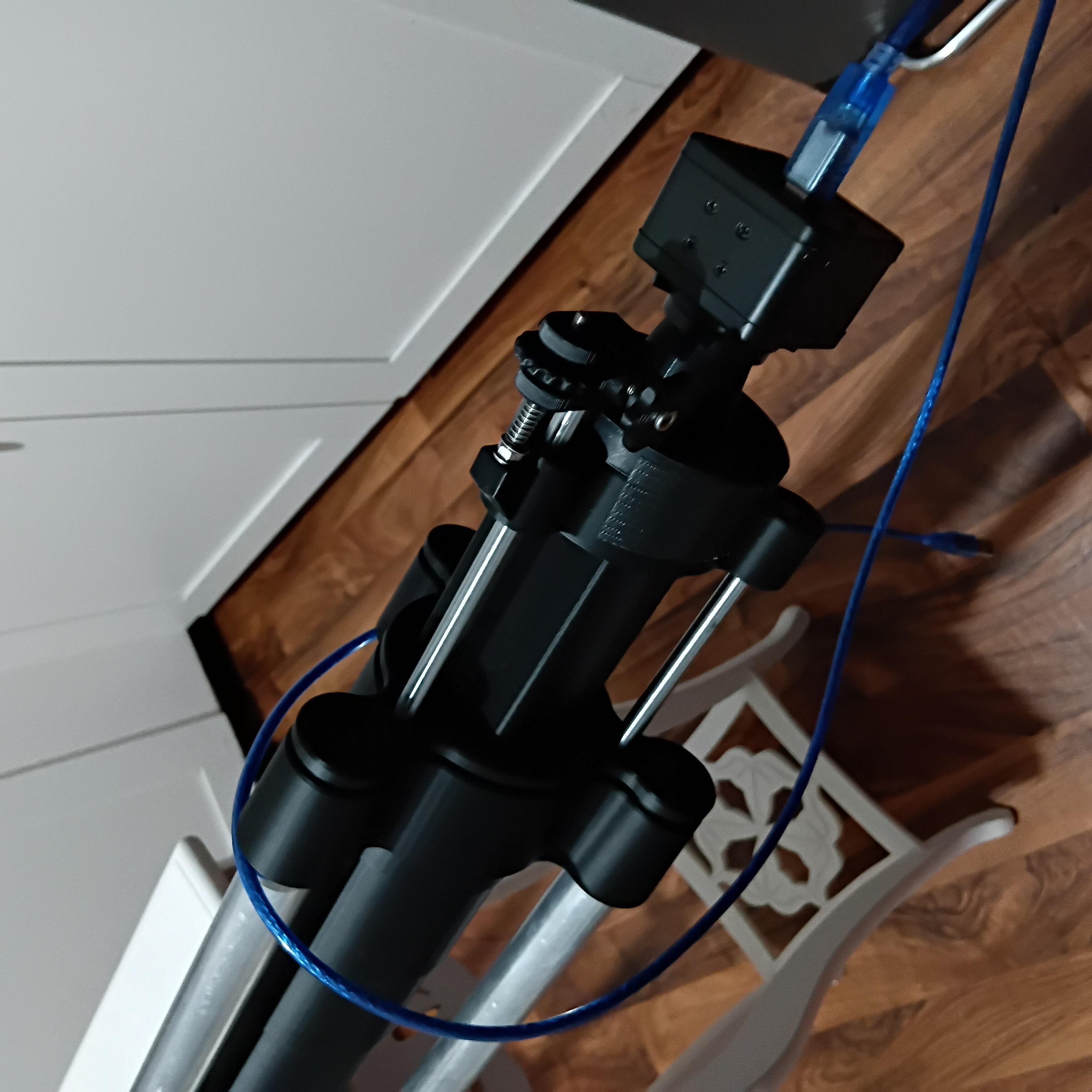

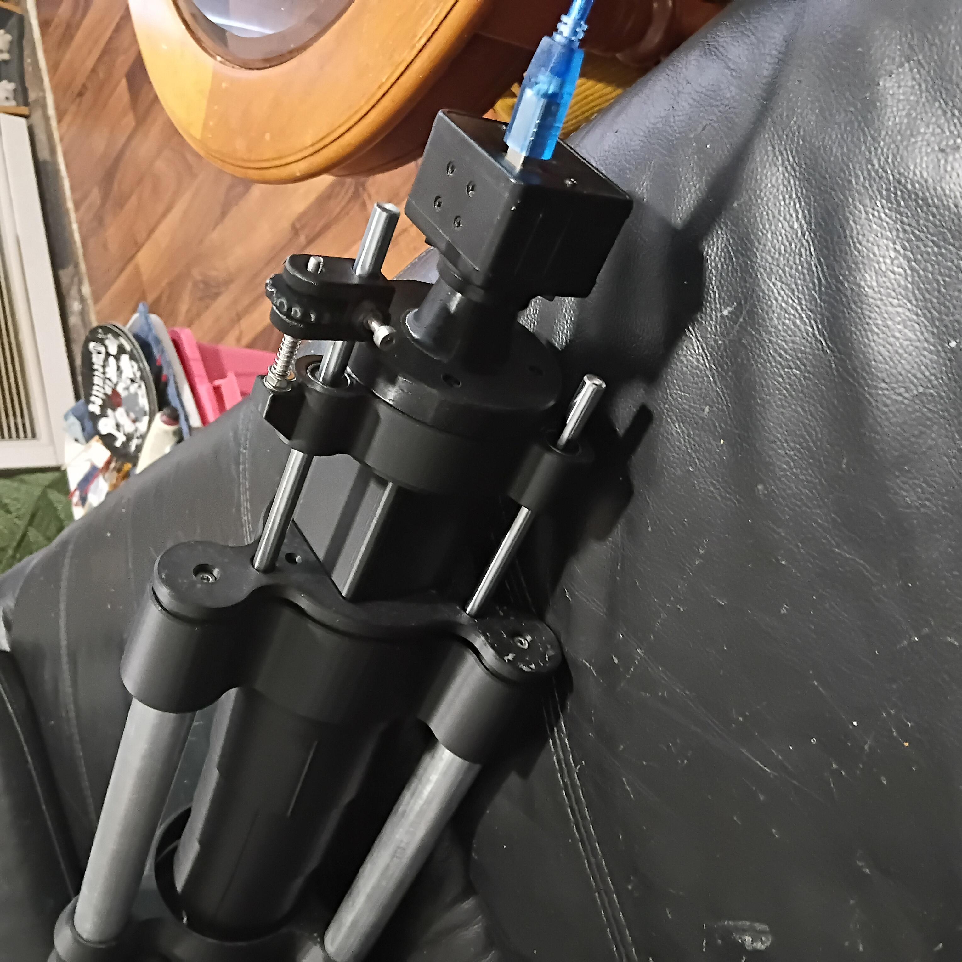

This is the focuser of the new OTA showing the 60mm square baffle, linear bearings and M4 adjustment bolt.
The main tube has been replaced with a cone 3d printed in one setup. To replace the parts I have found at work, to make it more doable.
The choice of a square baffle is to ultimately use this device with medium format film, to then scan and create an image beyond any 1 sensor. The Hayear camera is only to confirm that an image exists and it is worth proceeding to the next stage.
To which an EQ mount and guide camera would improve the results of.

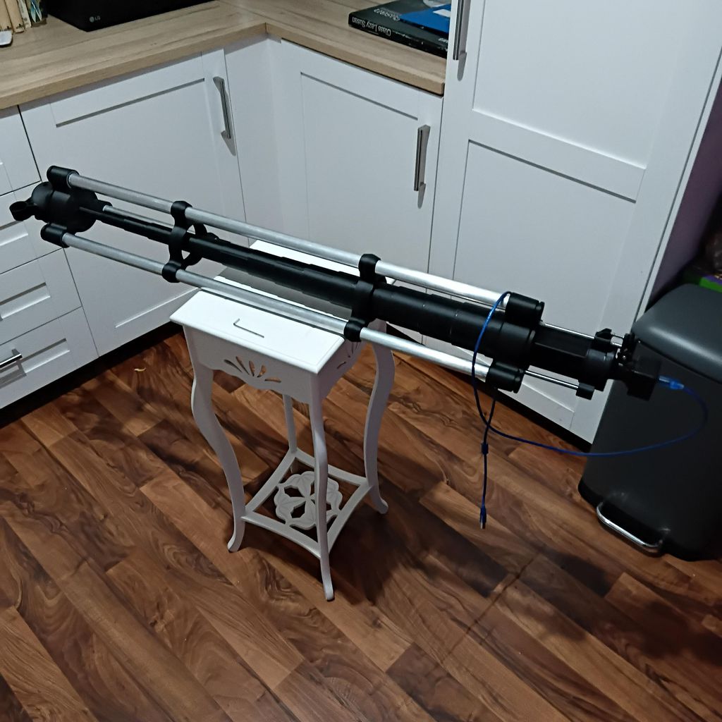

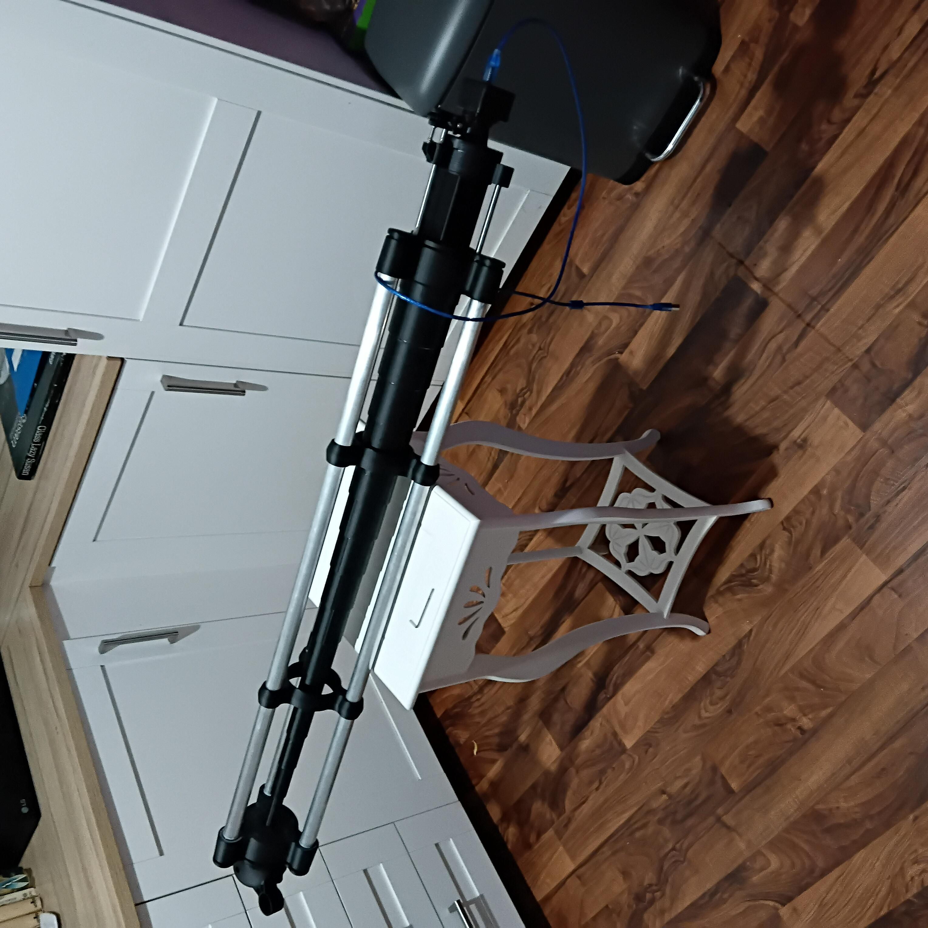

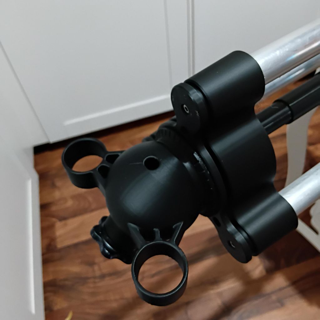

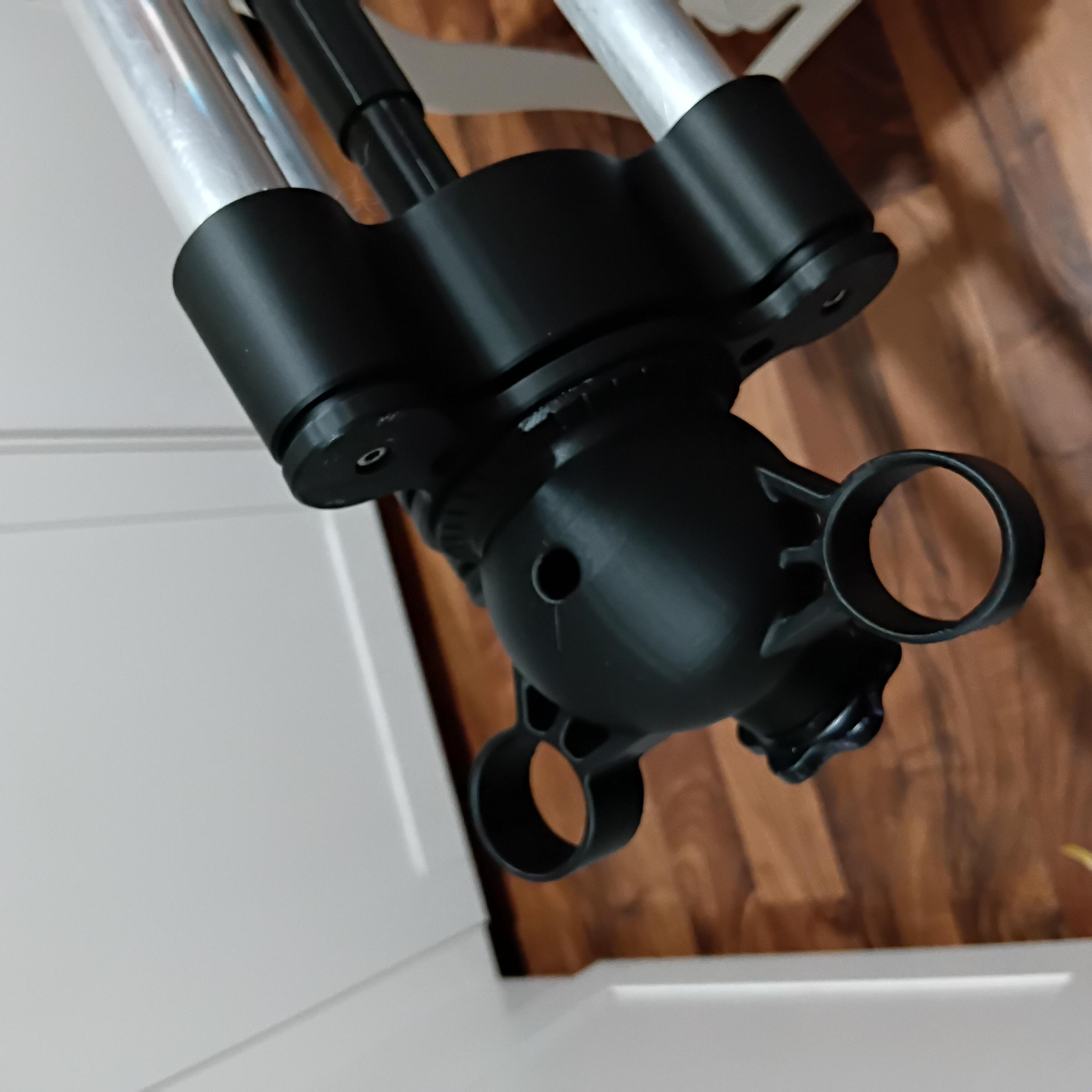

MO64 0.00
This is the finalised OTA, with 1.25" ID mouse ears to hold a guide and finder scope. Total mass is 1.9kg with Hayear camera. Polishing jig redesign is the only thing left to do, as far as improving the image.
