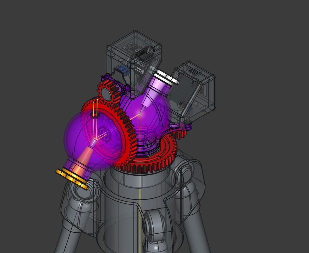

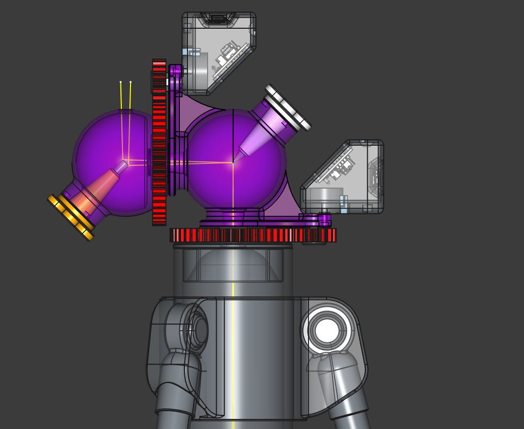

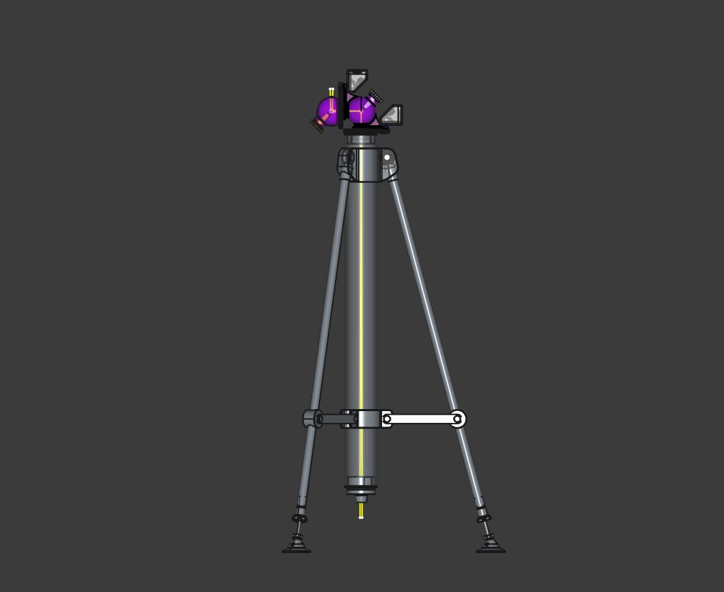

I have never liked diffraction spikes, they indicate artifacts across the entire field of view, both seen and unseen.
This was my attempt to solve the issue:
Design 201910056 | IP Australia | Australian Design Search
I designed this for my grandson, who has since died from meningitis along with any interest on my part to finish it. I had registered the design without considering the possibility that it was patentable. Which it was, until I registered it and had it certified. However, the design does have a flaw in it, but I have redesigned it so that it is patentable again. But my interest is still not present.
I have attempted to finish it, but also found it had a negative impact on my overall mental health.
Not being able to switch off my imagination led to the subject of this post.
I have a proof of concept image, which I posted in the EAA group. The image quality is irrelevant and is an effective filter of people who understand what they are seeing and those who don't. Did I mention it is out of focus, which revealed a mistake in a calculation I made to build the device. From failure comes success, etc.
With the success of the first light image, I have the protype designed with R.A. &  DEC, polar alignment and tracking. The only sticking point now is getting time on the machines at work I need to use to make the parts. The design does not use the bucket method and is not bound by Dawes limit. Also, it is full aperture, unobstructed and does not use any refractive elements. The incident light has a clear path from the primary element to the sensor.
Unless you are willing to pay for a patent, I cannot give any more details.
But I will be posting the images on this site only and look forward to some clarity.
I am not sure how a critique can be given at this point, but that's Heisenberg for you.

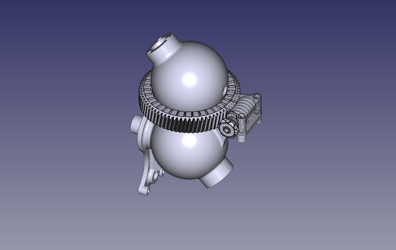

The final design has been decided with which to test the theory and a formula to describe the concept. I don't have the resources to build constantly improving iterations, I have the offcuts at work and a 420mm OD deep groove bearing from the bin. The bearing will form the base of the main stage that is polar aligned to provide tracking.
Concept of Relative Pixel FOV: Relative Pixel FOV is calculated based on the pixel size of the camera sensor and the effective focal length of the device. It represents the angle in arcseconds that a single pixel covers on the sky. A smaller relative pixel FOV indicates higher spatial resolution, allowing finer details to be captured in images.
Relative Pixel FOV (arcsec/pixel)=2×atan(Pixel Size (microns)/(2×Focal Length (mm)​)×3600
I have an issue with procrastination and have therefore imposed a deadline of June 30th, 2025. Why, why not!
The final device is still based on pinhole theory, just in a considered way. The primary element will be a 1/20th wave, pinhole sized diameter, that converts any light entering the system into incident light with a fixed absolute FOV. The platform anchored to the main bearing contains 20 secondary aluminum reflectors, with each adding 500mm to the total focal length and a proportional reduction in relative pixel FOV. The primary has the option of being coated with different materials to effectively provide an unobstructed form of wavelength filtration without affecting the source light using optical components.
The primary targets, once built and calibrated, will be the 20 closest I can see from my location. With M92 being of interest, with the Pop 3 potential. With the device configuration, measuring spectra is just a sensor module swap over.
I would apologize for any errors in the formula or theory, but it could be intentional, so I won't. smile

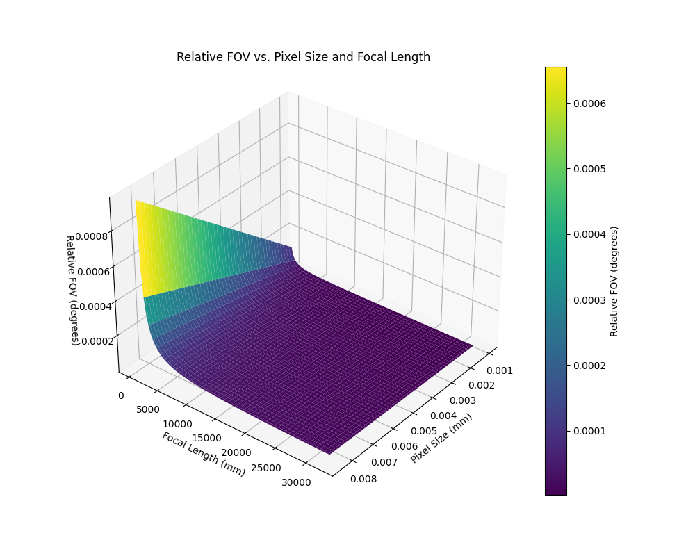

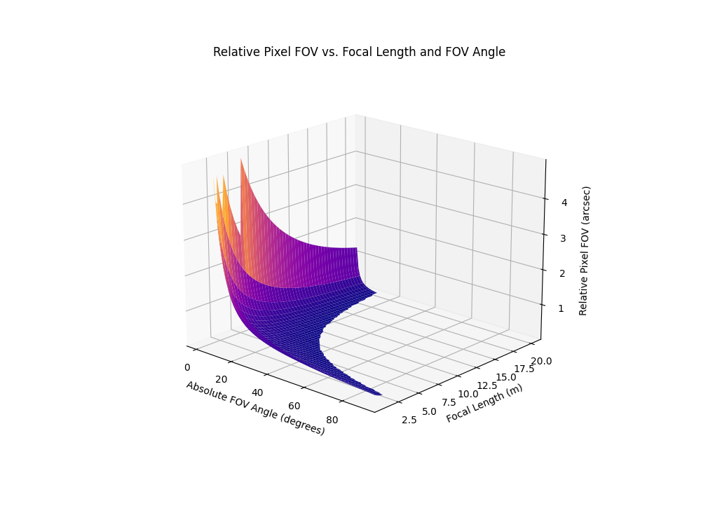

The following are 3D plots made using the formula posted recently to show the relationship between pixel size and relative FOV.
With the device to test this theory.
PolarPlatform02.pdf
Stay warm.
Paul

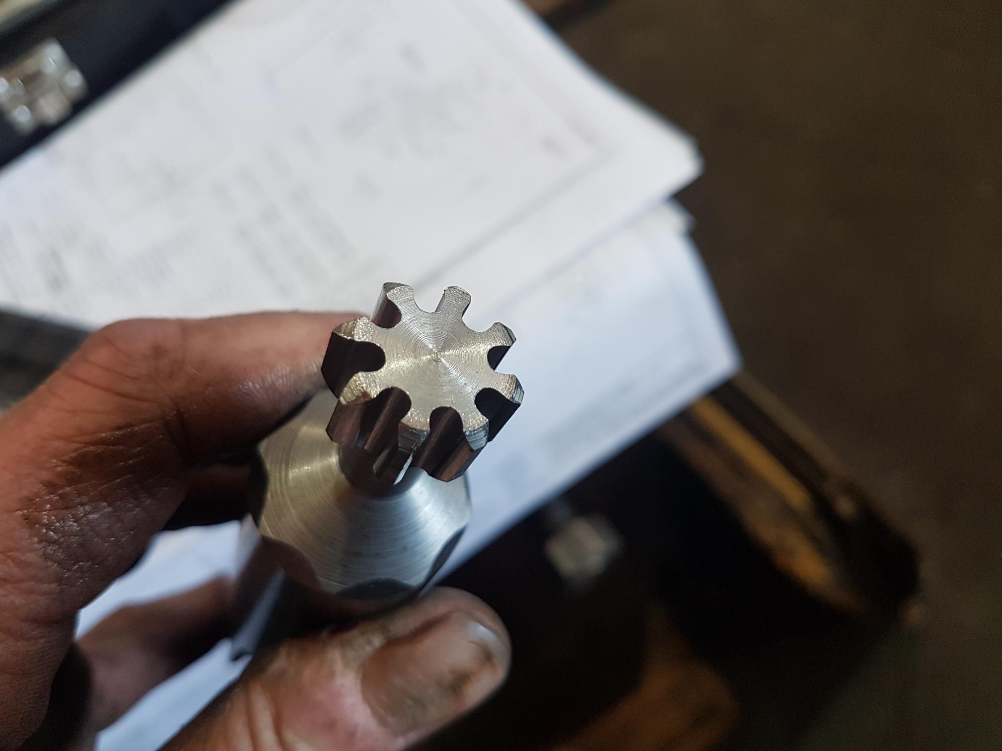

A funny thing happened the other day, while working out how the hell I was going to build gears accurate enough for the tracking unit, and then I did. As soon as I get some IP protection, I can't really say any more. The result is purely to test the theory and will not be used in the final device.
Although, it did remind me of the principle behind projects that stretch the imagination or budget. If the individual or business can afford the loss, the IP harvested from the effort is usually worth it and usually responsible for the blow outs seen historically. I don't like the way the patent system is used to possess another's thought, luckily it was mine, existential crisis averted.
The next biggest issue will be the 1/20th surfaces for the other bits.

This seems like a lot of trouble to address something that really isn't a problem; but...ok.  The use of a prism will introduce spherochromatism and some field issues.  How are you going to handle that?

The project that will replace the one registered does not use a prism and should not suffer from spherochromatism, due to all of the surfaces being reflective and planar. Also, it is completely free of any obstructions from the aperture to the image plane, which can only improve image quality.
Paul

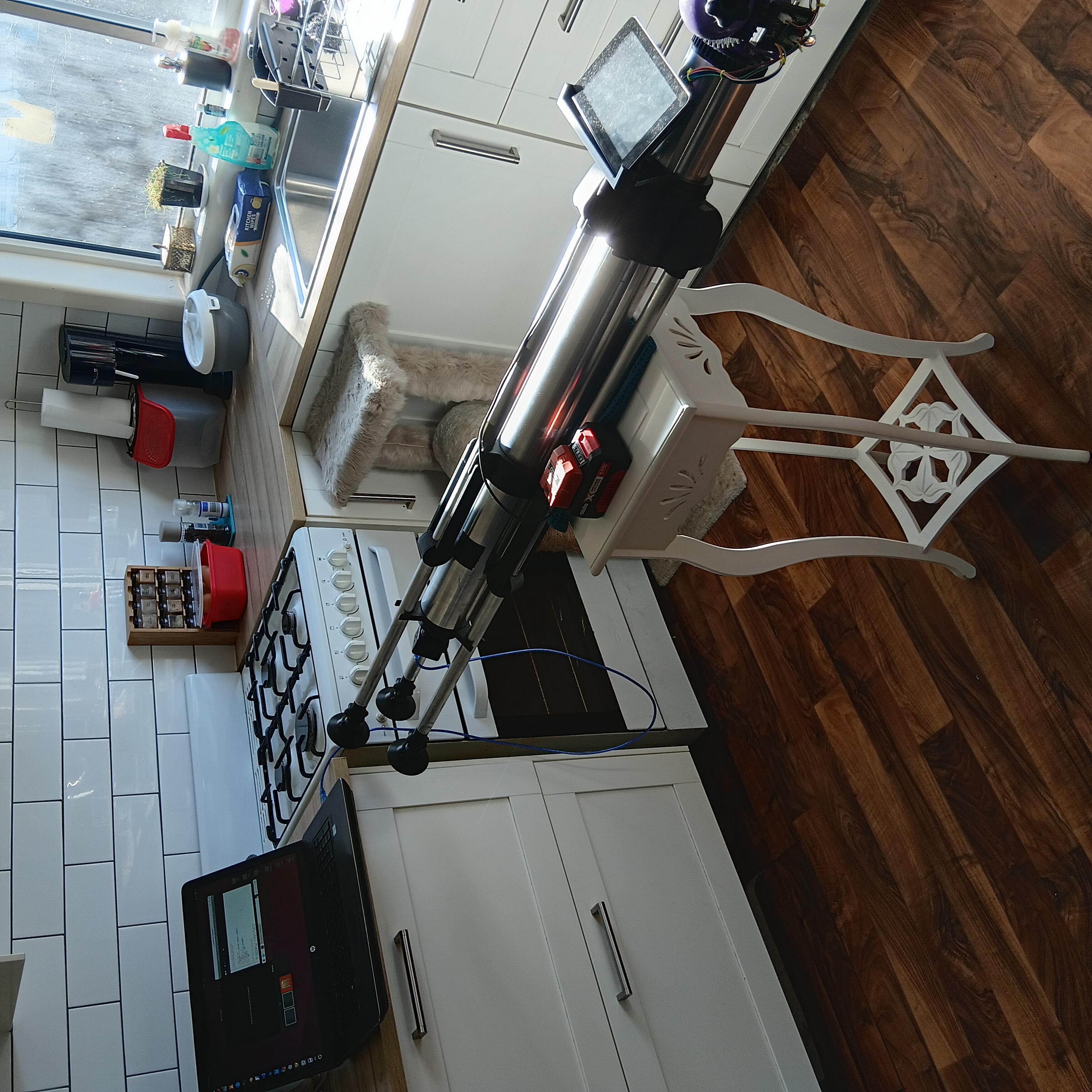

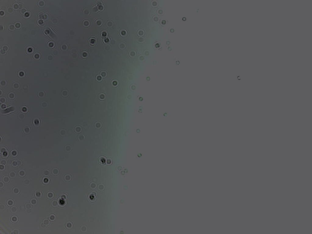

This is the first image from the device shown, which shows the concept works and everything lines up. The horizontal orientation is due to the standing height being outside the rays coming through the window.

I clearly need a better CCD, but the sensor I have will work, until the reflectors are as good as I can get them.

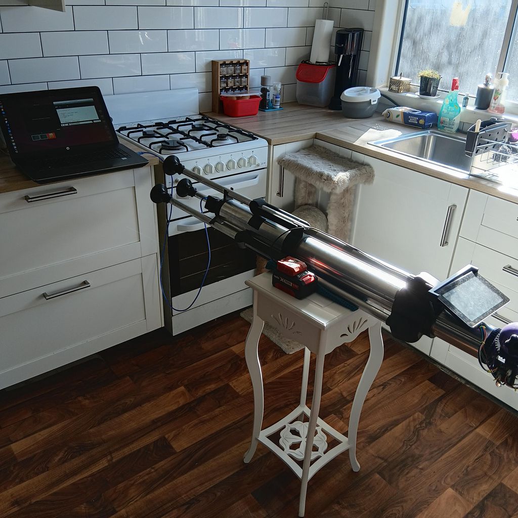

After failing to capture anything beside the Sun and struggling to point it using the 3:1 spur gear, I have started printing a 36:1 worm gear alternative, that will be manually operated until the images are improved. Which will require a redesign of the polishing method and jig, etc. The Raspberry Pi only presents a possible barrier for making one, so it could be considered an upgrade, if desired from this point on.Worm_Config.png
MO64 0.00
The primary element was the wrong diameter so the image was out of focus, which means it was behaving as expected, if I had realised the error before even trying.
The only true test will be a globular cluster or galaxy, which will require hardware I don't have, so the image will be some time.
