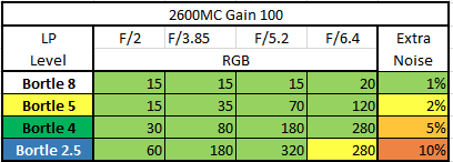

Your sub-exposure lengths are also excruciatingly long for broadband at F/2. You are needlessly blowing out the stars while having them bleed into the surrounding pixels for very minimal gain.
Here are the sub-exposure lengths I use for the 2600MC depending on the light pollution and what focal ratio I am at. The "extra noise" is the total extra noise from stacking.
While I can respect not wanting to store and stack hundreds of frames, you should consider shortening your exposure time to at least 60 seconds.
