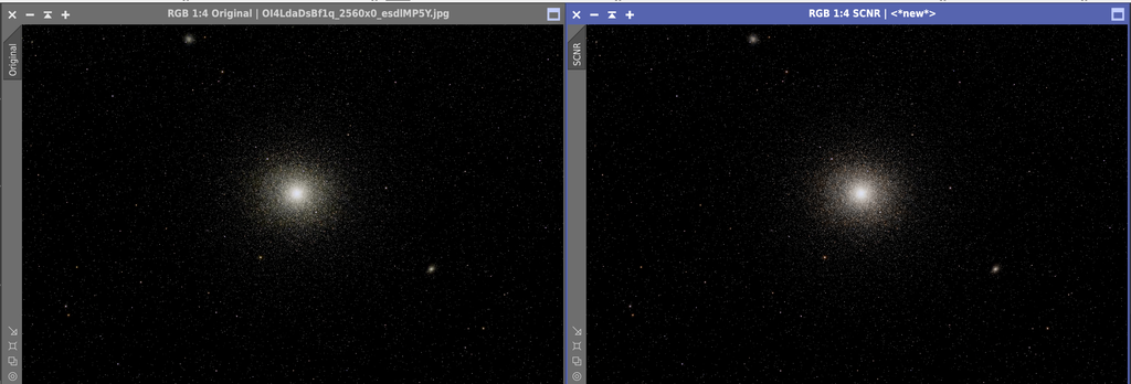

Niels_L 2.39
I am not an expert what so ever, but it looks a bit green? I downloaded your last update (could only download the jpeg) and did a SCNR to remove the green. Maybe try it out?

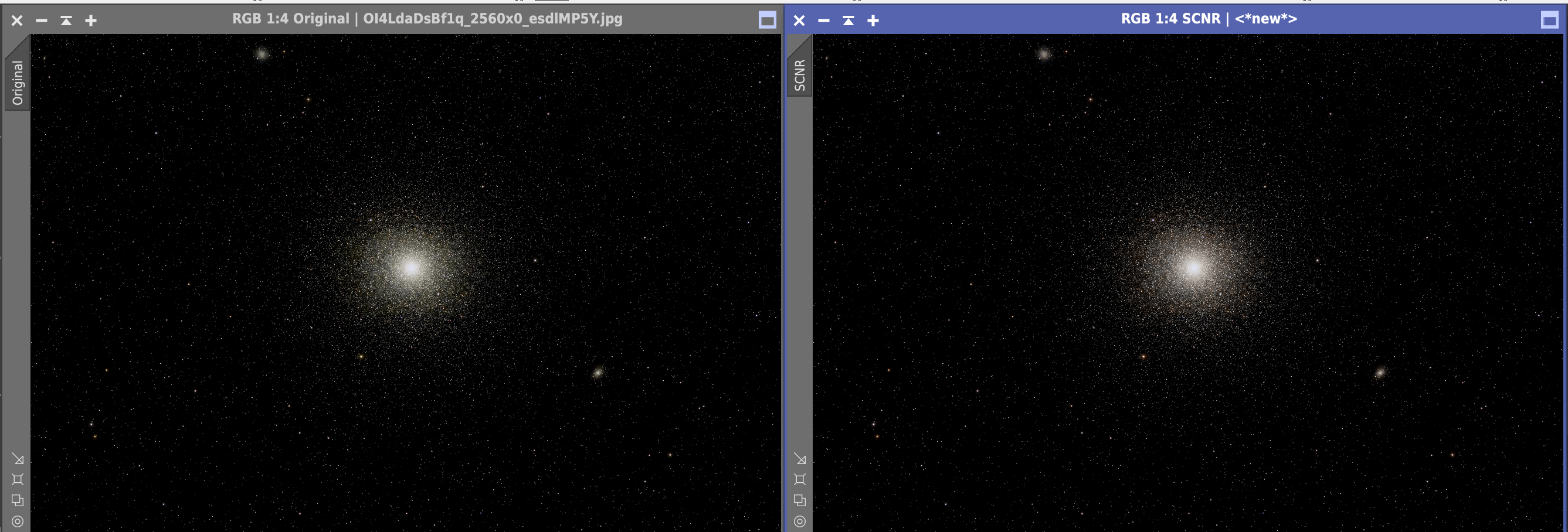

Niels_L 2.39
uploaded a final image
Looks much better! Loving to see the progress!
I did a quick SCNR, see below.
