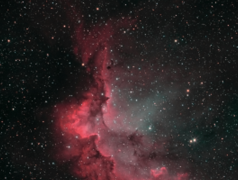

I am trying to determine why my images are "soft". I've never been able to finish with a nice clear and sharp image. It's either one or a combination of seeing, equipment, processing. I'm leaning more towards equipment, telescope specifically. Considering a .8 flatenner reducer, down to f/4.8.  The Wizard Nebula SH2-142Bortle 7-8 Astrotech 60ed 360x60mm f/6 doublet zwo 533mc pro 100 gain 35 offset 180 sec total of 9.5 hours L extreme filter Dark,flat,bias Processed in Siril (based off of Deep Space Astro yourube) Graxpert for background extraction and noise reduction Starnet ++ star processing
IMO, that sharpness looks normal for processing with Siril
you need BlurXterminator, but it's a tool you can only get for Pixinisight
also, if you're not already using it, an EAF would (generally) give you better focus than a bahtinov mask, so make sure you use one
Have not pulled the trigger on PI yet. An AEF is one of my next purchaspurchases. thanks

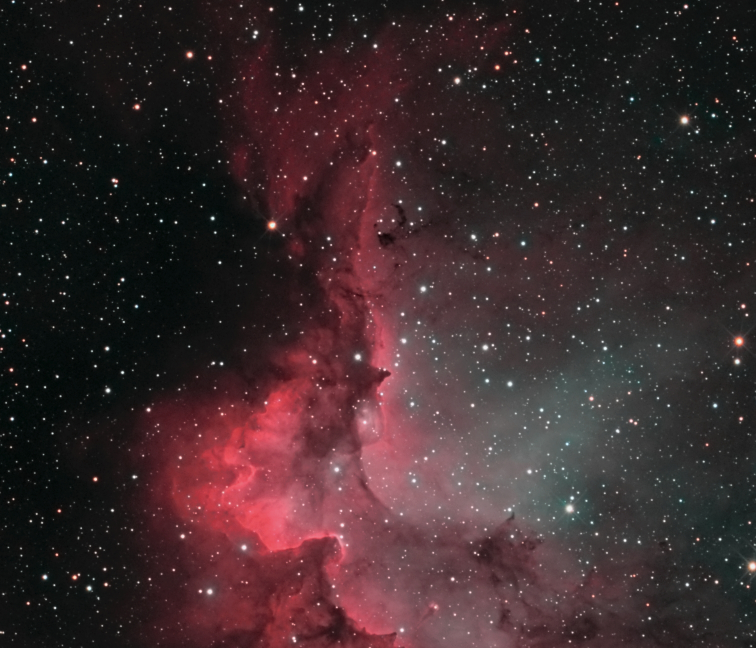

also, if you're not already using it, an EAF would (generally) give you better focus than a bahtinov mask, so make sure you use one I think that you need some level of oversampling to get the best out of Blur Exterminator-- the sampling looks too low here and the image scale too great with 6 arcsec/ pixel to get sharp detail? The key problem may be that the image is undersampled ? If seeing is 'normal' at say 3 arc sec then at least 2 arc/ pixel would be needed to sample it near adequately. The 360 mm f and ASI 533 setup should deliver that but the picture posted here is apparently at 6?! Was that because of binning? Even at 2 arcsec/pixel there would surely be too little information for BlurXt to be able to provide much sharpening ? If you integer downscale a fairly sharp image of the wizard at 0.9 arcsec/ pixel to about 6 it starts to look really quite soft as here   |

Your pixel scale is horrendously undersampled at 6 arcseconds per pixel. The reason for that is that you are using 3xbinning. That makes your pixel size effectively 11.28 micrometers and divides your resolution by three. I'm sure you've done it by accident. My advice would be to immediately turn it off.
Nooa Jutila: Your pixel scale is horrendously undersampled at 6 arcseconds per pixel. The reason for that is that you are using 3xbinning. That makes your pixel size effectively 11.28 micrometers and divides your resolution by three. I'm sure you've done it by accident. My advice would be to immediately turn it off. I have gone through all of my settings and I don't see where the issue is. Running Nina, it's set on bin 1x1. I've never made any changes to the camera side, that I know of. do you know of a setting in siril that may be doing something on the processing end? Edit: I figured it out, I had reduced the image size when i downloaded it to my cellphone then to Astrobin. The original image is 2447x2447 @ 2.92 MP
