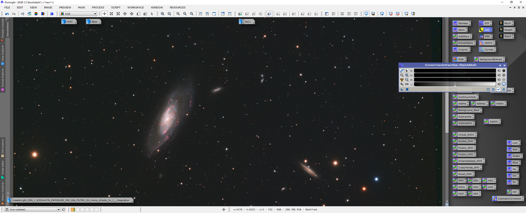

StarX and Starnet will remove smaller Ha structures like in galaxies.  Highly recommend not doing that.   The any artifacting in the stars will 95% of the time get covered with your broadband stars.
This is not a complete image, only a WIP, but this is like 3 hours of RGB with my 36+ hours of Ha. (I just wanted to see the structures) Absolutely no StarX or Starnet was performed in the Ha layer.
StarX would have eaten all the little structures in the bands of M106

You do need to remove broadband stars, at least as far as I know.  You don't need to remove narrowband stars.
That being said, for bright targets that don't have small structures (like those found in galaxies) I will do starless prior to continuum subtraction.    It's all about preserving the details. StarX can be destructive if not used carefully.   Bright nebula and such you don't risk losing data.
My generic flow:
Create starless RGB image
Combine HRR to perform continuum subtraction.
Curve, denoise, and (almost) clip NB signal.
Use pixelmath to re-add Ha NB.   Perform multiple times if needed to boost the signal/structure.
Add RGB stars on top.
That's exactly what took place in the example above.   The RGB data is weak in that tho, so don't read deep into it.   It was purely what I had that I could share.
