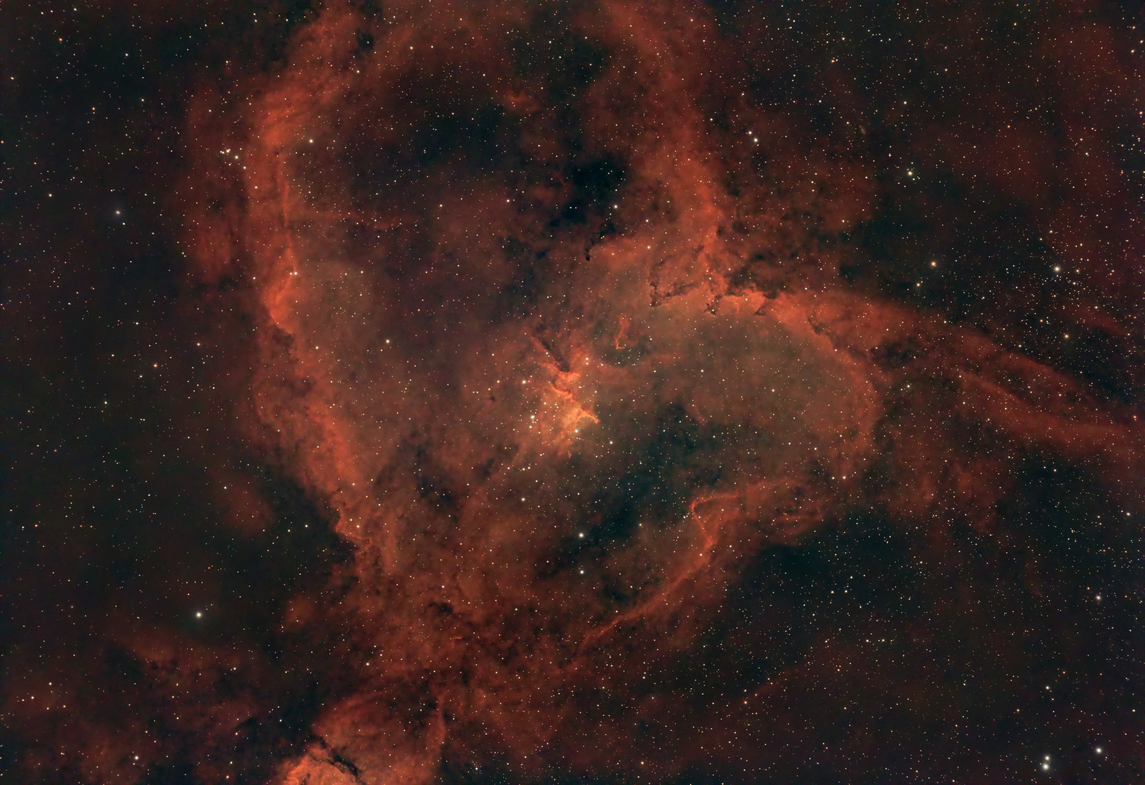

I am struggling to edit the Heart Nebula in HOO palette. My calibrated frame is made of:
Lights: 58 frames x 300 seconds at 120 gain (~4.5+ hours of image)
Darks: 33 frames x 300 seconds
Bias: 60 frames x 0.001 seconds
Flats:40 frames x 0.14 seconds (auto generated by ASIAIR)
Equipment: ZWO ASI294MC Pro Color camera, Optolong L Extreme filter
Other context: Bortle 8-9 sky, Taken at elevations 30 to 60 degree over 1 night
So far, my workflow has been: Dynamic Background Extraction > Spectrophotometric Color Calibration > StarNet2 Star Removal > Noise Exterminator > GHS > Masked contrasts and curves. Any attempt to bring out more details ruins the images because the data quality is not very great.

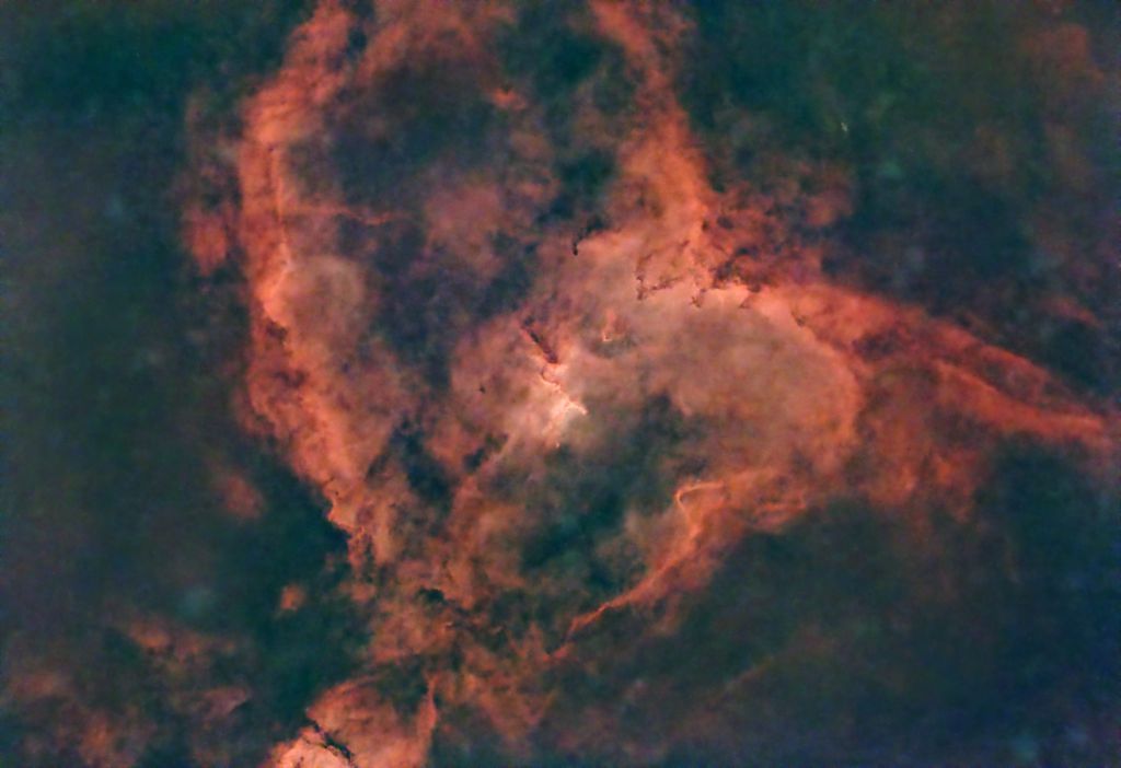

Once I have done this, I tried to run narrowband normalization (HOO, SHO), but the images I am getting are very weird. I have posted two images - the first one is without any normalization, the second one is after HOO normalization. Is this normal to expect in narrowband normalization? If yes, would like to see your recommendations on post-processing.
While I definitely understand that higher integraton length and better seeing will improve the quality, I am curious to see what is possible to generate out of this dataset!
I am attaching the link to calibrated frame generated using the following data set, as well as the outcome of processing. Posting only starless image as I did not have RGB lower exposure of stars yet. I would concur that the seeing was not very good (there were high clouds), so likely the image quality is not very good compared to the integration time. However, I would still want to understand how to make best use of OSC using dual narrowband filters.
Link to calibrated frame (Contains .fit and .xisf format in zip folder): https://drive.google.com/drive/folders/1XLXK4TMTQYj7i1_OLs1FH_MKpwaGIq1t?usp=sharing
mxpwr 7.29
You have some nasty gradients in your image. Once you get those removed, you can get a passable edit out, considering the low exposure time.
In case you have a widefield view of the heart, you can use this technique to better remove the gradients.
https://pixinsight.com/tutorials/multiscale-gradient-correction/
Though accourding to PixInsight announcement, the new MARS data base will be released with PI1.9 any day now.
https://pixinsight.com/mars/
I had been using DBE, with subtraction. Anything major and different that you tried out? I really like the way your image has come out.
mxpwr 7.29
D. Jung:
For this image I used seti's AutoDBE (masking the heart) and PIs DBE and gradient removal process.
However, if it was my own image, I would have used my wide field shots. Usually gives superior results when the gradients are that messy.
You can see that in my edit here, the contrast in the central region lacks. Probably due to false background removal.
Have you done any data culling? Some of your imaging time was at 30 degrees which is very low. This will for sure hurt your image quality. I think PI has some great tools for looking at the quality of your frames so I'd start there before you worry too much about colors. I know it's hard to throw away data but it's worth doing in the end. You're also not helping yourself by taking such long subs. 120 sec or even 60 sec will be sharper. The read noise is very low at a gain just above 120 so that's where you should be if your going to do this. If you do cull your data you'll loose less time overall with this approach.

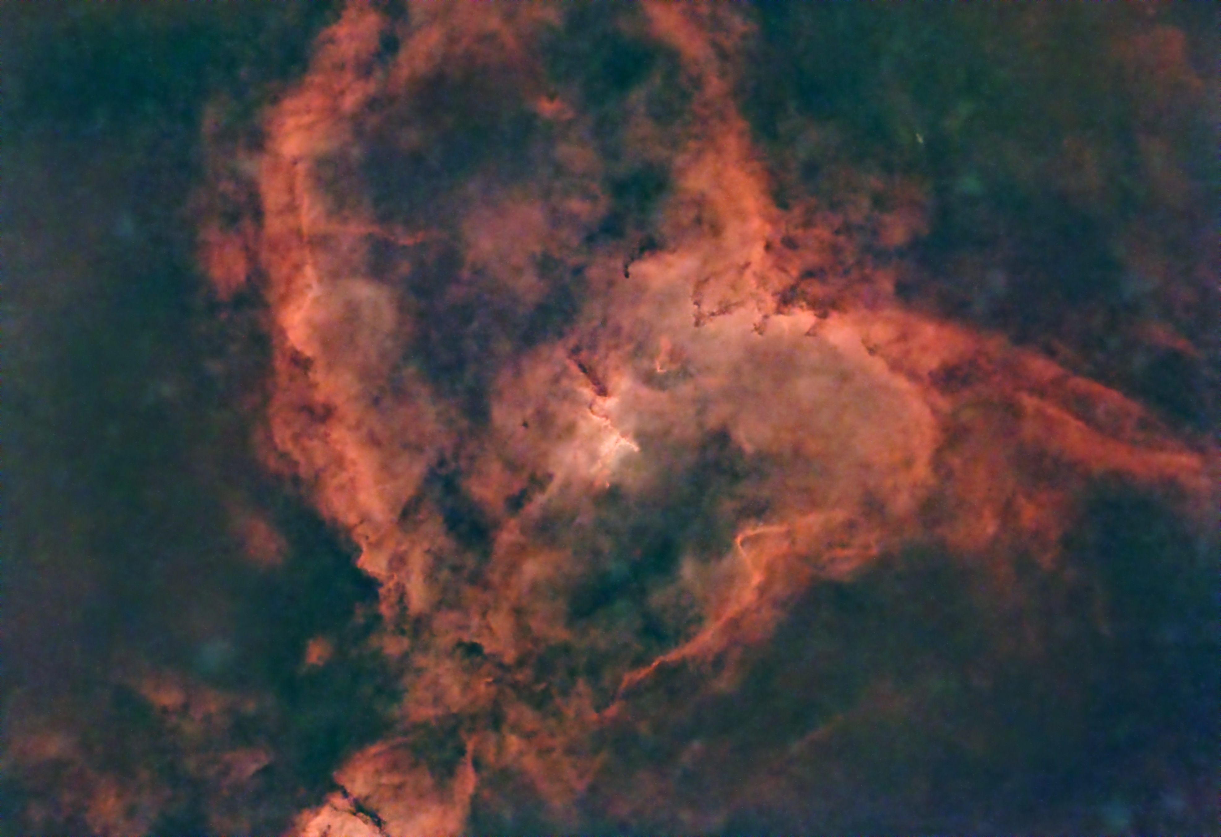

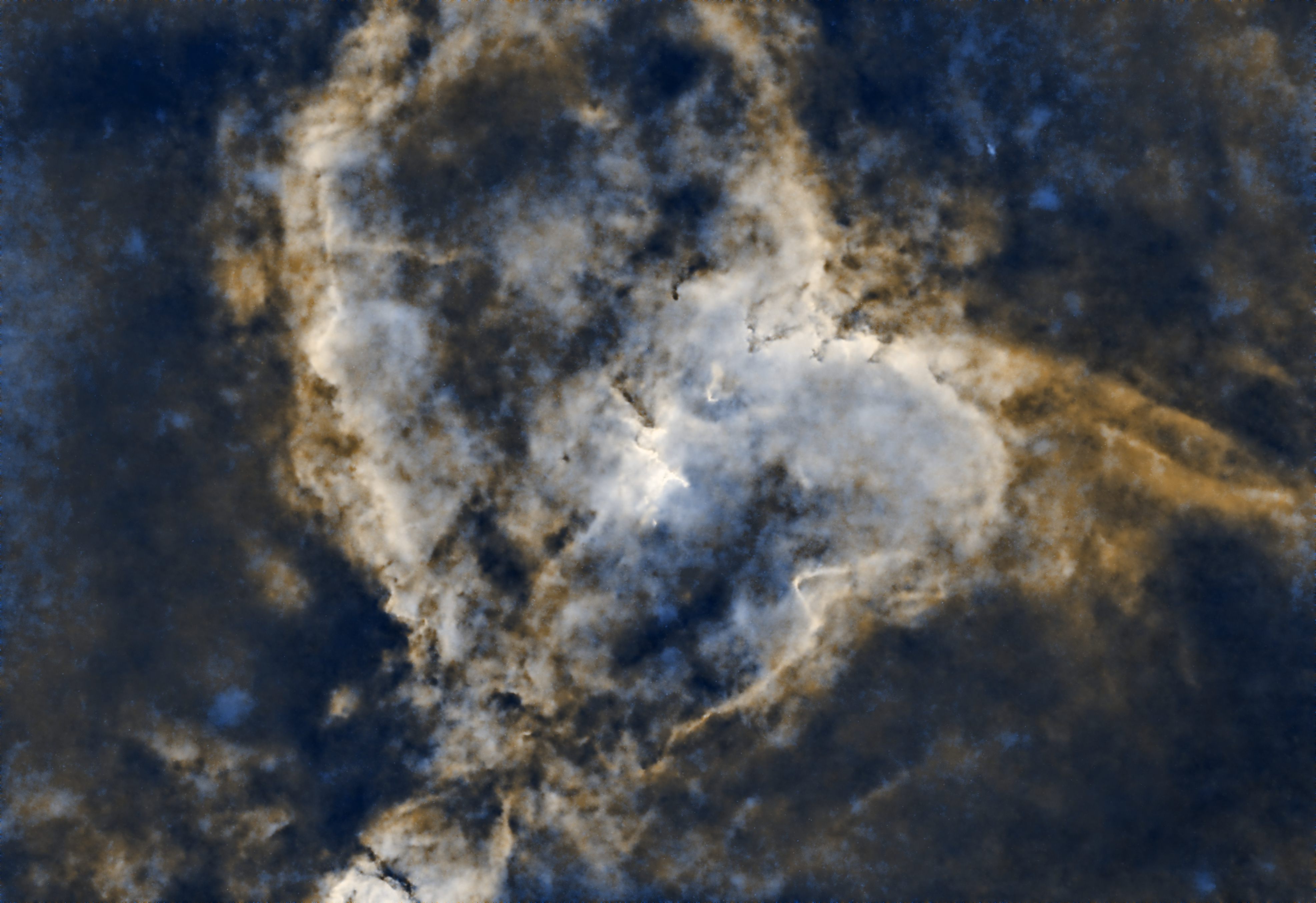

Took a second pass at trying to edit the image in standard RGB palette, and an HOO palette. It is my first attempt to post process in HOO Palette, so request your feedback and improvement areas!
mxpwr 7.29
Some things you could consider:
- A little bit of noise helps retaining sharpness. You could try noisexterminator at .5 and use it multiple times until you reach the desired nose level. And use a mask to protect the nebula
- maybe apply a little less blurrxterminator. Over sharpening stars tends to move towards saturation and lots of color. A little blurred states often look more natural
- you could play a bit with the colors. Use an inverted mask on the nebula and change RGB until you reach a good level of red/blue. That helps keeping the background black while changing the color of the nebulosity
Don't change anything if you like your image. It's for you not for me smile

I agree, i pushed noisexterminator to 0.9 in first go. I havent purchased blurxterminator, so I used PixInsights built in Deconvolution. But I agree it has made it a bit too sharp.
I did not have RGB colours, and my narrowband stars were indeed very saturated due to long exposure. I just used Narrowband to RGB stars script for now, but definitely will revisit once I have more data for narrowband and separate shorter data for RGB stars.
