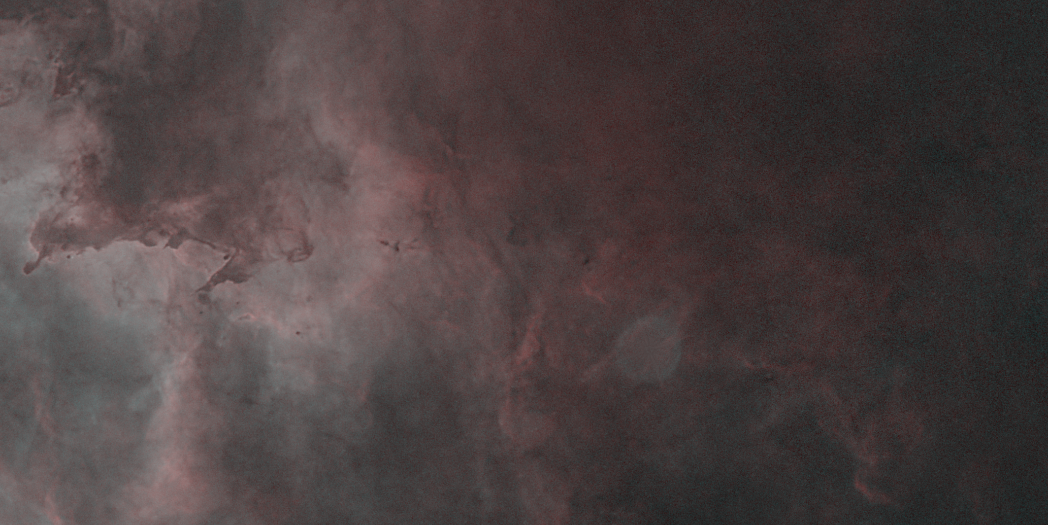

@Brian Puhl Here is a crop of a pure HOO autostretched part of the image. The denoise abuse comes certainly from the fighting with that noise.

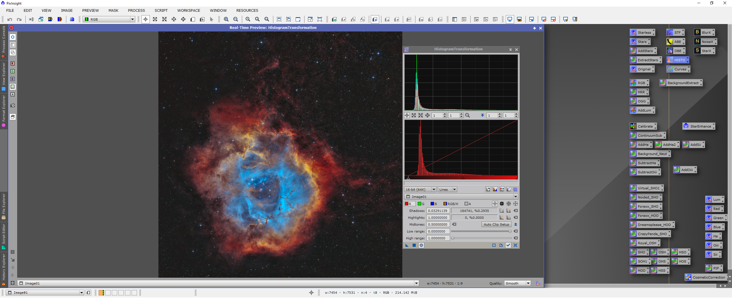

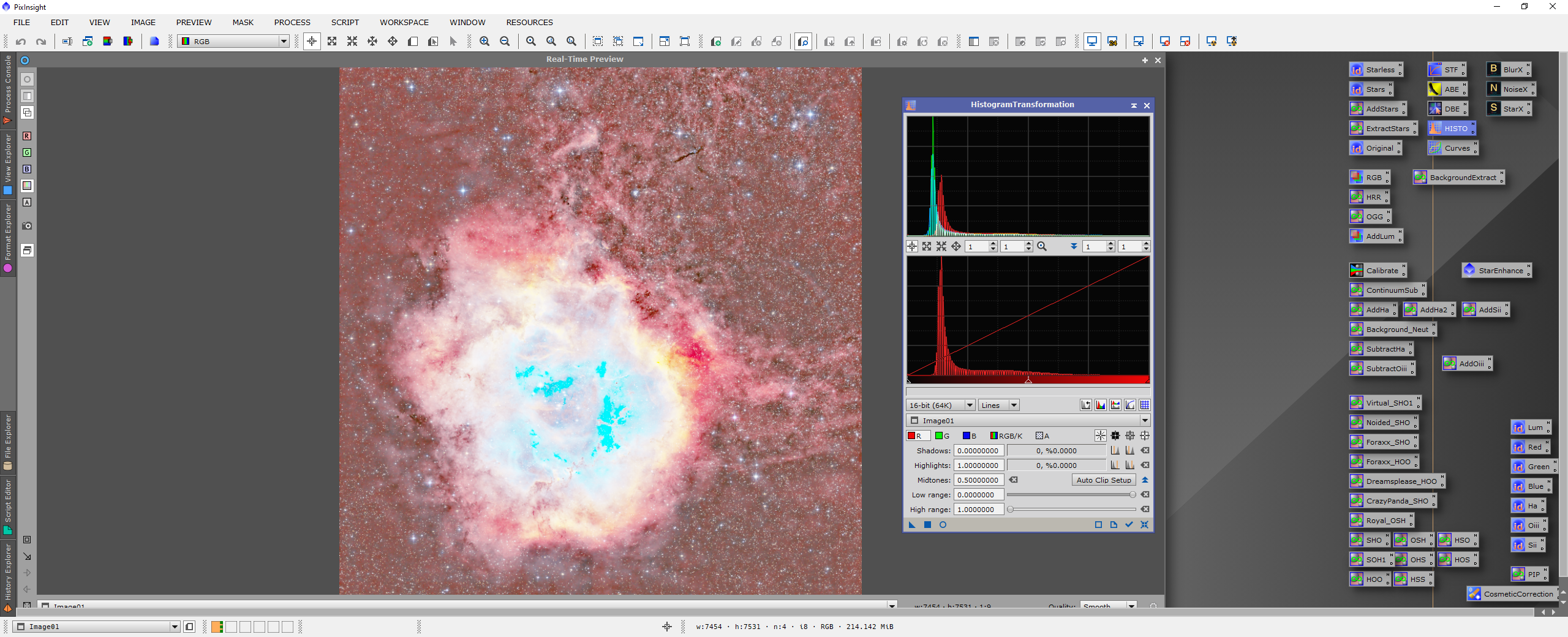

I think you should have plenty of signal for all the Ha structures in this image.   18 hours is alot for Rosette,  which honestly is one of the brightest targets in the sky.   It will just come down to massaging the curves a little better.       I would take your Ha and Oiii channels and process them seperately, stretching them and curving the background appropriately.   If I'm reading it right above, you processed them them in the linear stage, combined, THEN stretched.   I'm not saying it's wrong to do things this way, but I prefer a stretched combination.     For ensuring the background is curved appropriately, I suggest using the super-nuke button (boosted stretch), and if the background lights up like a flat panel, you'll know you need to tone it down more.
*Boosted stretch revealing the background issues*   Note the histogram misalignment
As for the stars, I like to keep it simple, especially for your sake of learning.    When you extract stars, Starnet and Starx both keep the same STF applied that you had in your linear image to the extracted layer.   All you have to do is drag that STF from the stars over to the Histrogram and apply.  Your stars will retain the natural stretch they had.    If you want your stars more relaxed, you can loosen the STF sliders a bit before extraction.    Once you've stretched your stars, you can add saturation with curves.  Once happy, you can re-add them to your NB image with Charlie Hagen's guide that i'll link here.
https://www.nightphotons.com/guides/star-addition
If your final image has a red background again, you can fix it pretty easily by aligning the channels in the histogram.
*Background is a more neutral black, and histo is aligned*

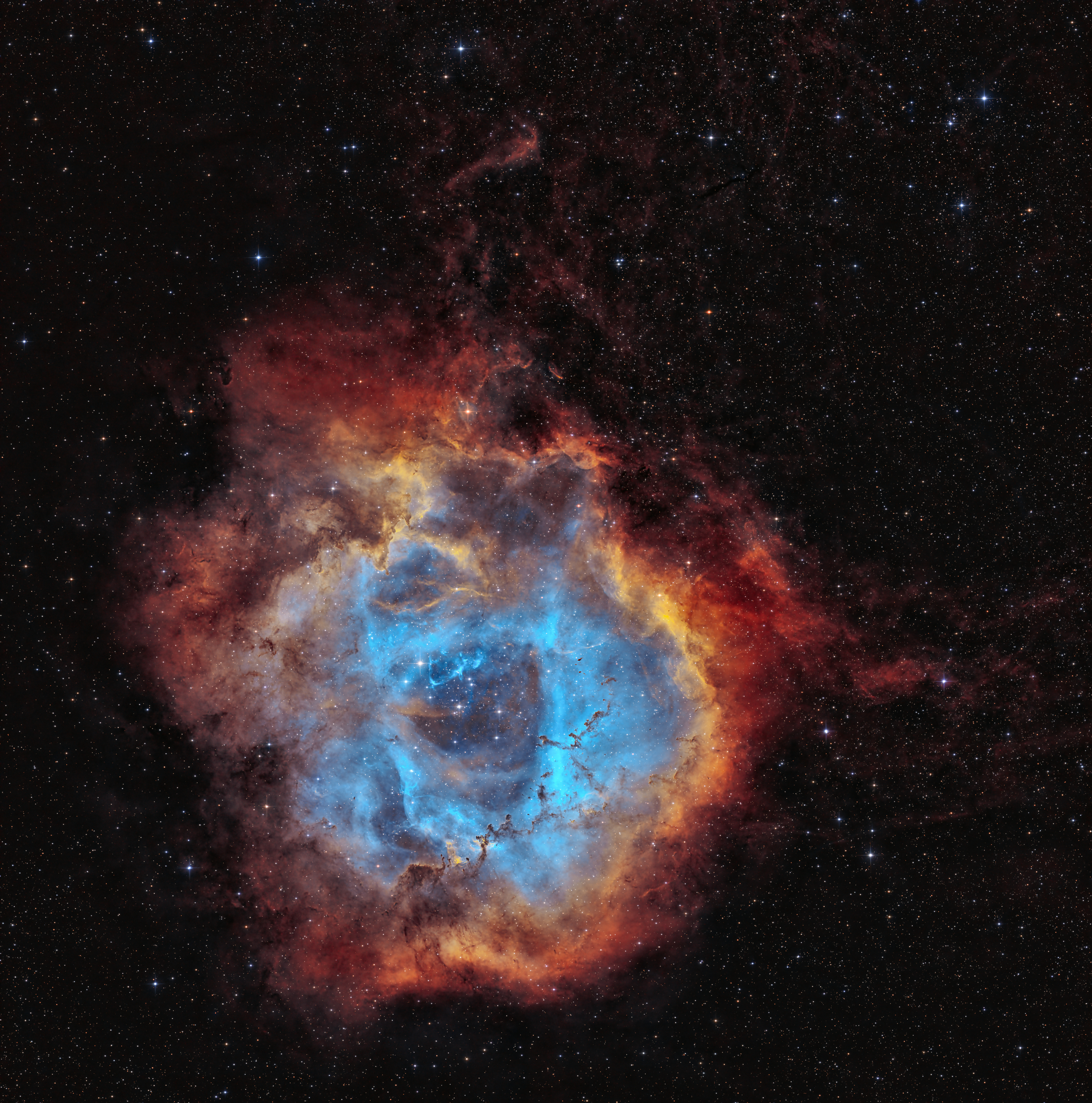

patrice_so 7.87
@Brian Puhl Thanks a lot this are very valuable teachings. I do appreciate a lot.
I uploaded a new version trying;
- to balance the background as you proposed --> I go that
- to reduced the BG to an acceptable level using the "nuke mode" --> here I am still lacking a critera to decide whether it is acceptable or if this if the BG still qualifies as "flat panel lightening up";
- to process stars as you advised, applying in addition Bill Blanshan’s method for star reduction; that is much better than my recent arcsin obsession.
@andrea tasselli Thanks too. I tried to get a less agressive still in general. However, I must confess that I like the quite flashy colours.
I think I do like very much this version at this point. I thank you both very much. Of course, any further thoughts are most welcome. The journey does not stop here. This regarding, I hope to had data during the next nebula season. 18 hours is not bad, but this is 18 hours for six panels, i.e. 3 hours per panel.
Clear skies,
Patrice
Here is massively downsized version. The full version is accessible here : https://www.astrobin.com/wabsb8/C/
