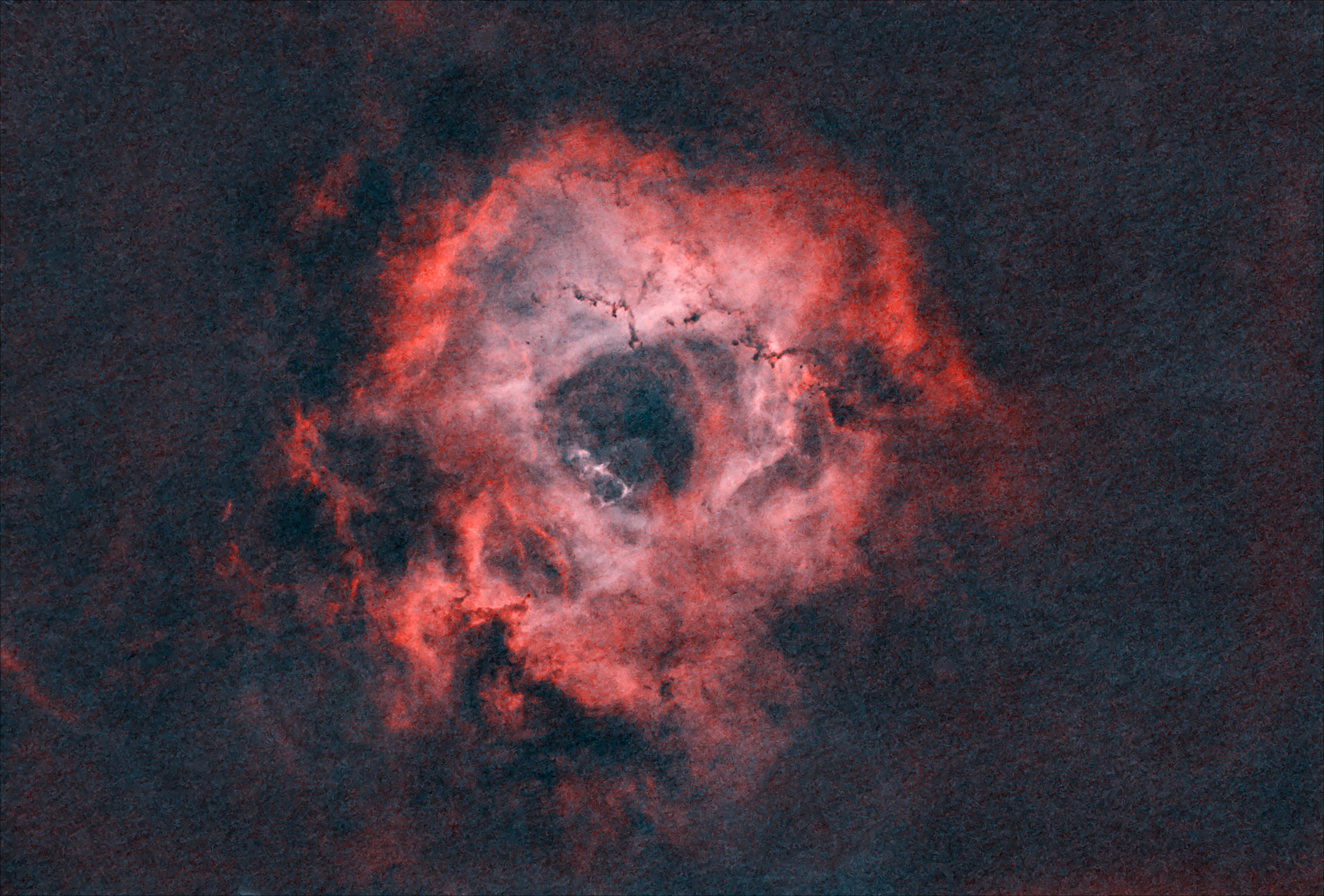

Request you to help critique the processing technique and final output of the image. Posting the starless version as I am particularly concerned that there is a lot of "scratches" or scratchiness in the image especially in the dark areas.
More context about the image:

Request your critique on:
1. Potential cause of the scratchiness and how to remove it
2. Quality of post-processing (curves, saturation, final look, etc)
3. Please feel free to provide any other inputs
Thanks for your feedback and helping me learn more.

JO_FR_94 6.49
My guess on the "scratchiness" is that it is due to the limited integration time you have : just a little bit more than 1 hour of data.
This seems insufficient to reduce the noise that may be due to light pollution in the area from where you take pictures.
You should try to put 5 additional hours into that, and stack with this amount and see if the noise reduce ;-)
By the way, when zooming in the picture, the structure of the noise seems to be linked to the "abuse" of a noise reduction algorithm. But maybe it's compression on the image posted ?
Hope this helps

Rob_24 1.51
Start to dither and your "scratches" will most likely be gone (I assume the darks match your lights). And I would recommend to capture more data and of course do flat correction.
Rob

No worries! At first glance, it seems you have walking noise residuals. The lack of flats makes life harder too... So, if you have more lights and darks, let's hope that at least the walking noise residuals will be suppressed!
It's not a bad start, you just need more exposure time and proper calibration frames.

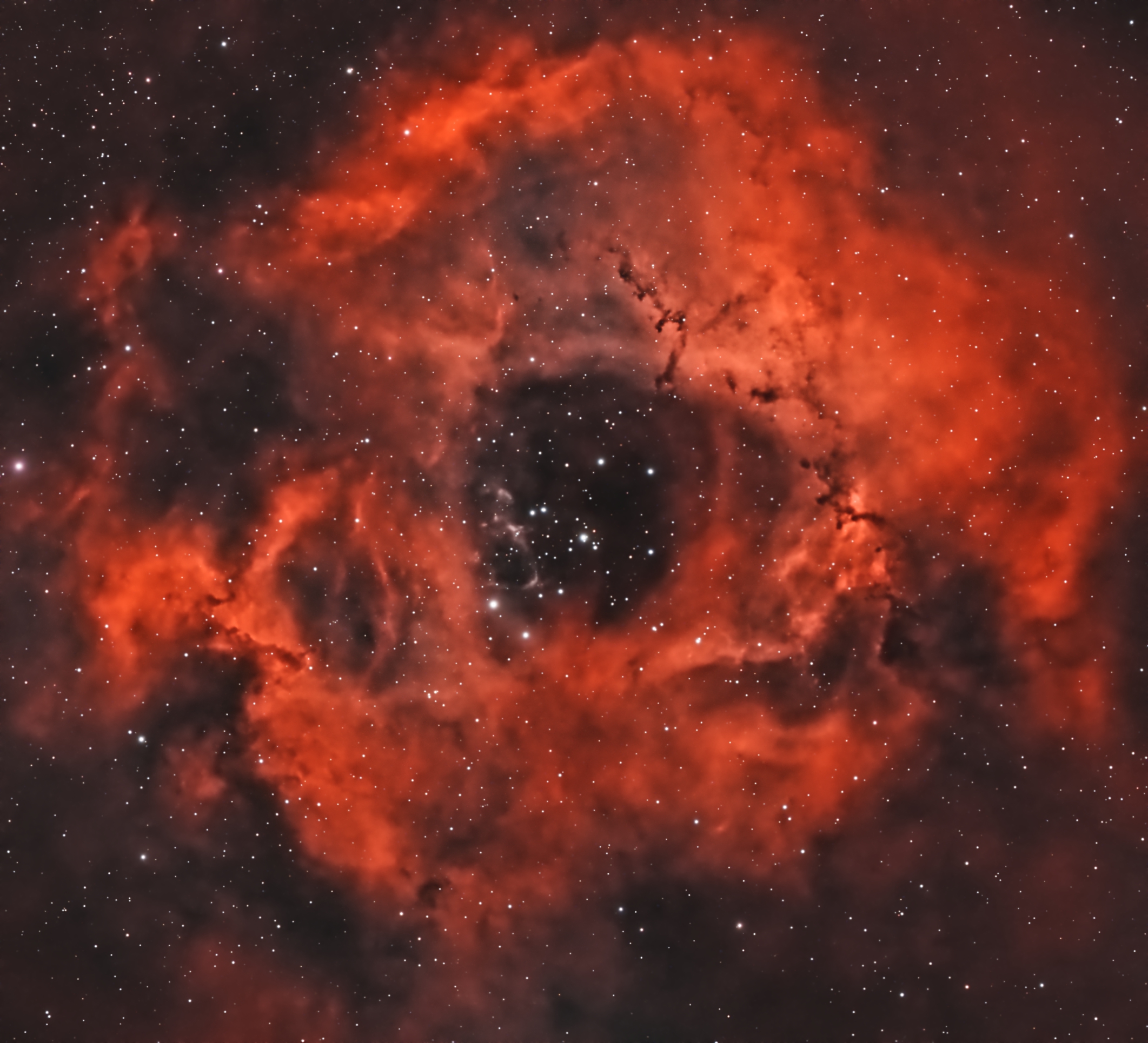

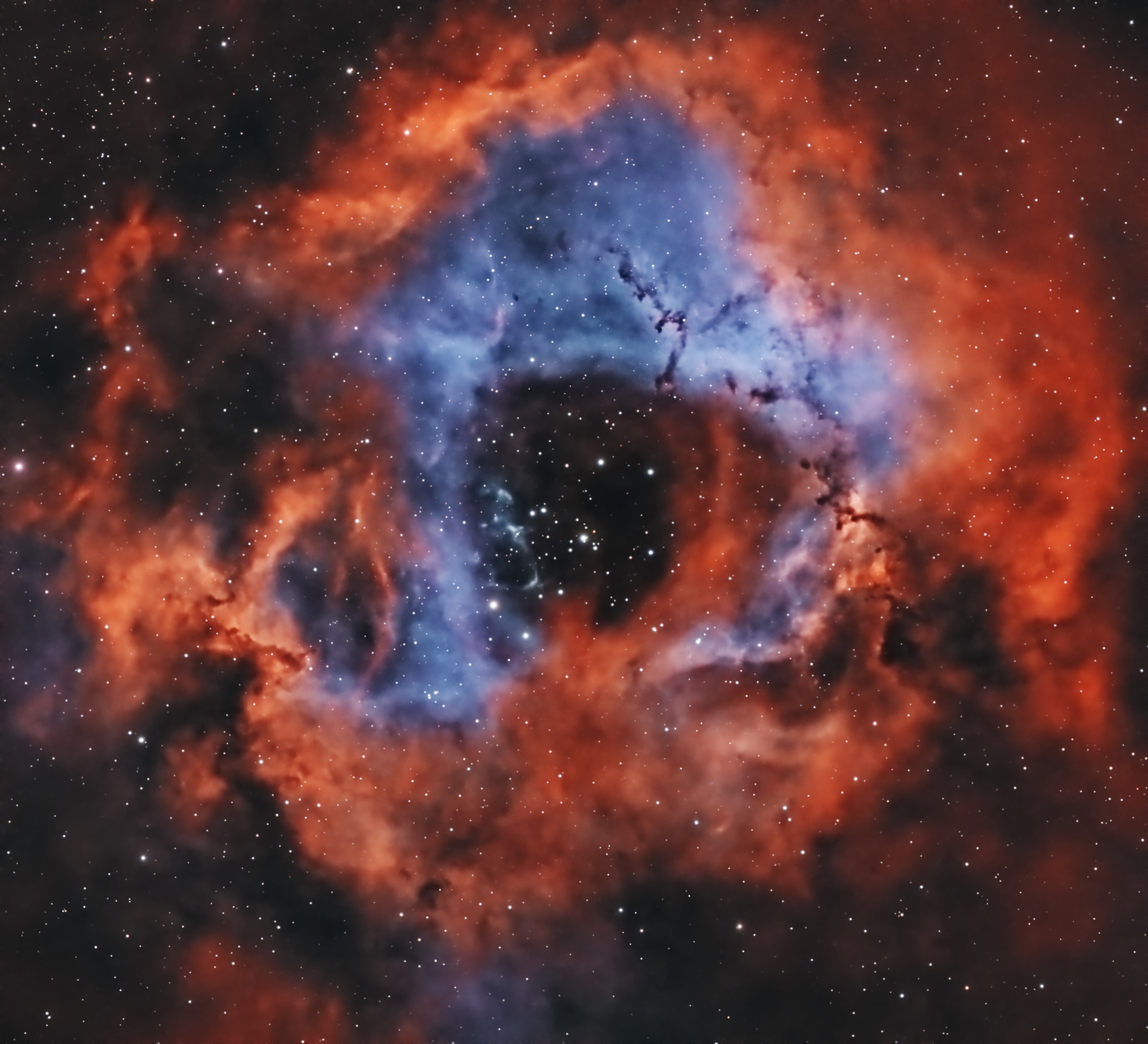

@akshay87kumar  If you're looking to get less noise (scratches), dithering and longer integration times are the best first line of defense. For the current image tho, maybe crop it out so that the brightest parts (less noisy) and flat artifacts are gone. I had a go and deliberately cropped out the two most obvious dust motes + the weird side vignetting. Here's what I got.
akshay87kumar 3.01
@Joon Ren Thanks for editing and sharing the images. I would certainly like to learn more about post-processing techniques - I am amazed to see I have left out so much of detail in my processing!
