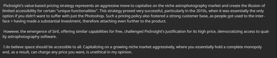

I understand your perspective on this. Astrophotography is indeed an expensive hobby. However, my issue with PixInsight is somewhat ideological.
 PixInsight's value-based pricing strategy represents an aggressive move to capitalize on the niche astrophotography market and create the illusion of limited accessibility for certain "unique functionalities". This strategy proved very successful, particularly in the 2010s, when it was essentially the only option if you didn't want to suffer with just the Photoshop. Such a pricing policy also fostered a strong customer base, as people got used to the interface + having made a substantial investment, therefore attaching even further to the product.
 However, the emergence of Siril, offering similar capabilities for free, challenged PixInsight's justification for its high price, democratizing access to quality astrophotography software.
 I do believe space should be accessible to all. Capitalizing on a growing niche market aggressively, where you essentially hold a complete monopoly and, as a result, can charge any price you want, is unethical in my opinion.

Comparing Pixinsight to Microsoft is also quite a stretch. For my desktop I indeed paid for my windows installation separately. If you buy a laptop it would be included in the price already. Nobody has said that since hardware cost "x amount", then software should cost "y amount". I simply feel that spending a few hundred on software isn't too bad, especially since I've built a rig for a certain amount of money that far exceeds it. I understand how you could take that and make it into another argument, but it's not meant as a comparison. If I count the amount of hourse I've used Pixinsight then the running cost is ridiculously low.
I don't use ChatGPT, and I'm not sure what you mean by entrance price. Are you actually comparing a one month sub for Adobe with a lifetime ownership of a Pixinsight licence? It's not really apples to apples either as it really depends on what kind package you would need from Adobe in terms of apps, storage etc. I'm using Adobe regularly and have a running sub. In a year, that cost me more than I paid for PI, which is a fact, hence my comparison. If you find a free alternative more attractive then be my guest. You also didn't include APP in your comparison, but in stead chose to include MS Paint?
I would have liked you to explain shortly and precisely how Pixinsight and it's creators are restricting your access to space. I would also have liked an explanation as to why my "quote" is irrational to you.
Was it the fact that they provide(d) a service/product that I'm happy with, so much so that I paid for it in order to use it whenever I want. The fact that I provide my employer with my services and in return they pay me the amount of money my services are worth. The fact that transfer of money for exchange of goods/services are normal? Or the fact that you don't need Pixinsight to have access to space?
Maybe I'm misunderstanding you. But you seen set on making Pixinsight seem like a villain and that you are entitled to get whatever you need at no cost, but I honestly don't really get why. I get that people have various experiences whether it's about support, documentation or whatever. It may be perfectly valid, personally I have no bad experiences with them, but that doesn't imply that I think they are wrong. My experience is simply different. And by not agreeing with your statements you act rather harsh because your personal rationale seem to be the only right way to think.
Quite honestly I find part of your posts borderline hateful for simply not agreeing with your views, resorting to low blows when none are needed.
At no point have I written that Pixinsight is the only way or that it is better than anything else, quite the opposite in fact. I've only been disagreeing with three key statements from yourself that can be viewed here:
As always clearly stated; IMO:
1. Pixinsight aren't capitalizing any more than other businesses (Be it remote services, telescope makers, Astrobin itself or anything else astronomy related).
2. Pixinsight aren't monopolizing anything.
3. Pixinsight isn't making space any less accessible to anyone.
If I make decent chairs from wood cut down on my own property and give them away for free, does that mean that Ikea should give their wooden chairs away for free as well?
I don't see a point in keeping the discussion ongoing, I can't see myself agreeing with your somewhat aggressive rationale. Neither would you probably understand my reasoning on the subject. It's probably best we accept our differences and move on from there.
