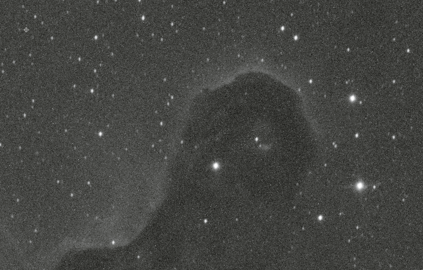

 Last night, during my photo session, I encountered an issue with uniform star elongation across the entire field.It looks something like this:

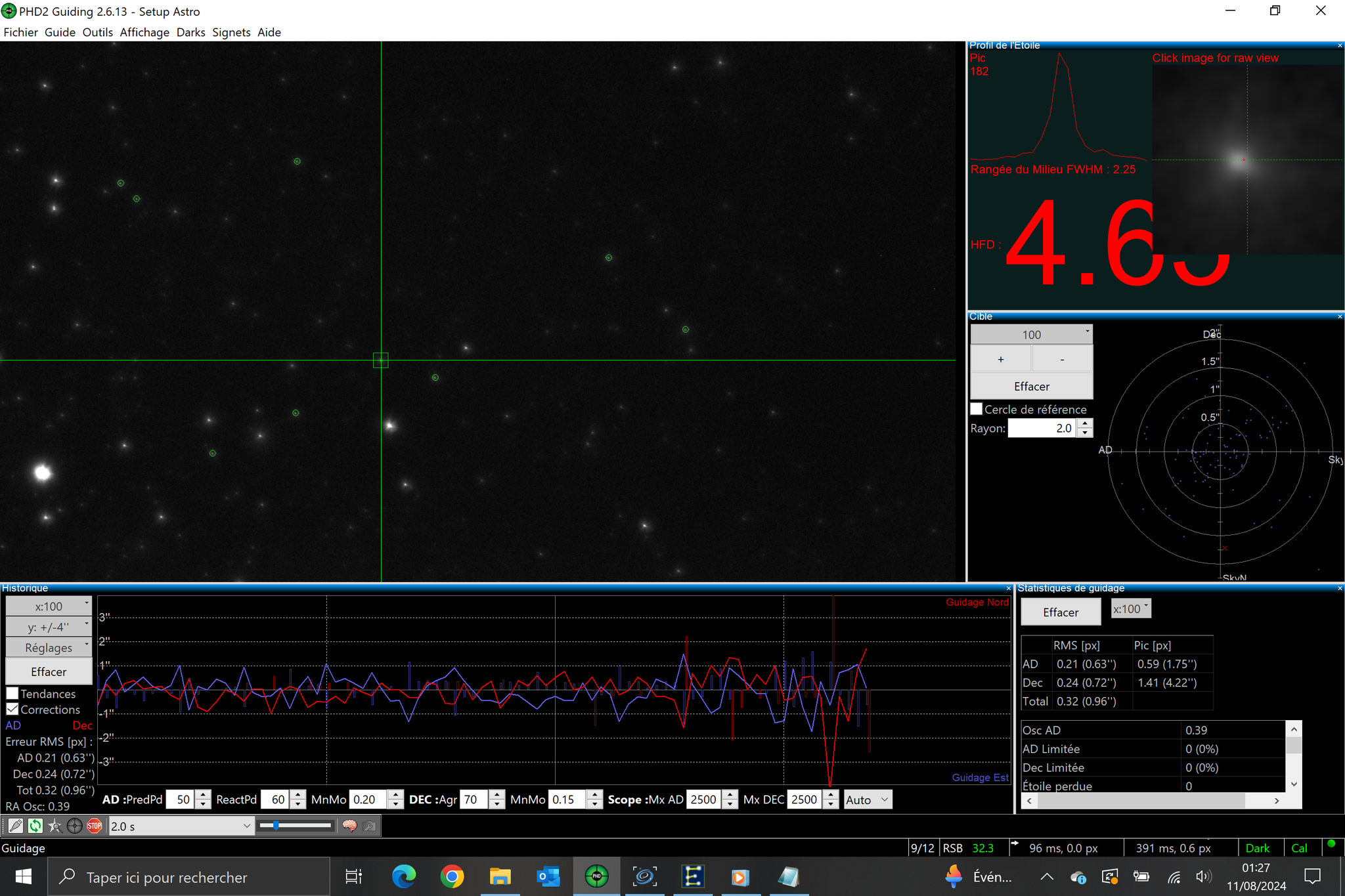

 I believe my guiding is the source of the problem. Here’s a small photo from PHD2:
454022405_1531012690860034_6230634452922780917_n.pngIn my opinion, star elongation like this would result from defective tracking, correct?
The polar alignment is good since it was done with the Polemaster, but nonetheless, if I don't activate the tracking, I see almost immediate drift. Strange, isn’t it?
 Additionally, I realize that the shape of my stars in PHD2 is not good and could be causing these problems.

The trick at this point is to come up with a way to test each one of these possibilities to either confirm or dismiss them as the cause.  Here you’ve said that the PA is good but without tracking turned on, you see immediate drift.  You should stop right there and realize that that means that PA is NOT good!  So…first thing:  Go fix it.  When the PA alignment is correct, you will not get immediate drift.
Next, check your tracking.  If you can’t go unguided for at least 30s - 60s without elongated star images, check your tracking rate.  Is tracking set to the correct sidereal rate?  What does your star tracking system say?  Turn off corrections going to the mount and watch the signal.  Is it oscillating or is is trending smoothly?  You may have a large periodic error and this is one way to detect it.

Looks like wind to me. BlurX will salvage it.
How many sub frames did you take and how many of them show the error. That will tell you a lot right there. It's normal to have a few bad frames which you just to eliminate from your stack. Many things can cause that, guiding error, wind, RA tracking weirdness, unknowingly bumping the mount and so on…

Putting the dec spike you see on the image out of the equation (provided it was not  systematic and thus would not affect every frame) , it seems to me you have decent guiding numbers in PHD2. At least not to correlate your guiding performance to the elongated stars on the image. You might want to check for tube flexure and make sure your guide scope is well fixed to the scope: Check the bolts and see if everything is tied up correctly. It also seems like your stars are not only elongated but a bit egg-shaped: Check your collimation on that regard.
