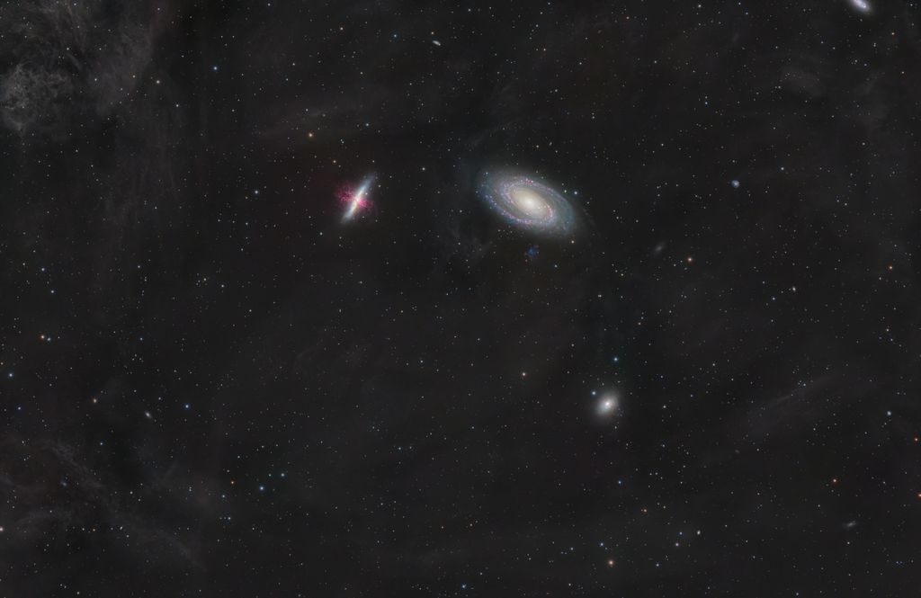

Hello everybody, ive recently finished one of my largest projects yet, a 115h integration of Bodes Galaxy in HaLRGB, and I was looking for some criticism, because sometimes im blind to some problems Ive done in my editing, was looking to get some fresh set of eyes on my image. constructive critique is very welcome, also if you find something that I did well, let me know aswell.
here is the astrobin link aswell
https://app.astrobin.com/u/EnVY?i=7rgtf8
let me know what you think of it!
Claudio
Weird colors, poor stars and overall coarse details. Denoising applied far too heavily may have contributed to the coarseness of the details.
EnVY 2.61
in what way wierd colors? you mean in the galaxy?
Yes, both galaxies and the overall hue of the dust veering toward purple. Stars colors are either pale blue or pale yellow and I'm pretty sure there aren't that many of those spectral kind over there. Star shapes are a bit off.
EnVY 2.61
got it, thanks!

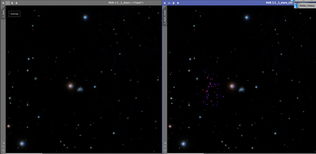

correct only gives me some strange artefacts on the stars, left is before, on the right is after.
im guessing that these are because it was used on a non linear image.
McComiskey 3.01
Yes, blurX only works properly on linear images. The psf, on which it relies, is destroyed by stretching.
My comment is more from a photographic/art point of view. My question for you to think about would be, what's the main subject? Is it the IFN or is it the group of galaxies? I see losts of images like this where people want to include everything they can. Honestly, that bright clump of IFN in the upper left corner is is drawing the eye away from the galaxies resulting in a confused composition. I would consider cropping in on the main group of galaxies and not worry so much about the IFN. Doing that would make a stronger image with more visual impact.

Right after stacking, ideally you don't manipulate the data at all until you're done with those steps:
1- If mono, LinearFit each channel to the statistically brightest (Process -> Statistics for the actual median/average), then ChannelCombine to RGB. If color camera, you're already in RGB.
2- DBE / your favorite background gradient removal tool
3- BXT correct only
4- SPCC
5- BXT sharpening
6- The rest of your workflow
This is the ideal BXT workflow as described by the author. Correct only, SPCC, then sharpen as early as possible. Correcting your stars before SPCC will help SPCC get the right flux from your stars.
P.S.: Your image kick ass overall. You're in the minor details refinement now.
okay so I cropped a bit in because after looking at it with some fresh set of eyes, I definitely agree with you.
also kept the more revision where the dust doesn't steer towards purple that much.

Looking closely at your image there are definitely a few points I'd improve on

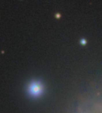

  1. Stars:
  2. Your star shapes and colours are off. The cores seem to be very clipped, and there's a strange cutoff between the core and the outer colour. You've also got some strange colours; for some stars, one half is green and the other half is yellow. Personally, I use a manual STF stretch applied with histogram to get stars that avoid these issues. I believe the screenshot of your image below accurately represents. I have attached an image of my own stars with my Newtonian which I have stretched with STF / Histo

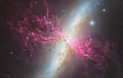

  3. Oversharpening

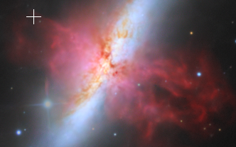

  4. If you take a look at the Ha jet on M82, it's quite clearly over sharpened. I assume you're using something like Blurx or Graxpert Deconvolution. You can tell it's excessive because of the bright blobby structures it seems to take. You should not be pushing your data past what it can handle. Using a good reference image can help you with seeing if you're pushing certain things too far or not. I have provided a comparison between your M82 and my own, which I think effectively highlights the differences.
  5. M81 colours

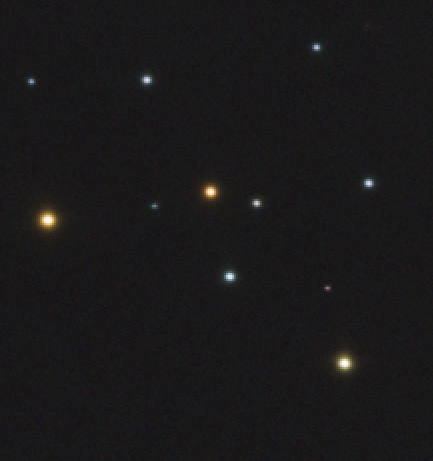

  6. It seems that you've done some specific colour masking to try and bring out the colours of M81, but I do not believe that you have done it well. If you take a close look at the spiral arms in M81, you can clearly see distinct shifts in colours which are not continuous:
    This often comes from improperly saturating your image. I agree that the colours on M81 can be quite hard to get right. A method I like to use which seems to work quite well for me is to use blurred colour masks. Applying a Gaussian blur to your initial colour mask will make the transition much smoother. In addition to this, use a good reference image to see what type of colour the core and spiral should look like.
    For the rest, I think that the IFN was brought out well and it's not overstretched.
    Hope this advice helps,
    Flavio
